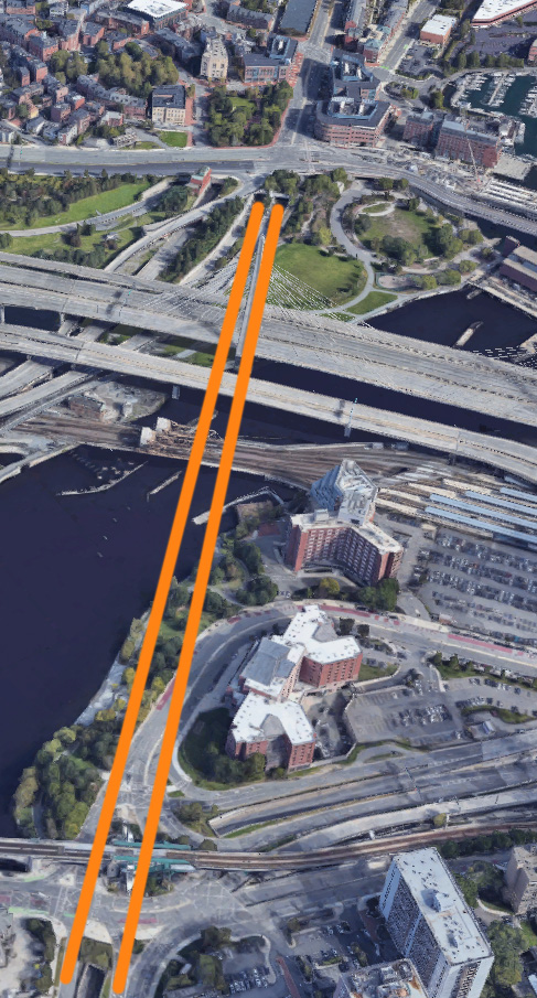

I can't help but think that we got most of this in what was actually built -- though the Zakim looks way cooler. I was also wondering why we didn't send a lane of Route 1 straight into a tunnel to Storrow Drive instead of (onto a high loop and a long ass double-back ramp. It could have gone under the rail, under that section of Cambridge, under The Charles, and under Leverett Circle.
For the same reason the whole thing wasn't in a tunnel: the Orange Line is in the way.
Thanks. The first photo is one I personally took of the Big Dig scale model that was in a MassDOT office in the South Station building in the late 1980/early 90s. The second photo is a scan from the Big Dig newsletter I used to get during that time period. There is virtually nothing on line anymore that illustrates Scheme Z.
Regarding the orange route you show, there was one design option explored that would have had a northbound-only tunnel in the location you drew, but was dropped due to expense.
