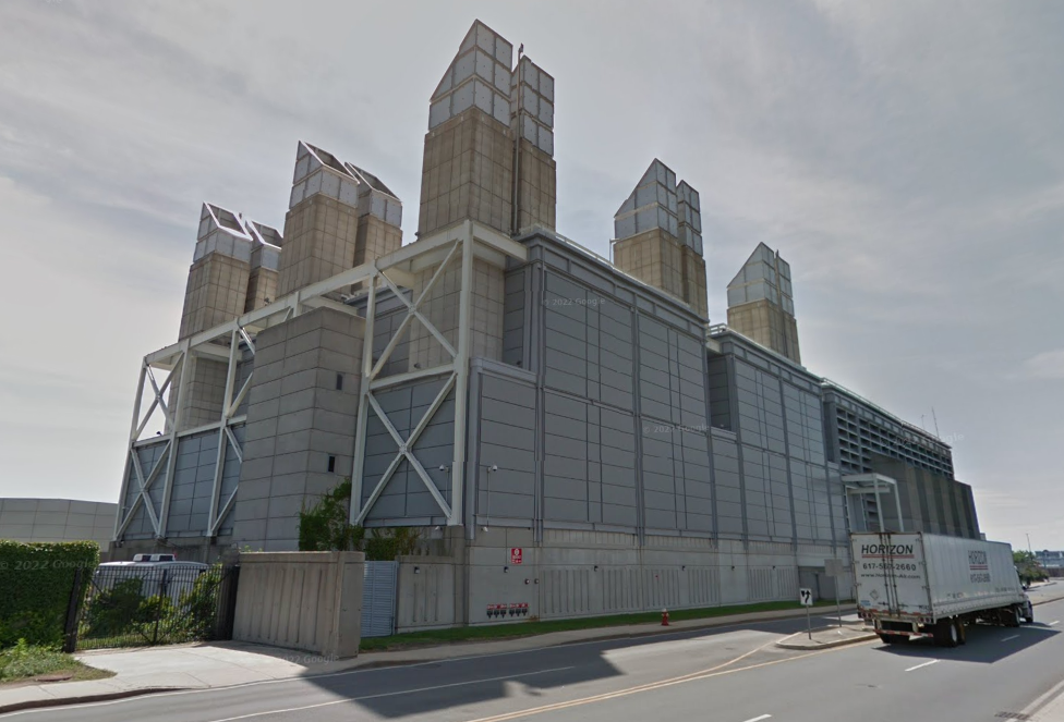

Why does the rear of the building (the part that faces the highway ) have those things that look like large doors and the rail coming out of the top, right in the middle?
This is a guess, but maybe for moving/installing equipment.
Vent Building 7 has something similar (not my photo, unfortunately):
My guess is that there is a very big fan behind that door that they want to be able to swap out “whole” & quickly at the end of its service life, and that you’ll find a similar door in a similar place on most or all built at the same time.
Specifically, thats a craneway known as a "monorail door." Monorail in this case is a specific type of overhead crane - most industrial overhead cranes, bridge and girder, facilitate full translational movement in 2 dimensions, X and Y with the hoist lift representing Z. Monorail cranes don't have that XY freedom - they're only useful for lifting in the vertical axis along it's track, but they work along the same basic principles as a transit monorail, complete with switches, crossovers and turntables. A major benefit is that the track can curve, and can support multiple trolleys. They're not the strongest, but ideal for mid-weight repetitive motions, like moving something along an assembly line.
Here I would agree that it's definitely for equipment replacement and repair - I would bet that rail runs above each major replaceable item / access point to allow an integrated hoist to lift and stage them to/from a location where a road mobile crane/truck can reach.

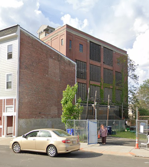

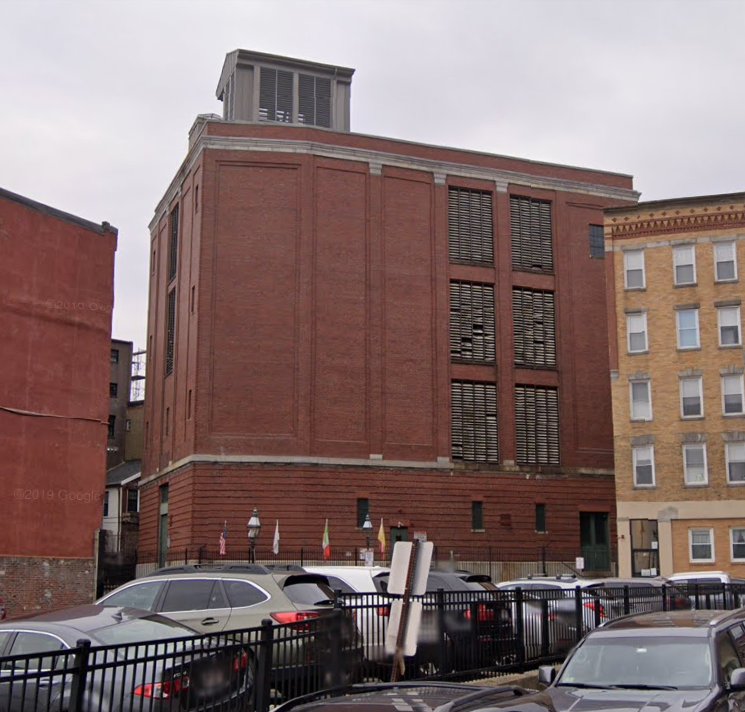

While there's an active thread about vent building design, can I ask a related question that I assume has the mundane answer "it was moderately cheaper to do it this way":
Why was virtually no effort made, with the exception of CAT Vent Tower 6, to integrate the design of these stacks into the existing street grids? I understand that some equipment has to be aligned with the tunnel geometry, but thinking of the one across from the BCEC in particular, it seems like the actual building housing the equipment could have been integrated better into the city to create fewer headaches going forward. Similar issues exist for the older Callahan/Sumner towers in the North End and Eastie, which are decorated in lovely brick and with nonzero architectural touches, but then splayed at odd angles to other property.
There was a post about them a couple of months ago in the General infrastructure thread, and while I can't answer the question about the alignment generally, at least 2 others were aligned to the street and hidden by other construction - Vent 3 in the intercontinental and 4 by the Public Market and Haymarket Headhouse/Garage. The one by BCEC though? I'm not sure how you could align that one much better being as it is completely hemmed in by roadways. Maybe if the adjacent parcel gets an air rights deal?

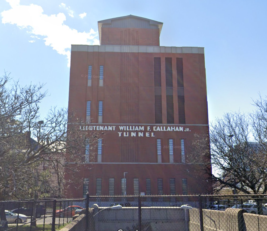

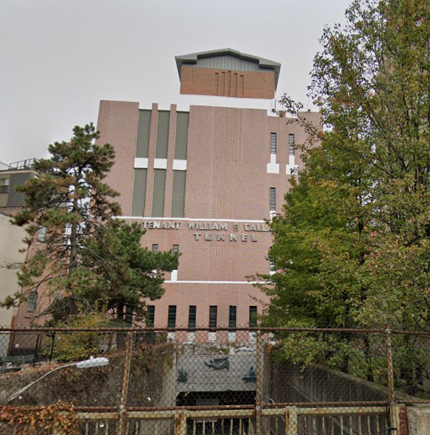

As to the Callahan and Sumner ones though, you're not wrong that they're really obviously askew, but I would probably just chalk that up to the era in which they were built and the relative simple structural considerations of aligning it with the tunnel. Edit: looking at Google maps, it looks like they vent through the faces of those buildings and not the top. If that was a technology limitation of the 1930s, in that case I can totally see why they aren't aligned - a party wall simply wouldn't work, and a askew orientation probably provides better airflow.

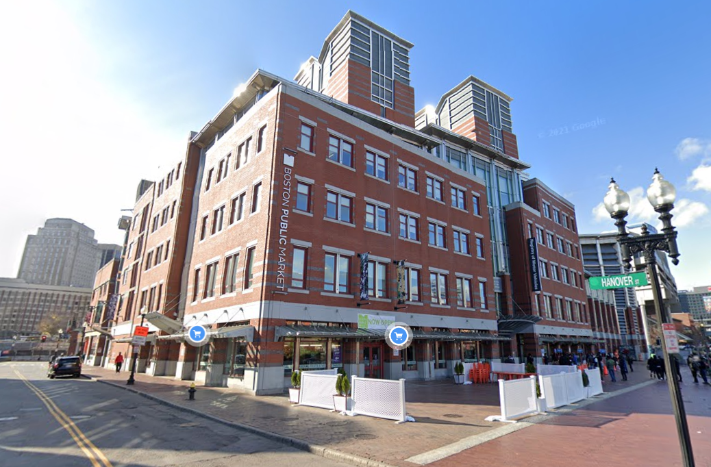

Ventilation Building 4 is at Haymarket Square and serves the Central Artery. The structure includes a parking garage, the RMV, the Boston Public Market, and the south headhouse of Haymarket station. Unlike Building 3, the vent stacks are clearly visible.

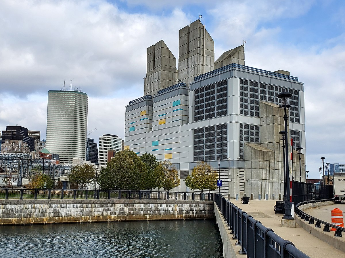

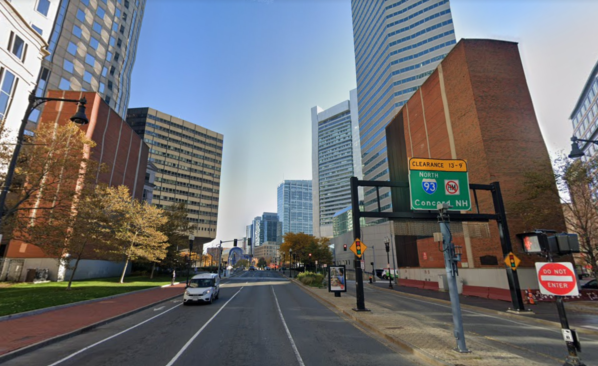

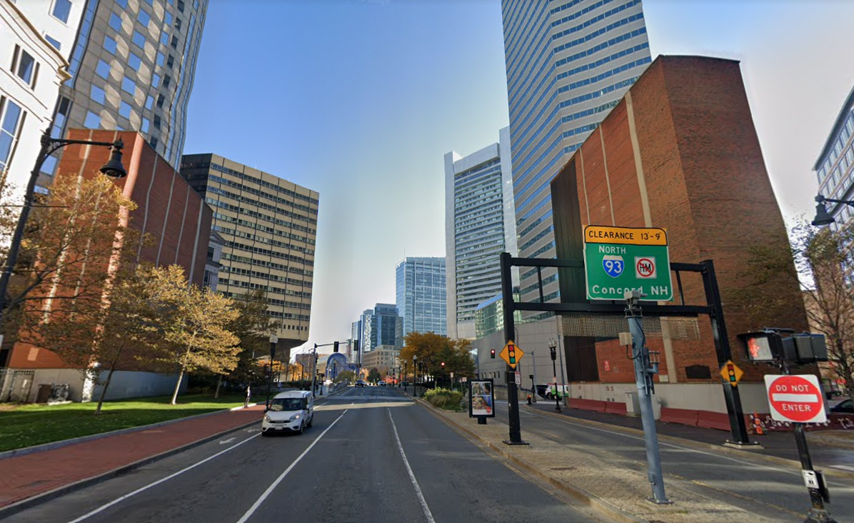

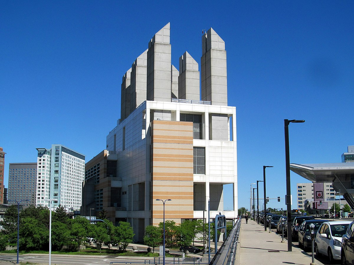

Ventilation Building 5 is on Summer Street opposite the BCEC, at the east end of the Fort Point Channel Tunnel.

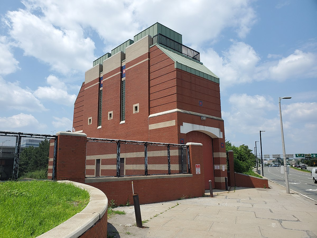

Ventilation Building 6 is on Fid Kennedy Way at the south end of the Ted Williams Tunnel.

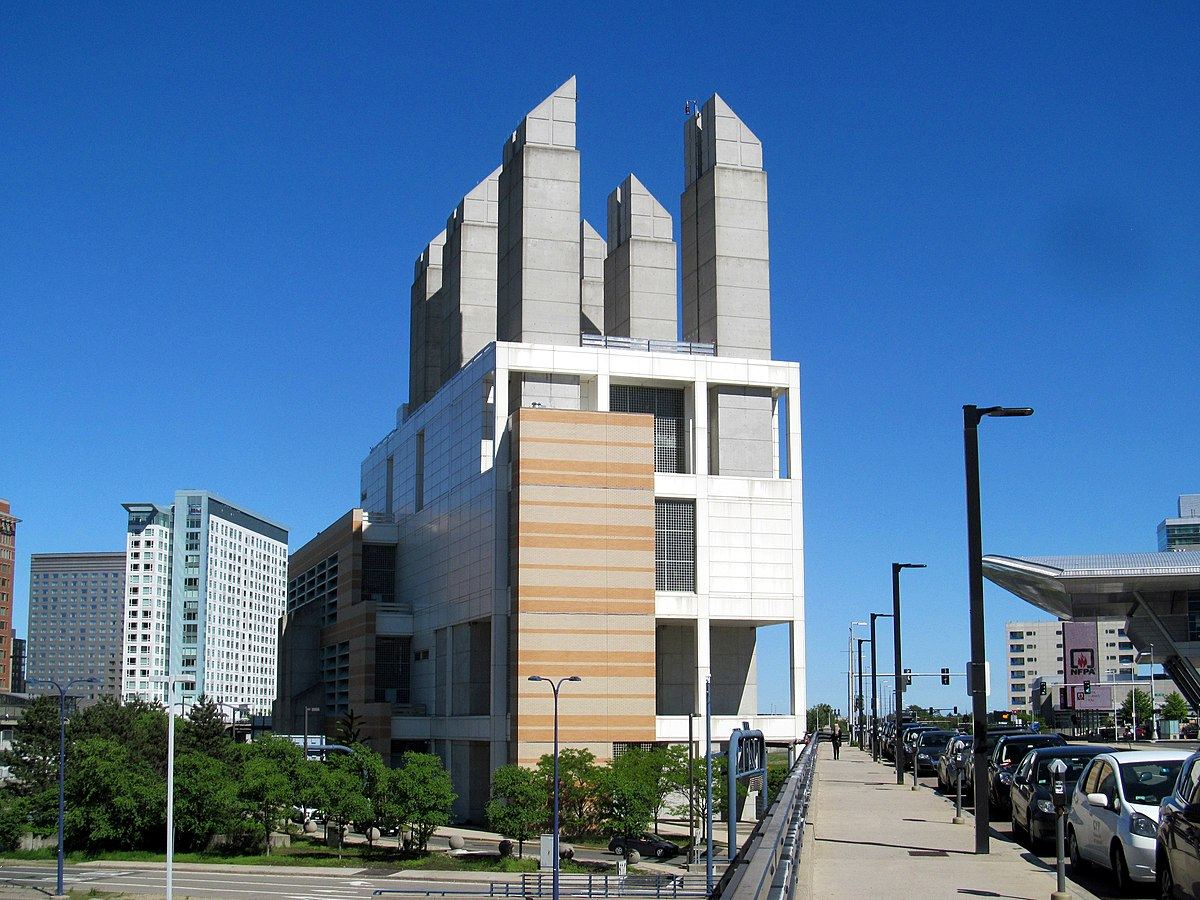

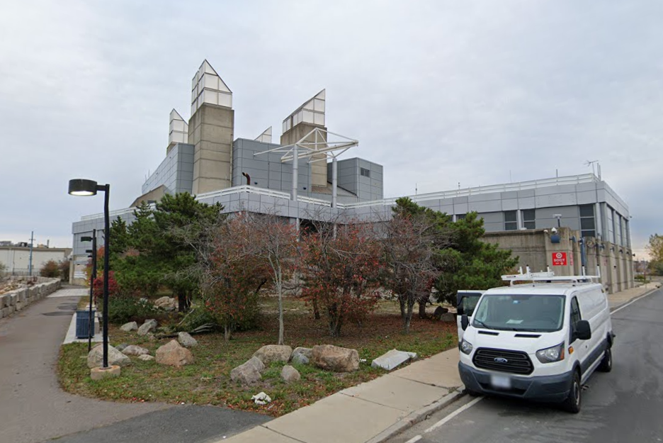

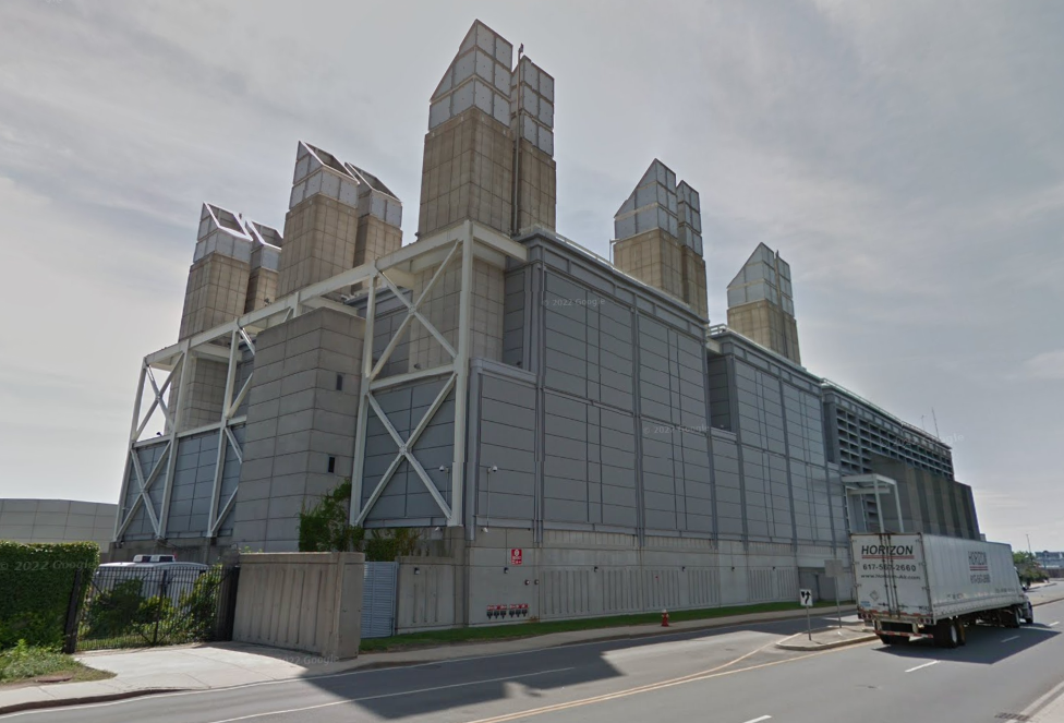

Ventilation Building 7 is on Harborside Drive at the north end of the Ted. It's the largest of these large structures - 380 feet long and 140 wide - and won a couple of design awards.

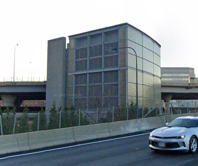

Ventilation Building 8 is tucked between the North Station platforms, the Leverett Circle Connector bridge, and the Zakim bridge and a southbound onramp.

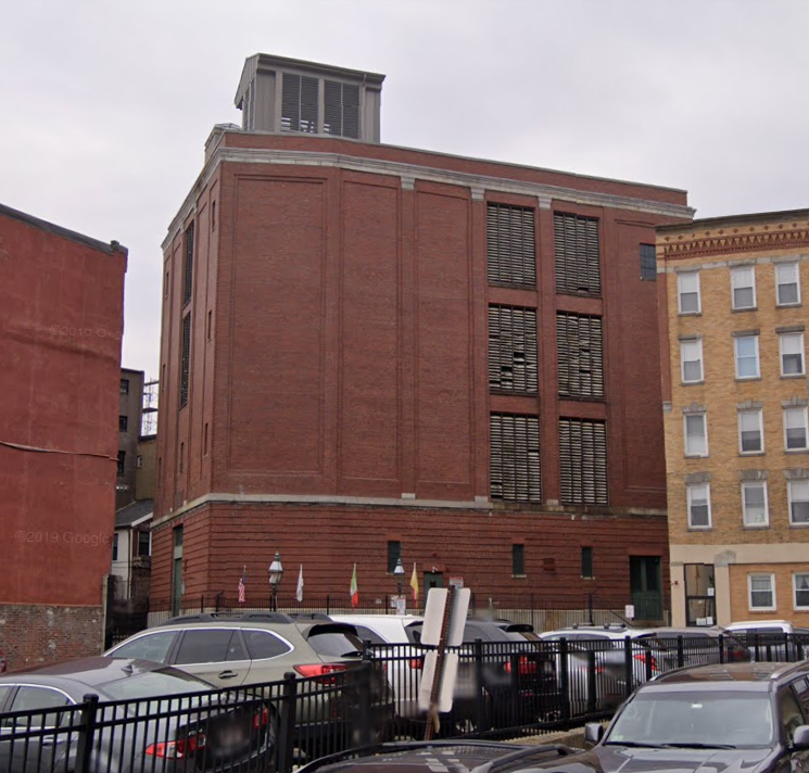

Ventilation Building 10[url] is on North Street near the Boston end of the Sumner Tunnel.
Its twin, [url=https://www.google.com/maps/@42.3716348,-71.0411389,80m/data=!3m1!1e3]Ventilation Building 11, is on Liverpool Street in East Boston. (Liverpool Street, like several nearby streets, is named for the port city its docks once served ships to.)

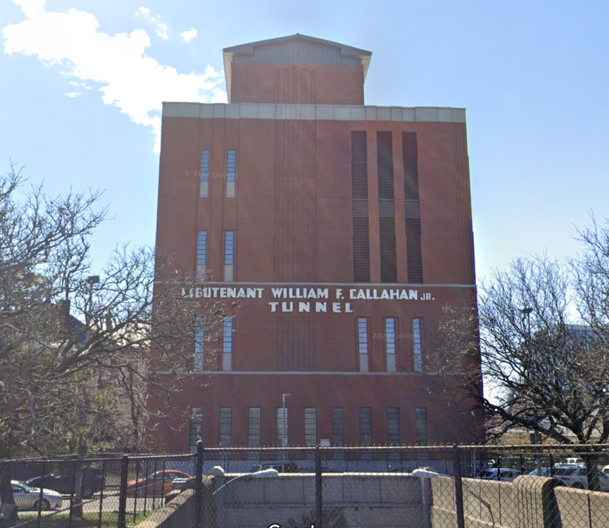

Ventilation Building 12 is at North Street over the Boston portal of the Callahan Tunnel.

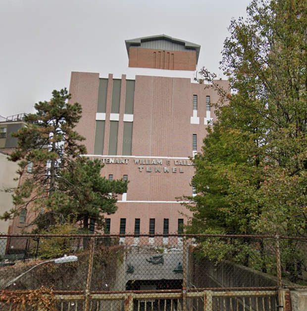

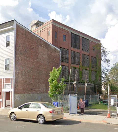

Its twin, Ventilation Building 13, is on Decatur Street in East Boston.

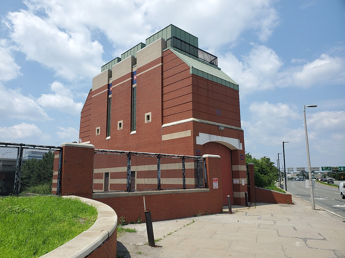

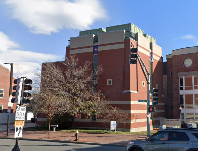

Ventilation Building 15, at the corner of Warren and Chelsea, is designed to fit in with the nearby brick buildings.

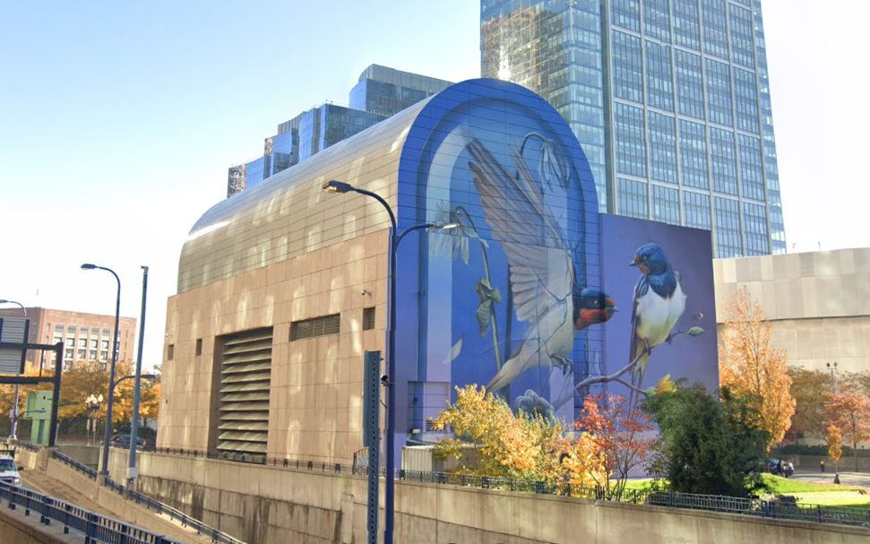

The Dewey Square Air Intake is well known on this forum for the murals it hosts.

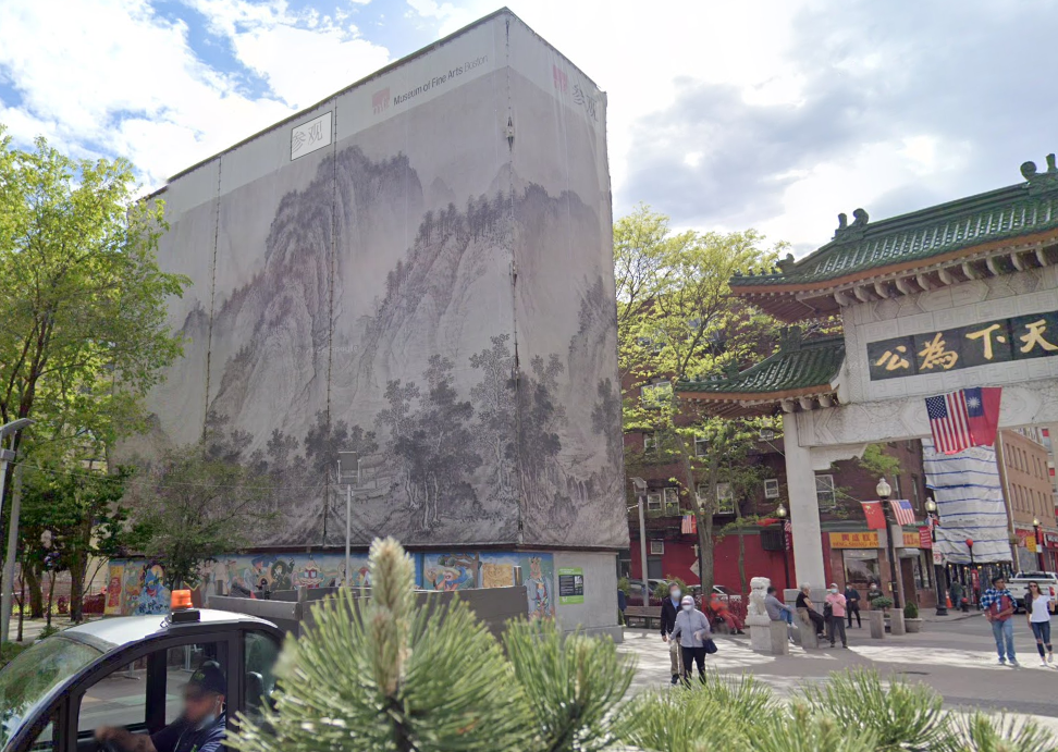

Three fan chambers date to the 1950s construction of the Dewey Square Tunnel; a fourth was located in Dewey Square until the Big Dig. The Essex Street Fan Chamber and Summer Street Fan Chamber flank Surface Road between their namesake streets,

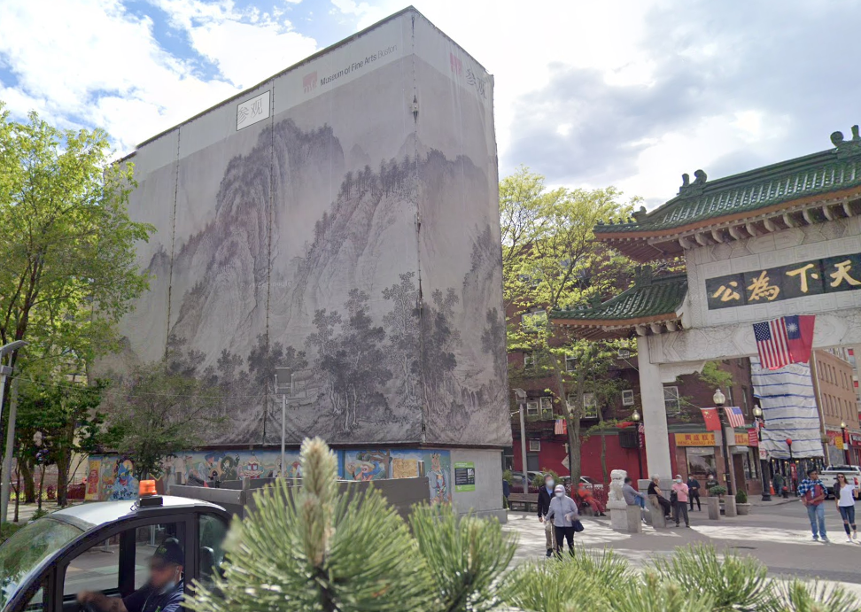

The Beach Street Fan Chamber is adjacent to Chinatown Gate. It was wrapped with this artwork about a decade ago.
