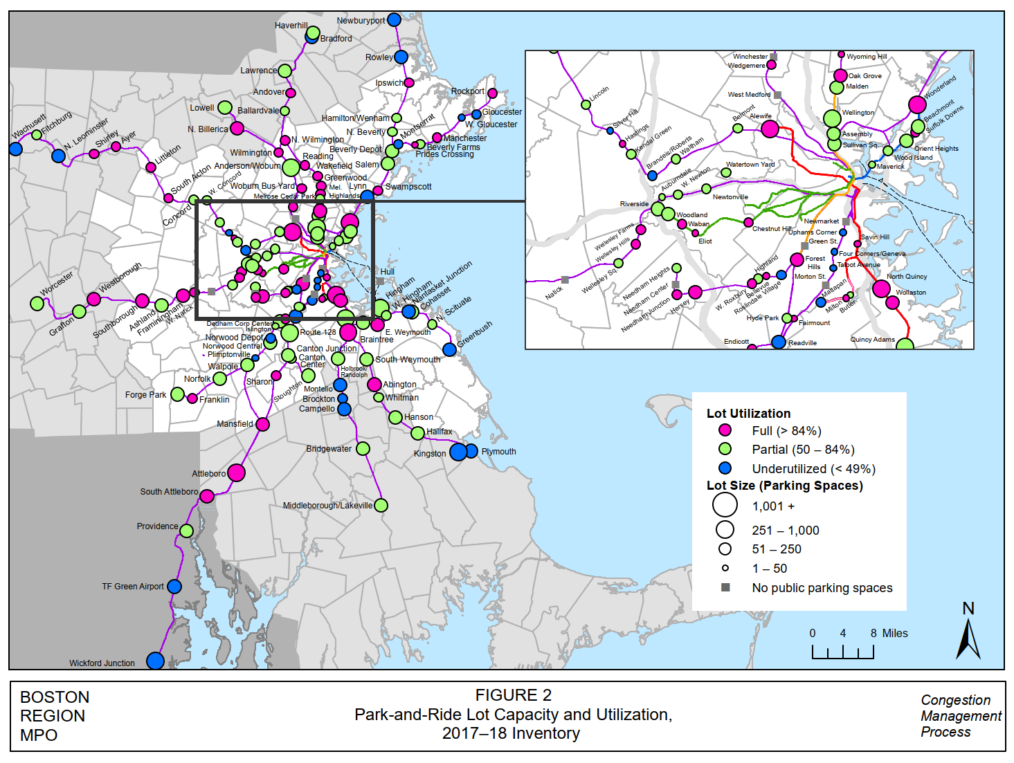

Finally, there's this:
Parking utilization on the MBTA is totally scattershot, with little rhyme or reason across the system to which lots do well vs. which lots do poorly. For as many well-utilized lots there are, there are just as many that are treading water or whiffing badly. Including a disparity at the lots that intersect 128 and 495. If we can't deep dive into the metrics to refine some guiding principles as to where and how to build...or NOT build...parking capacity effectively, it doesn't make a lot of sense to lean into a paradigm of MORE suburban parking because the whiff rate is just going to be too intrinsically high. A map like ^this^ shows that for decades we've basically just been heaving darts wildly at the board rather than following any kind of time-tested best practices at siting and sizing our parking capacity.
