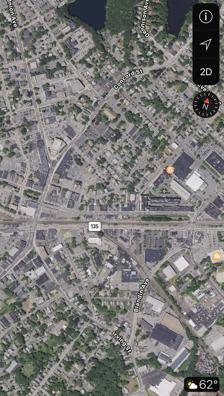

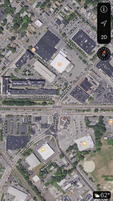

Framingham has a pretty big issue of 2 at grade crossings through downtown that is a really hard situation to find a solution to. Lots of people have tried to find a good solution, but they never do. I was wondering what ideas people could come up with that could fix or improve this situation. The at grade crossings make traffic downtown a mess and if higher frequency trains are ever going to happen it will only get much worse. Really all that theyve come up with is to sink 135 under 126, which does next to nothing. They dont want to sink or build a bridge for 126 over the tracks because it will cut downtown in half. Sinking the whole train line below grade isnt even an option monetarily and service would be probably cut off for a while. What are some ideas people can think of?
Rt 126 crossing downtown
Bishop st crossing east of 126
Both grade crossingsand from outer view of downtown

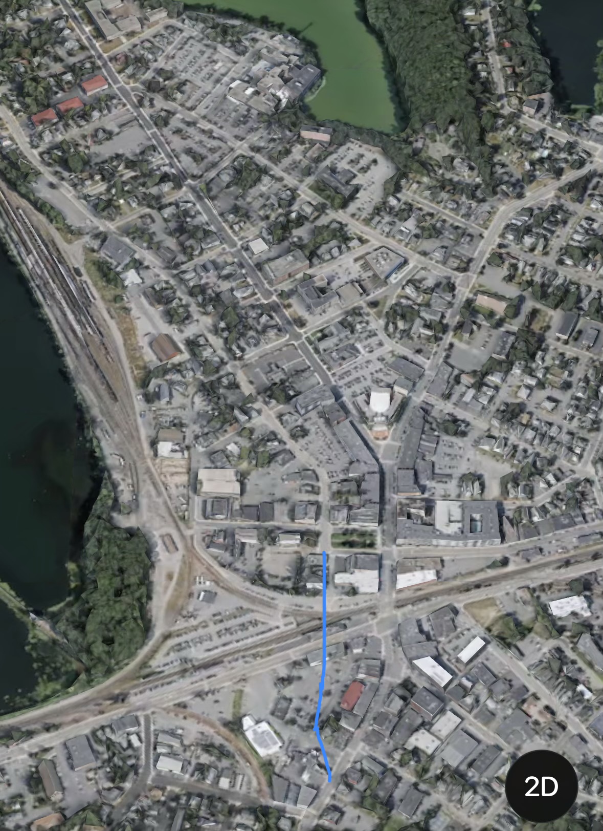

I think at the bare minimum extending Franklin st straight down to 135 would at least help with some of the congestion because its the second main road that goes downtown, but it merges to 126 and only 1 road connects the north and south sides through the main downtown corridor. It would allow Franklin st to have its own crossing. This solves nothing as far as grade crossings, actually adding one, but should help congestion.

Yea thats why I think just extending Franklin street is the best option as far as addressing traffic the easiest way, although unlikely. Does nothing for at grade crossings, actually adding one, but without some EXTREME money/engineering nothing can be done. So I think thats really the only option, besides them sinking 135 which also doesnt address the grade crossing, but does address traffic.

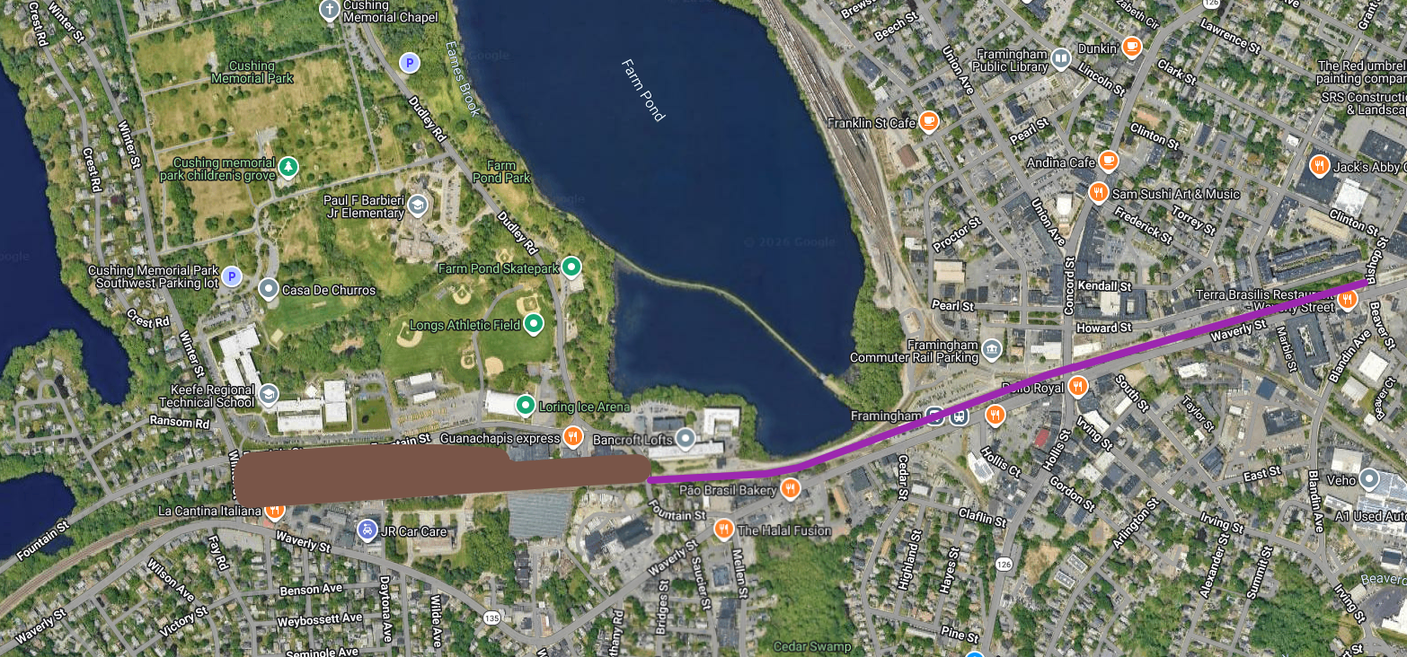

This is what Natick Center looked like in 1877 pre-trench:
Difference here, of course, is that the Saxonville Branch (abandoned 2005) was a Boston & Albany branchline under same corporate roof.
I have no idea what plans might have been for separating Framingham, because they never got that far on an agreement to a plan. Given how the junction is inconveniently centered on the crossroads, the most logical thing would've been to shift the two NYNH&H lines so they both merged together south of downtown just like their separate lines to Fitchburg and Lowell merged north of downtown past Route 9. Then have the reworked merger line pass perpendicular over present-day 126 (where it bends SW after the fork w/ Irving St.), present-day 135, and the B&A...then fashion some sort of wye configuration out of it. That would free up the B&A for 126/Bishop separation by decoupling it from the Framingham Secondary interface.
But you get the picture...the time to strike for that kind of line relocation would've been when there were still farms on the street grid east of 126 near Waushakum Pond. And that ship sailed about a century ago. Plus, NYNH&H doesn't exactly have top motivation to do all the work here when these are light-patronage passenger lines and they're just running heavy freight all day to/from South Boston and the interchanges with Boston & Albany here and and Boston & Maine in Fitchburg & Lowell.
