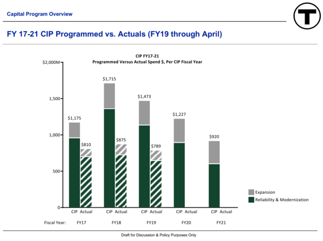

We have the money, the MBTA just isn't able to spend it fast enough. FY18 they spent half their allotted capital investments.
