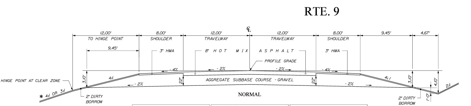

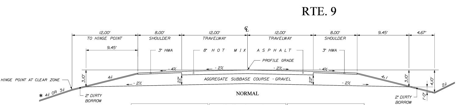

Update: I found the MDOT page with the contract details.... enjoy! (Possibly needs Chrome to open, I had trouble with Firefox.)
Right at the start of the 900 page pdf of plans. A single 12' wide travelway in each direction with an 8' shoulder (and presumably just a yellow stripe down the center)
This is labeled as Route 9 — was there a page showing I-395?
Not that I saw. None of the cross-sections that I saw looked anywhere near Interstate standard. But I wasn't looking for Interstate-standard things.
Why do you ask? My belief is that the new road is being called Route 9 in the drawings (not that they were somehow re-depicting existing conditions on Route 9 nearby)
I believe what's going to happen is that the I-395 designation will still end at US 1A, and the road will drop to two lanes from there. Looking closely, the new road ends at an intersection with Route 9 Business, a designation that doesn't currently exist. So I'm thinking that Route 9 will be rerouted over the new road and continue onto a concurrency with 395 across the river to the Main St. / US 1A exit where it will rejoin its current route to Hampden, and the current 9 will become 9 Business from that intersection to Eddington.
