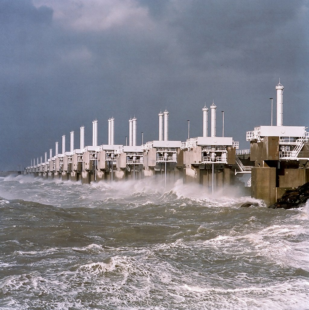

I think the second access point concept has two rationales (and yes it costs $$$):
1) Backup access to the harbor -- flood gates do jam up -- particularly the way we maintain things in the US.
2) Tidal flushing -- may need more of the barrier open in non-flood conditions to keep the harbor flushed out.
