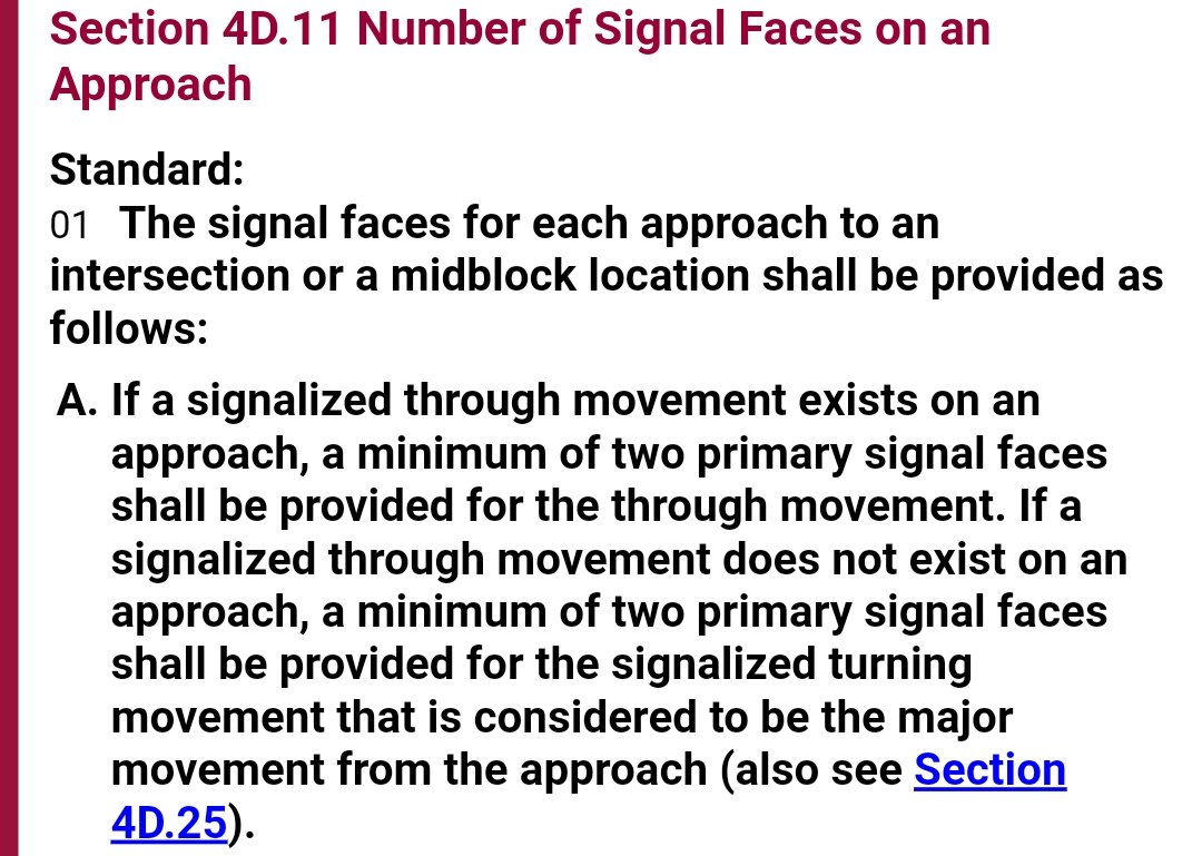

Thought 2: why is it ever a good thing to have more signals than traffic lanes?
maybe for visibility and redundancy above a single lane on a curve, have two signals?
But on Pleasant Street @ Mass Ave in Arlington there are three lanes: left turn, right turn and straight—yet there are four signals (two above the straight lane). How is this good?

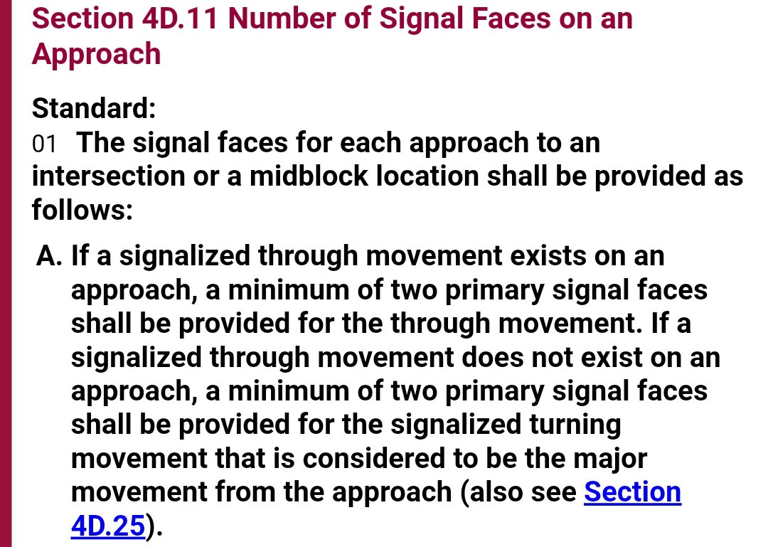

Very simple answer actually! The MUTCD (Manual on Uniform Traffic Control Devices) requires that all approaches have two signals for the primary movement for redundancy, regardless of number of lanes. While the MUTCD is not law, most traffic engineers treat it as such. It made more sense in the era of incandescent signals, total failure in LED signal heads is much more rare.
The MUTCD is the governing guidance for signal design in this country, save for state amendments. Not adhering to the MUTCD leaves a designer completely liable for anything that might happen as a result of the signal design.
Furthermore, the use of two signal heads to serves as a de-facto designation for the primary movement through a signalized intersection.
While the MUTCD does require two, most states do a far side and near side signal for the redundancy. Putting them side by side is pretty dumb. Theres a mediuma cross the street where they could have put the second signal, or they could have combined it with the turn signal that is posted on the far side.
