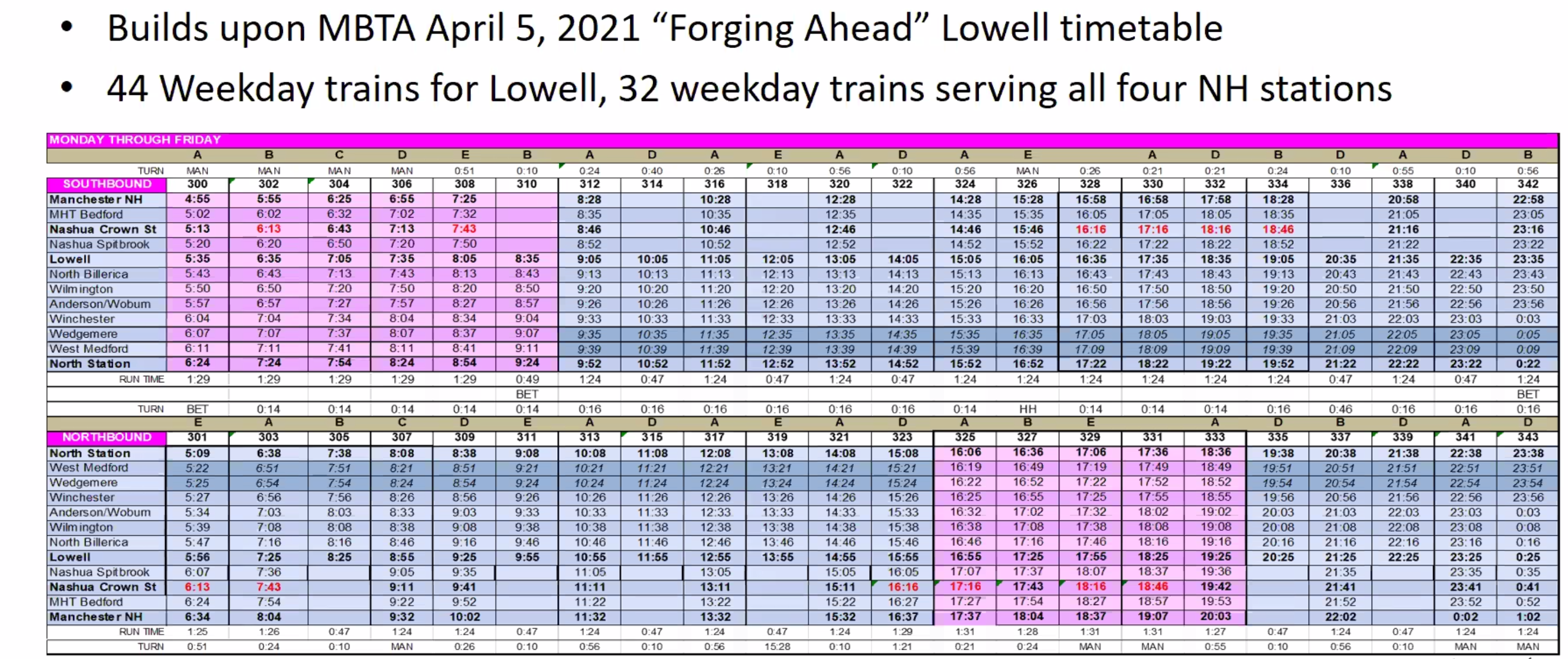

Lastly, here is the proposed schedule.

I noticed that the timetable above implies a Manchester terminus. Is Concord out-of-scope for this project?
If so, as proposed on the timetable above, the line would have 11 stops over 55 miles. One stop per five miles is not unusually close together for a line of this length.
For comparison, the Fitchburg Line doesn't currently have any express trains on any day of the week. At 54 miles, the Fitchburg Line has 16 stops, good for one every 3.4 miles!
The New Haven Line (on which Stamford is mentioned above in parallel with Lowell) is 74 track miles. This is comparable to a Concord, NH extension which would come in at 73 miles.
I am not advocating for or against express trains, just putting the situation in context.
Manchester will be the terminus of the project, at least for now. IIRC the terminus of the project was scaled back from Concord to Manchester in ~2013, but I'm not completely certain about that so take it with a grain of salt.
I'm hopeful for an extension to Concord (with a potential intermediate station in Hooksett) sometime not too long after service to Manchester begins, but as of right now it's not part of the project.
