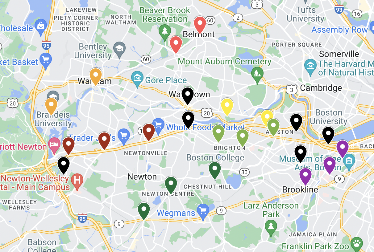

I feel like we're stepping into the alignment too early here. I'm going to basically restart, assuming BL is extended to Kenmore under the Esplanade and go from there. Here's my fairly exhaustive list of possible destinations we'd possibly want to connect that are west(ish) of Kenmore:
I've tried to color code them based on which ones make sense to serve together, (Black can serve multiple), but it's very much not perfect. I think there are 3 clear segments of any route:
The Western Segment
This segment basically involves stringing together whatever destinations around Allston/Brookline you think are most important. You could follow the D branch to hit Fenway, LMA, and Brookline Village, or you could swap BV out for Coolidge Corner. Maybe you're feeling a more BU/West Station routing, that works too. I'd personally pick Fenway-LMA-CC or BU-West Station, but there is plenty of room for other options. For the most part these can be combined with any of the other
The Central Segment
This is where things diverge pretty wildly. I think these are the main possible routes:
And here are some possibilities to cap the line off
So what could be some final routes?
- BU
- Fenway
- West Station
- LMA
- Coolidge Corner
- Boston Landing
- Union Sq (Allston), I unilaterally renamed it to Hester Sq after Rita Hester to avoid confusion with the Cambridge Union Sq and I'll be using this name going forward.
- Brighton Center
- Oak Sq
- BC
- Newton Corner
- Newton Centre
- Newton Highlands
- Brookline Village
- Newtonville
- West Newton
- Auburndale
- Watertown Sq
- Watertown Arsenal
- Waverly
- Belmont Center
- Waltham Center
- Brandeis University
- Riverside
The Western Segment
The Central Segment
- The Watertown Route: From West Station or Coolidge Corner, hit either Boston Landing or Hester Sq before going under the Charles to serve the Arsenal and either Watertown Sq or Newton Corner
- The 57: From West Station or Coolidge Corner, hit either Hester sq or Boston Landing, Brighton Center, and Newton Corner
- The D Branch: From Coolidge Corner or Brookline Village (roughly) follow the D branch to BC, Newton Centre, and Newton Highlands
- The Hybrid: From West Station hit either Hester Sq/Boston Landing, Brighton Center, BC, Newton Centre, and Newton Highlands
- The I-90: From Newton Corner run along I-90 to hit Newtonville, West Newton, Auburndale, and then terminate at Riverside.
- The D Branch (Continued): From Newton Highlands run to Riverside
- The Fitchburg Line: From Watertown Sq run to Waltham and Brandeis/Roberts
- The Northern Hook: From Watertown Sq run to Waverley and/or Belmont Center
- The full D: Pretty much just the D Branch replacement, maybe with a couple modifications like a relocated Fenway and BC diversion, ends at Riverside
- The partial D: West Station-Hester Sq-Brighton Center-BC-D Branch ending at Riverside
- The Northern Option: West Station-Arsenal-Watertown Sq-Belmont
- The Hook: Follow the 57 to Watertown Sq then swing north to Belmont
- The "Blue" in Blue Line: Follow either the 57 or the Northern route to Watertown Sq, then run to Waltham and Brandeis
- The Newton: Follow either the 57 to Newton Corner or go Boston Landing-Arsenal-Newton Corner, then run in the median and/or elevated along I-90, diverging after Auburndale to end at Riverside.
