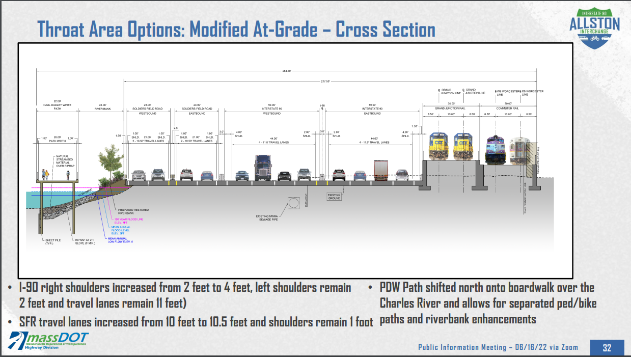

The NPC (Notice of Public Change) for the At-Grade Alternative officially kicked off today with the public information meeting (PDF), and the public comment period kicking off soon. As far as I can tell, the only substantive changes to the plan from that of Sept 2021 is that they managed to narrow the overall cross section from 221.5 ft to 217.5ft by pinching SFR lanes to 10.5ft instead of 11 (from current 10ft) and by reducing horizontal clearances on the GL and WML from 9ft to 8.5ft, effectively getting SFR pavement "out of the river." (see attached plan from 9/29/21) Timeline wise it looks like it got pushed out another year or two, with the final EIS only expected in summer 2024.
Other than that, only new things are that:
1) FHWA has determined that the depressed segment where I-90 passes below the GJ bridge is a floodplain at risk of flooding, and therefore requires further refinement.
2) adjustments to the West Station area have been made to better accommodate a shared use path, whose inclusion appears to be more certain.
3) a potential connection from the west station "loop" over the yard tracks to Cambridge Street as a "bypass road" to be further analyzed. (see 2nd attachment)

I really don't like the current 4' foot bike path along that stretch of Storrow Drive now as it is. I like the river platform; it will be a plus to be away from the traffic. EAs for the pavement; either way you look at it, elevated or at grade, it will be the same amount of pavement. And the area under the highway will not be useful.

Looks like they included a 2-lane road from West Station to connect with Malvern Street, for buses, bikes, and pedestrians, which is a big plus. The "Cambridge Street Bypass Road" also looks like it would be only for buses. bikes and pedestrians, based on it tying into West Station and it's narrow width. That would be great for bus and pedestrian access to West Station.

The design of this thing just seems all-in-all car centric with the #1 priority being to preserve all road capacity. Given that the project won't be completed well into next decade anyway (when climate mandates to reduce carbon footprint will near their deadlines), it seems highly reasonable to design this with a future mode-shift in mind (converting some car drivers to regional rail, BRT from west station, whatever). But no, we have to keep all 12 lanes of cars while the rail mainline gets two unelectrified tracks, with stroads completely covering the walkshed near west station.
Also, Soldiers Field Road is overbuilt between fenway and the river street exit as it stands anyway. One general travel lane with some sort of on/off ramp with the pike should be plenty.
What are we defining overbuilt as? Underutilized? Personal preference?
While they're ancient, the (2006) CTPS traffic diagrams for the area are easy to look at and suggest peak hour volume for the entire stretch between the Eliot Bridge and Fenway is roughly maxing out both lanes, and volumes are generally well above what a single lane can handle throughout the entire wider commuting periods. - ~3,900 cars per hour EB peak, ~3,550 cars per hour WB peak. The 1977/87/97/06 traffic counts were continually ticking up and the couple points I can find recent volumes for to compare against also don't look lower.
If fewer cars is an inherent objective for you/you're a big "induced demand" person - I can't argue with that.
But as simple matter - the road is being utilized to maximum theoretical capacity throughout the stretch in peak periods. (In contrast - SFR underutilized relative to it's lane count west of the Eliot Bridge and a lane drop will by itself have no effect on throughput there). A lane drop on this stretch of SFR would require ~50% of peak traffic to disappear or go elsewhere.
