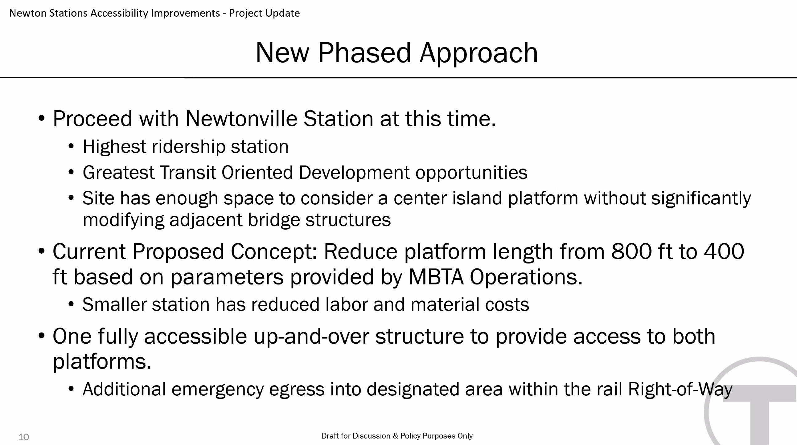

My other thought was that maybe construction costs escalated or local politics got in the way and they're having to delay work on a station?
They can't. Inner Worcester's not a protected clearance route anymore, so they are required by state law to be full-highs.Hopefully they don't go for mini-high platforms.
This is more likely. The initial design concepts seemed to be wildly overbuilt.Another possibility would be converting some of the planned elevators into ramps or something.
Very surprising, since Worcester runs 7-packs at rush. They'd need something like 600-625 ft. to open all doors on those consists. That's gonna kill dwell times hard at the station, which is not advisable at all for how OTP-stressed Worcester is in general.I'm glad that Newtonville is being prioritized due to high ridership. The change to 400' platforms is a surprise to me.
Yeah, 400 ft. will only berth a 4-pack. Framingham/Worcester rarely even shrinks below 5 cars on the midday off-peak, let alone during peak when it's 6-packs as far as Framingham on the runs that stop at the Newtons (plus these rebuilds are supposed to enable schedule increases so some Worcester peak runs can start picking up the stops). Having to walk through a mostly full bi-level consist at rush to get to/from one of the first 4 cars that can berth is going to seriously harm dwells, perhaps even beyond the low-platform dwell penalty of today.The center platform precludes future lengthening to 800’.
It feels like a weirdly aggressive footgun.

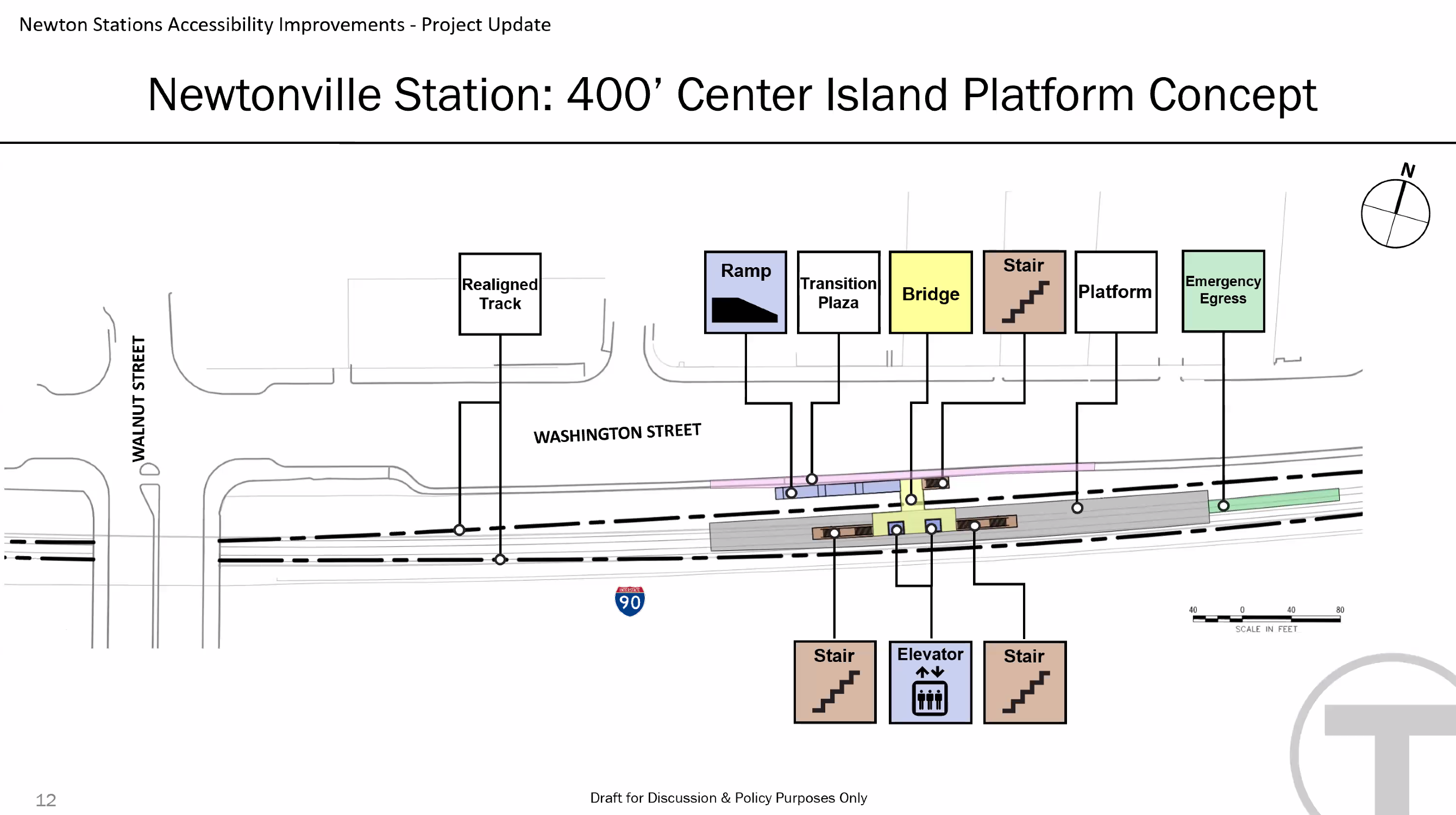

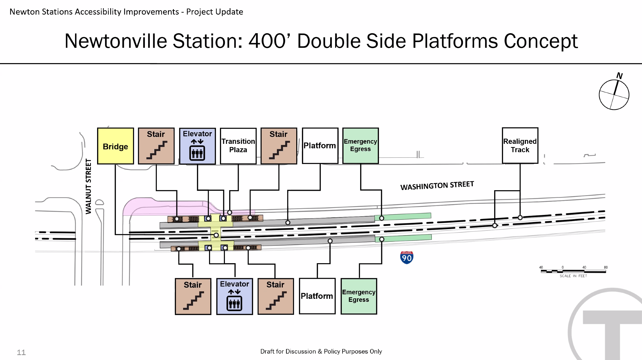

The emergency access routes are insanely large in the renders...some 1/4 the length of the full platform. I can't think of any other CR station that attempts something that outsized.Is there something about distance to a escape route / area of refuge? In the 2021 concept below they'd proposed two distinct access structures for no other apparent reason, which they seem to want to just build one of. But yes, just shortening the platform seems like a bad idea. Why not just adjust the platforms relationship with the access structures?
So, on the question of shorter platforms, I think some of you have heard about the issues or plans around electirifcation and running higher frequency service. The service design is to run high frequency small trainsets, so, move the same amount of people by running more frequency. The 800 foot trains will not be stopping at this station, this will be the high frequency service. This was all outlined in the Rail Vision which was done before COVID. This is a high frequency station so we will not need such long platforms. Just to be very very clear, the intent is not to have a train longer than the platform length stopping at the station. That is not the design, not the service aspect, whether that's diesel or electric.
That's complete gobbledygook. They haven't fully committed to implementing the Rail Vision yet or given a timetable for implementation, so this has to fit existing service if it's to be a sooner-rather-than-later build. And these stops are currently on Worcester off-peak schedules that run 5+ cars, and Framingham peak schedules that always run 5+ cars. No decision has been made on whether to shear off the Newton stops from all suburban service in favor of exclusive intra-128 service; I would think that would be opposed by the city who likes the idea of some service variety continuing to serve the stops, even if it's a minority pattern. In fact, I'd find it highly unlikely that they would be punted to exclusive Riverside/128 turns given how the TPH would have to be structured to be load-bearing for at least the Framingham turns. Plus, what I said above about the EMU RFP's netting married-triplet makes that may have to chunk out to 6 cars if the loading proves too much for minimum 3-car sets (which it will if anything traveling beyond 128 during the peak stops here).So, on the question of shorter platforms, I think some of you have heard about the issues or plans around electirifcation and running higher frequency service. The service design is to run high frequency small trainsets, so, move the same amount of people by running more frequency. The 800 foot trains will not be stopping at this station, this will be the high frequency service. This was all outlined in the Rail Vision which was done before COVID. This is a high frequency station so we will not need such long platforms. Just to be very very clear, the intent is not to have a train longer than the platform length stopping at the station. That is not the design, not the service aspect, whether that's diesel or electric.
Yeah, I was very confused when I heard what they had to say last night. It's really odd that they're choosing to design the station like this.That's complete gobbledygook. They haven't fully committed to implementing the Rail Vision yet or given a timetable for implementation, so this has to fit existing service if it's to be a sooner-rather-than-later build. And these stops are currently on Worcester off-peak schedules that run 5+ cars, and Framingham peak schedules that always run 5+ cars. No decision has been made on whether to shear off the Newton stops from all suburban service in favor of exclusive intra-128 service; I would think that would be opposed by the city who likes the idea of some service variety continuing to serve the stops, even if it's a minority pattern. In fact, I'd find it highly unlikely that they would be punted to exclusive Riverside/128 turns given how the TPH would have to be structured to be load-bearing for at least the Framingham turns. Plus, what I said above about the EMU RFP's netting married-triplet makes that may have to chunk out to 6 cars if the loading proves too much for minimum 3-car sets (which it will if anything traveling beyond 128 during the peak stops here).
Bad, bad omen for community outreach on these critical rebuilds if they're just nakedly bullshitting on stuff like this. Both this meeting and the South Coast Rail one last night were not good outcomes for transparency.
After several years of doing slightly better, there's been a recent downturn in meeting transparency. Presentations simply aren't getting posted on the website any more.Bad, bad omen for community outreach on these critical rebuilds if they're just nakedly bullshitting on stuff like this. Both this meeting and the South Coast Rail one last night were not good outcomes for transparency.
Actually, if done properly, a 6 car consist could do rear door first car, front door rear car.The emergency access routes are insanely large in the renders...some 1/4 the length of the full platform. I can't think of any other CR station that attempts something that outsized.
If they're going to shorten, 6 cars has to be the minimum. They got married-triplet EMU and BEMU bids in the RFP's, which means they have to at minimum plan for trains that chunk out 3 cars at a time with Worcester's all-day loading leading to large number of midday off-peak 6-packs because 3 is not enough.
They do rear door first car at West Medford outbound to get a six car set north of High St so it doesn’t block traffic during the dwell. But that’s only because the T can’t make any material improvements without triggering ADA. This Newtonville design is a crock. So dumb.Actually, if done properly, a 6 car consist could do rear door first car, front door rear car.
That doesn't let you do auto doors, so you're limited to doors with a conductor, which kills your dwell times. To do auto doors with a 6-car set, you need 510 feet (plus 20 or so extra for margin of error). Platforms really are not the expensive part of building stations - it's just footings with prefab panels on top - so cheaping out by shortening platforms smells particularly fishy.Actually, if done properly, a 6 car consist could do rear door first car, front door rear car.
Unless the engineering of the long platform causes you to do something else expensive. You could have site specific issues, such as expensive to move obstructions, or space limitations that cause you to use elevators instead of ramps for accessible vertical access. I am not saying that is the case, but rather there are many reasons why short platforms might be indicated.That doesn't let you do auto doors, so you're limited to doors with a conductor, which kills your dwell times. To do auto doors with a 6-car set, you need 510 feet (plus 20 or so extra for margin of error). Platforms really are not the expensive part of building stations - it's just footings with prefab panels on top - so cheaping out by shortening platforms smells particularly fishy.
Some more transparency here would have gone a long way.Unless the engineering of the long platform causes you to do something else expensive. You could have site specific issues, such as expensive to move obstructions, or space limitations that cause you to use elevators instead of ramps for accessible vertical access. I am not saying that is the case, but rather there are many reasons why short platforms might be indicated.
