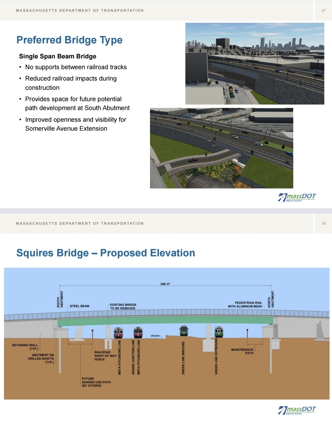

The removal of the bridge piers is huge for a grade-separated grand junction tie-in. So much more space underneath the span now.
It's a parkway. So it's crazy to require 12' lanes and 8' shoulders. This is not an interstate expressway, it's a multi-use corridor, a parkway. I'm a civil engineer who designed roads on National Parks, road projects which were federally funded. All kinds of design exceptions were made to make the roadways compatible with their context, which is exactly what needs to be done here.
Updated alternatives for Reid Overpass. There was an information meeting today. Attendees and cycling advocates were present from around the metro area and it was near consensus for the second alternative. This was mostly because of the fact that people may block the box at the signalized intersection and that the roadway was too wide. However where the problem lies is that the required lane widths are 12’ with 8’ shoulders for something like this considering it’s federally funded. MassDOT AND DCR want 10’ lanes with a 2’ shoulders. This however would require approval from the Federal Highway Administration since it is a federally funded project. At least this was what was told to me.
Also, the state senator who proposed automated traffic enforcement was present and said it will most likely be passed in October as part of the economic development bill and that they are looking into expanding to non safety zone roadways, and if this ends up happening it was mentioned by MassDOT staff that they would most likely install them on the overpass.
The first design is laughable. Literally looks like something out of texas or arizona. Glad everyone had the sensibility to strike that down.
It looks like what was built at Arborway & South St in Jamaica Plain, something I've navigated in all modes of transportation many times, most often on bicycle, and is deeply flawed.The first design is laughable. Literally looks like something out of texas or arizona. Glad everyone had the sensibility to strike that down.
In no sense other than words on paper are most of the DCR Parkways actually "park ways" in the sense of being access to park land or with recreational functions as anywhere near the primary function of the road. They're major arterial roads that serve heavy commuter loads and that's what they've been designed as for the past 70+ years and what the metro area has been built around them serving.It's a parkway. So it's crazy to require 12' lanes and 8' shoulders. This is not an interstate expressway, it's a multi-use corridor, a parkway. I'm a civil engineer who designed roads on National Parks, road projects which were federally funded. All kinds of design exceptions were made to make the roadways compatible with their context, which is exactly what needs to be done here.
