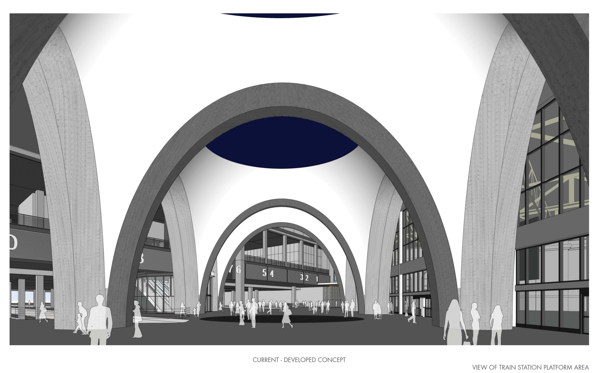

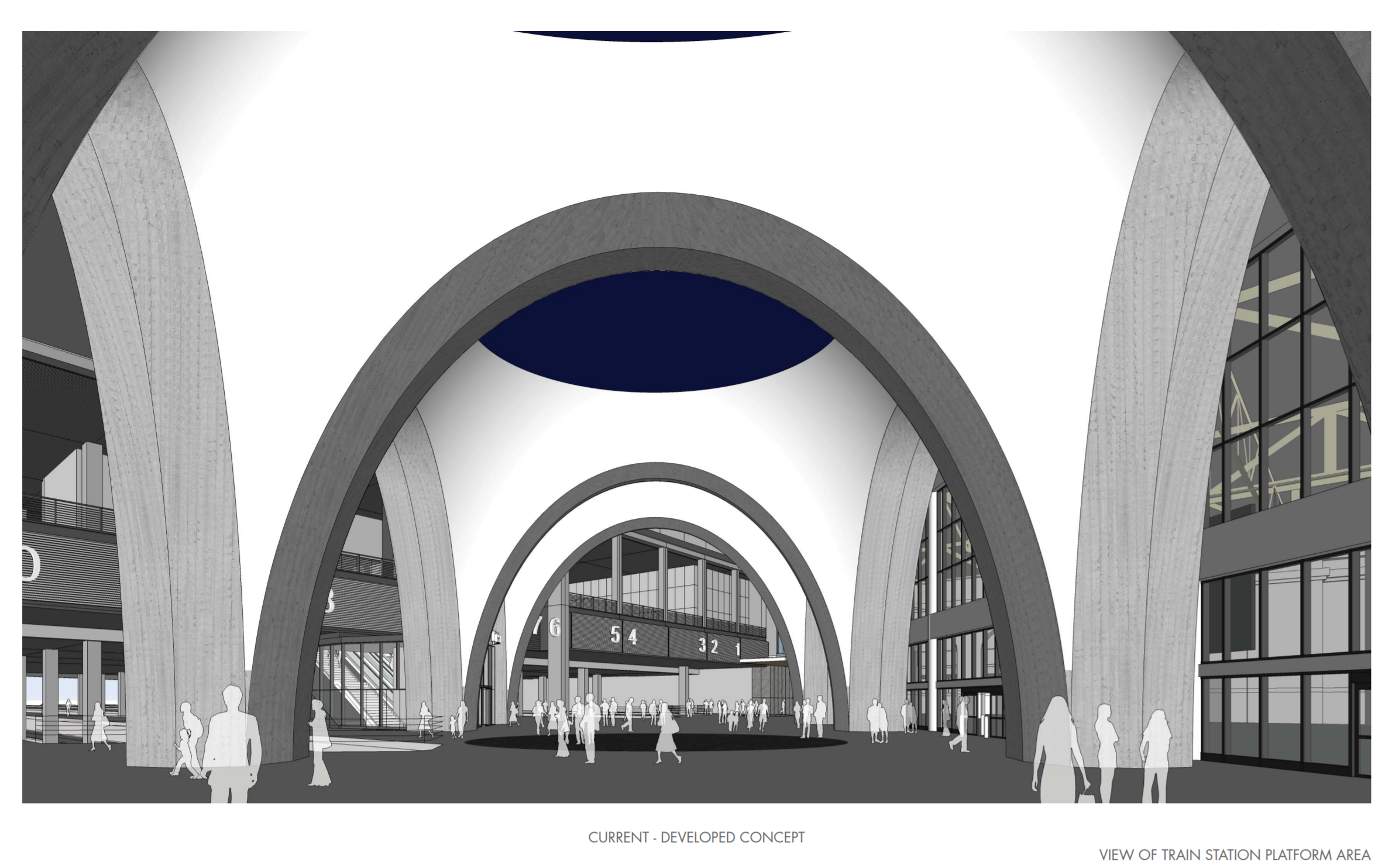

From the above render it appears you wait inside South Station main concourse to see the Train board then when the platform is announced you run outside through a wind tunnel to only enter another door to where the platforms are??? What's the reasoning for that Archway area to be outside instead of inclosed with the platforms?
Seems strange from a functioning point of view.
Where are you seeing the second set of doors? I see the nose of a train right in the middle of where the arches are...
i think the 'first' set of doors is the doors to the escalators/stairs/elevators to the new section of the intercity bus terminal
From the looks of things, it would appear as though the tower itself will be sitting atop the arches when it begins to rise to the sky. Am I correct in assuming that this is how things will be? :unsure:
Pretty much, but its more like when you look at the arches youre looking through the base/core of the tower, so the tower is already rising. Towers basically always have a solid concrete or steel core that rises up the center of the building from below ground level to the roof. Here since there is a train station concourse at ground level they want it all to be open space for passenger flow and not have a concrete or steel core in the middle of the concourse where passengers have to walk.
The tower appears to basically have an open core at ground level that along with some perimeter columns are what make up the arches. Its hard to describe but there are 8 columns that make up the arches. 4 of those columns (the center 4) are from the core. Then on either side are 2 more columns per side for 8 total. These are from the outer 2 perimeter columns on each side of the tower plus the 4 core columns. The arches between all 8 columns create a stable platform where they are able to essentially build the tower as usual above after a few different trusses above the arches tie everything together.
I marked on this picture where the 8 columns are that are used to make up the arches. 2 perimeter columns on each side then 4 core columns in the center. Then you add a half moon between each column in front or to the side and you get the arches from the concourse. You have to imagine that the tower is see through.

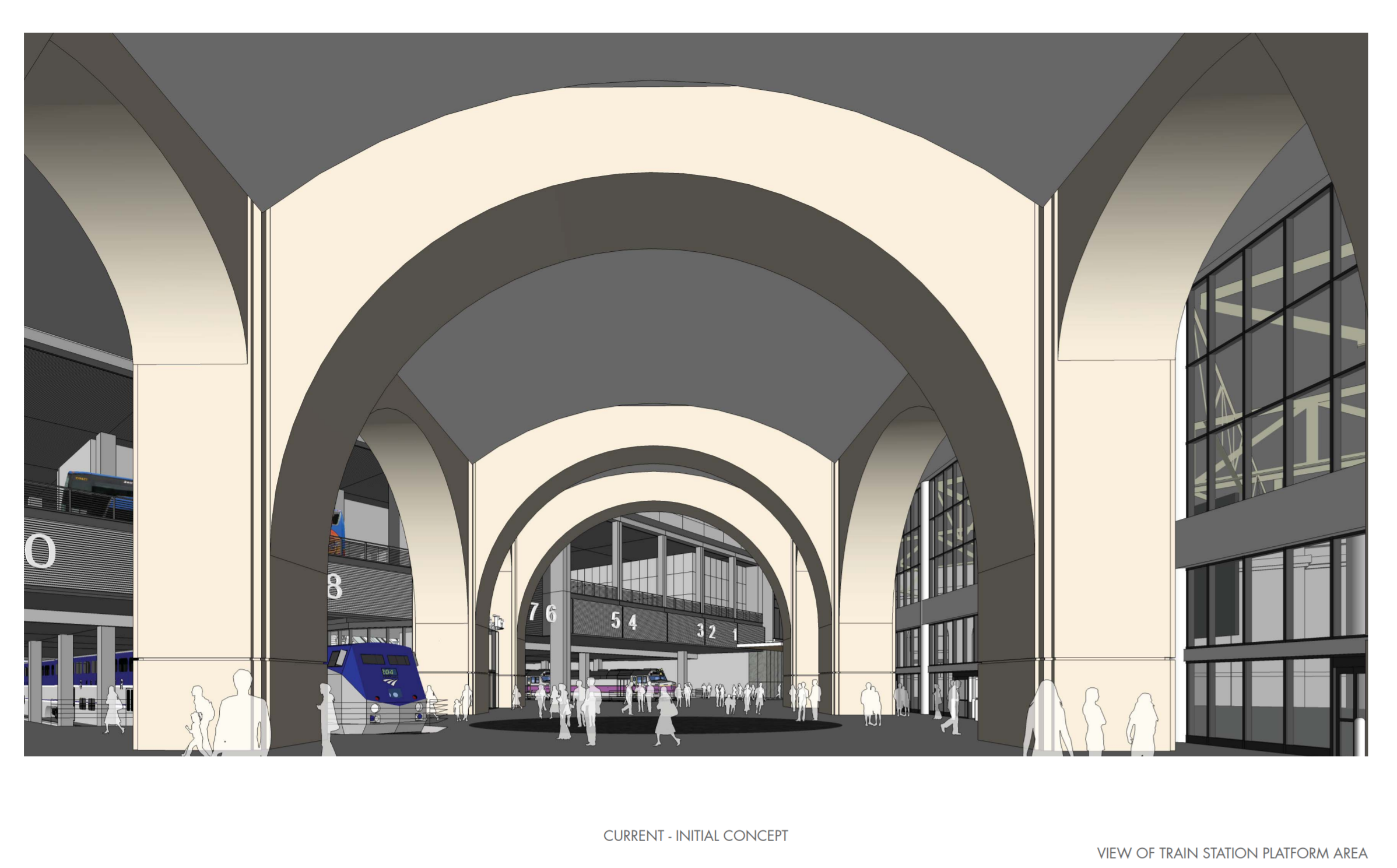

Seems like the design for the arches might have returned to the "initial concept" design seen in previous renders.
For comparison purposes, I've included the other render for the "developed concept" design.
Ugh. God that's so dull. Such a disappointingly typical VE of public infrastructure in this city...
Is there a more recent presentation your pulling that screenshot from? I couldn't find anything updated on the bpda site.
I could be wrong but this was the image that made it look like the Archway area is an open to the outside hallway with automatic doors on both sides, 1 to the main station and the other to the train platforms. But another another image posted afterwards shows an Acela Train open to the Archway so maybe you're right and the doors on the right are for a hallway to the bus terminal.
