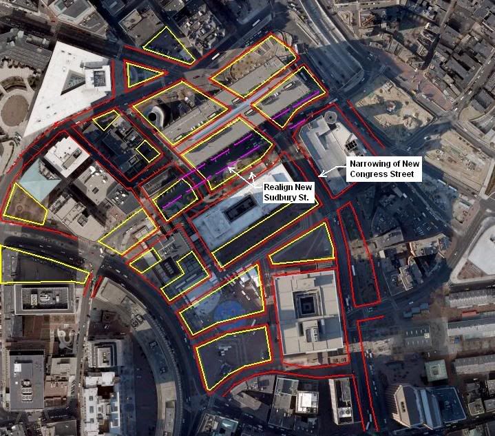

This project area could be enlarged a bit by shifting New Sudbury Street toward the Federal Building as shown in this rendering. The purple dashed lines are the existing street, and the solid red is the realigned, narrowed street. Yellow lines represent developable blocks. The proposed project could be broken up into smaller blocks as shown, with a narrow street or pedestrian alley bisecting the site longitudinally. The resultant array of narrow streets and smaller blocks would give a more urban feel, eliminate the wasted area along the nw side of the Federal Building, and would still allow sizeable, tall buildings to be developed.
Congress Street should also be narrowed as shown, and vacant land adjoining the proposed project developed, to create a dense fabric of small streets, pedestrian allys and buildings, fully integrated with the surrounding area.

^ Good job, Charlie. Your thoughts are always interesting. Boston was better the way you remember it, and I'm glad you recall its nature well enough to recreate it. If you had gone to architecture school, there's a good chance they would have lobotomized you with minimum standards, service areas and other mundane considerations that guarantee urbanity's defeat.

I'm most likely wrong but judging from some of the traffics I see around rush hour in this area, I think you are under-estimating the impacts of narrowing the streets, especially Congress Street. Any narrowing of that street will instantly create large traffic jams in that area. The creation of new streets and intersections will also spawn new traffic stoplights which may be beneficial in slowing down traffic and preventing high-way like speed but will increase traffic dramatically.

I think studies have found that traffic tends to redistribute itself quite well in such situations.
The real problem would be the feds freaking about anything getting closer to their building than it is now - particularly vehicular traffic.

A denser network of narrower streets (with smaller blocks) would have similar capacity to the current network of wide streets and super blocks. If Hanover Street were extended to Cambridge Street, that would divert some traffic from New Sudbury Street. New Congress Street could easily be narrowed from 6 to 4 lanes, due to the added capacity in the parallel RKG surface roadway.
Besides, do we want a dense, transit and pedestrian oriented downtown, or a dispersed, automobile oriented one?

Congress Street is only two lanes south of State Street, so I see no need for it to be wider north of State.

I like the redesign, a lot. Shows how can increase density while also improving traffic and pedestrian flow.
A couple things I see:
* I don't think it's possible to build in front of the Trial Court House. It's too small a piece of land. (This is the triangle across the street from the Mobil gas station.)
* I think the Feds would forbid anything from being built next to the high-rise and low-rise JFK building. I think Leventhal etc. suggested it back when the Mayor floated the idea of putting Hanover Street back in place and the initial response was negative.
* Should a realigned New Sudbury Street be two-way traffic? New Chardon, as well?
* Why do you include the land / building across from the old Bell building on Cambridge Street? Is this next to Bowdoin Place or in front of it? What's there now, I can't place it.
* If you bring back roads between Center Plaza and Congress Street, they will have to be given their "original" names (Court Street and Brattle Street) or I won't buy into it.
* The argument against building anything of substance over the MBTA blue and green lines over City Hall Plaza has always been that the ceilings can't support it. Well, I think if we built the Big Dig, we can figure out a way to reinforce the ceilings so that they can, no?

The Green Line tunnels under City Hall Plaza would not present an obstacle to developing buildings and streets there. The western (inbound) tunnel is the original tunnel existing since the early 1900's, located along the former Hanover Street alignment. The eastern (outbound) tunnel was built in the late 1960's as part of the GC construction. Also, the loop tunnel for light rail cars to turn around just north of GC station was built then.
The roofs of the tunnels could easily be reinforced as needed to support buildings and streets. The tunnels are two track (the loop tunnel in one track). They are narrow tunnels, nothing like the 4 and 5 lane Central Artery tunnels. There would also be plenty of vertical clearance available to build an additional reinforced slab of the tunnel ceiling, due to the huge size of the Plaza that would be redeveloped. You could raise the elevation of the ground 2 feet across the Plaza, to allow for ceiling reinforcement of the tunnels, and it wouldn't even be noticeable.
As for the Federal Building, redevelopment of the area and realigning of streets should not be constrained by security needs. If that level of security is required, then the City should pay for the Federal agencies to move to a more secure location.
