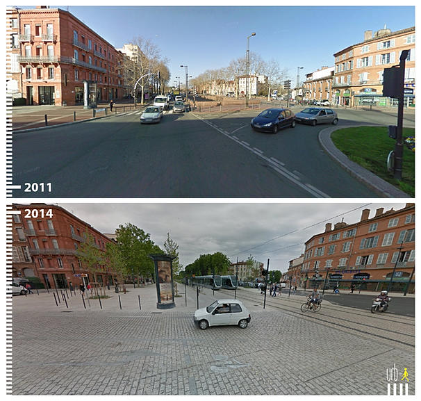

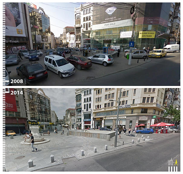

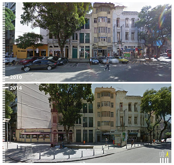

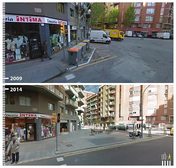

Here are some inspiration pics I used to come up with my preferred scheme:
