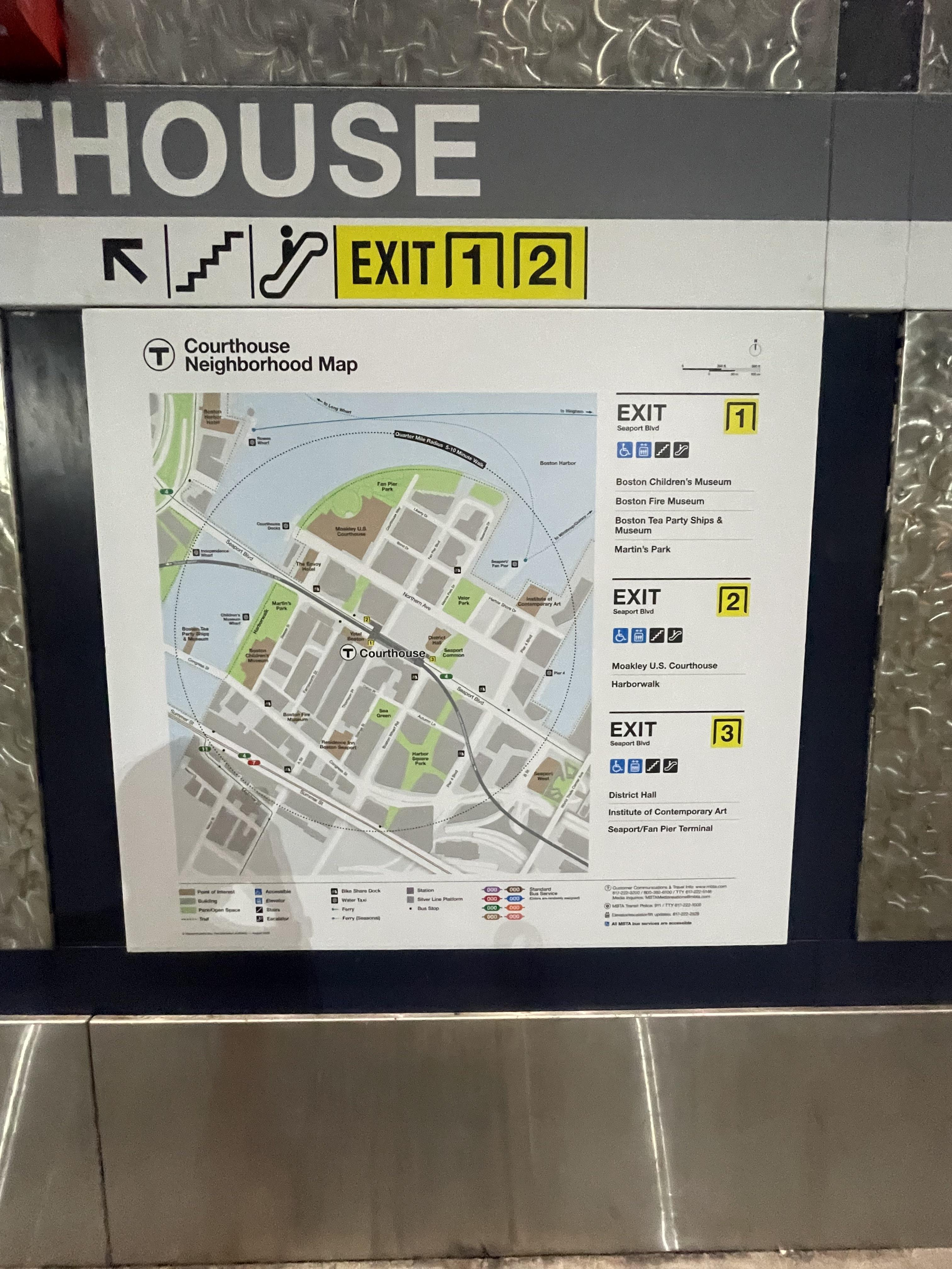

Improving wayfinding of station exits
I propose the following improvements for station exits:
  • Give an explicit label (letter or number) for each exit
  • Any signage within the station should include: Exit label, street coordinates, and the side of the street (or corner of the intersection) that the exit is on
  • For selected signage (e.g. large information boards and signs with multiple rows), also include key destinations, reachable major streets, and bus transfers
  • Platforms should always have neighborhood maps that indicate all exits, especially for stations with multiple disconnected unpaid areas -- so that passengers can decide which exit they need beforehand
Using Tufts Medical Center as an example:
  • Exit A: Washington St @ Tufts Medical Center (West Side)
    • Exit here for: Tufts Medical Center, Stuart St, Kneeland St, Chinatown, transfers to bus routes SL4, SL5 and 11
  • Exit B: Tremont St @ Oak St W (NE Corner)
    • Exit here for: Eliot Norton Park, Wang YMCA, Shawmut Ave, Charles St S, transfer to bus route 43
  • On the platform, opposite arrows show "<- Exit A, Washington St" and "-> Exit B, Tremont St"
