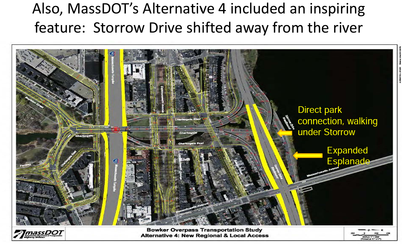

This solution would be such a clean solution. In reality, this still shows remnants of the Bowker overpass at the Back Bay Fens intersection. Just let Boylston Street meander over to Mass Ave and let that be the primary eastern connection to Storrow. I don't think the Turnpike needs on/off here either which would allow for such a Boylston re-alignment.

I really like the proposal of connecting the overpass with Mass Pike and calling it a day. Is there a reason why it was rejected?
Don't think there's the land for it unless you claw back space from...somewhere? (Newbury? Ipswich? Both?). And/or cut travel lanes on the Pike.
I'm also not sure how this overpass...works. Those are yellow lines overlaid on the existing layout without explaining the rest. How do vehicles get from this down to Charlesgate/Back Bay?
I'm somewhat skeptical you can get an acceptable grade with compressing the distance between Comm EB + overpass height any further.
I also don't think anyone thinks the Mass Ave interchange will work for Storrow.

Based on the plan I came up with (below), an EB on-ramp from the Bowker overpass to the east bound Mass Pike could fit in, if one lane of the EB Pike is dropped (from 4 lanes to 3 lanes), and the parking along the north side of Ipswich Street is eliminated, and the RR tracks shifted over using that space. An eastbound on-ramp is possible, but not a westbound off-ramp, as the existing Newbury St on-ramp precludes that, and there isn't space anyway.
Here's my layout for the eastbound onramp to the Mass Pike from the Bowker overpass.
Can you make a westbound off-ramp by converting the existing Newbury St on-ramp to have a grade intersection with the Bowker overpass, and only start descending after crossing through Bowker?
So you want more cars in the area?
I think @Charlie_mta is talking about the proposal of connecting Bowker to Mass Pike in exchange for eliminating the existing connection to Storrow (Alternative 4 here). This allows you to tear down the entire structure north of the Pike.
Yes. Also, the additional EB on-ramp to the Pike would further the cause for eliminating Storrow Drive completely east of Charlesgate,
Yes, but it would be a very short off ramp, with vehicles doing 60 mph all of a sudden entering Newbury St. Also, for traffic from that off ramp to make a left turn and head south (to Boylston Street, Route 9, the Jamaicaway, etc), there would have to be a rather steep inclined road built from the corner of Newbury St and Charlesgate East across the Muddy River up to the Bowker overpass. That may be possible if a rebuilt Bowker was shifted as far west as it can, but even with that I think the change in elevation between Newbury St and Bowker overpass is too great over too short a distance.
