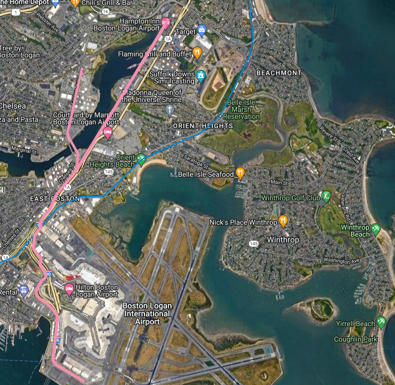

Why not enable this growth and shape it in the least destructive way possible with an automated, short freight railway based around handling air cargo containers? I can't think of any other similar system out there, so maybe this is really God Mode wishful thinking, but the idea would be to keep as many trucks as possible from adding to the horrible traffic in and around the airport. Call it Boston's real answer to The High Line, but for Logan Airport instead of Chelsea (NYC).
- Massport could be trying to grow Logan in a shadow way, by expanding some airport service activities up there.
- Logistics developers definitely think there's good money to be made by growing there, since it's as close as you can get to the airport and still do large-footprint industrial buildings. See: the huge warehouses that are slated to replace some of the Irving oil terminals in Revere, and the 2019 proposal that got Jim Aloisi & co. worked into a lather about a disused rail line that has no clear future.
If air cargo is going to be a durable part of our economy, despite its climate impacts, thanks to our insatiable demand for travel and things that must be delivered Right Now, and if freight rail seems to have little future in the urban core, let's channel those trends in the least-damaging ways possible.
Brief sketch, starting at the existing air cargo facilities at the base of Runway 33R/4L:
I think there should be enough room to also build the last Logan people mover design that got floated just before the pandemic alongside this?
- Elevated tracks taking some space on Harborside Drive and Transportation Way before slipping over the Pike at this low point here
- Elevated above Service Road, slipping back over the expressway at another low point around the East Boston library/Excel Academy
- Dropping down into/taking over the Coughlin Bypass Road before popping back up to elevated next to the CubeSmart building next to the Chelsea Street Bridge before branching:
- Eastie branch:
- Follow that same old, infamous rail line, but at ground level, incorporating flood defenses and maybe a public greenway as outlined in Climate Ready Boston Phase 2.
- Offers sidings/direct connections to the ground floor of anything built along 1A and, presumably, opportunities to send elevated spurs across 1A to things built on the soon-to-be-former oil terminal properties.
- Chelsea branch:
- Dodging the MWRA sewage pumping station, blowing through the derelict former MWRA pumping station to cross Chelsea Creek north of the lift bridge, soon to be as obsolete as the tank farms up-river.
- Turn to run along Eastern Ave to provide direct connections to the second floor of anything built along the creek.
As for logistics companies looking to ship by rail...there's not a whole lot of land for plunking something really big down there. A company that had a pressing need for rail wouldn't be locating down there...it would be seeking out (copious) available industrial land along one of the freight mainlines. For the very narrow market of companies that would need to transload cargo to both air AND rail, there's no reason why a truck trip to Readville or Framingham or Lawrence or even Everett Terminal couldn't do the job for the rail transload. And if there's some hyper-urgent need for it close to the Airport, there's a small yard next to Global Petroleum on the out-of-service portion of the East Boston Branch right next to a few air freight vendors could be fixed up and reactivated for the daily BO-1 Everett local to serve...reducing the truck trips to only a mile or two intra-Eastie. But Pan Am has been trying for 30 years to find some customers for the yard, with no takers.
The economics really aren't that good for this. Logan doesn't have particularly huge...and ESPECIALLY doesn't have particularly wide-ranging...market for air freight, there's limited synergies for air and rail freight in the same spot (and if there were an airport with pre-existing onsite rail like Bradley would be the first to target), there isn't a logistics incubator for particularly large carload counts in Eastie, and Greater Boston has a supremely efficient trucking industry for handling all the locally-bound loads.
