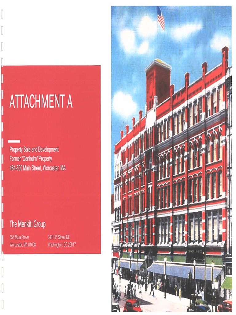

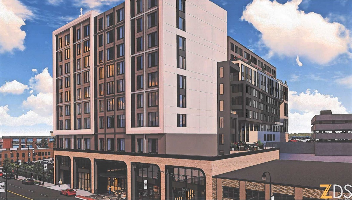

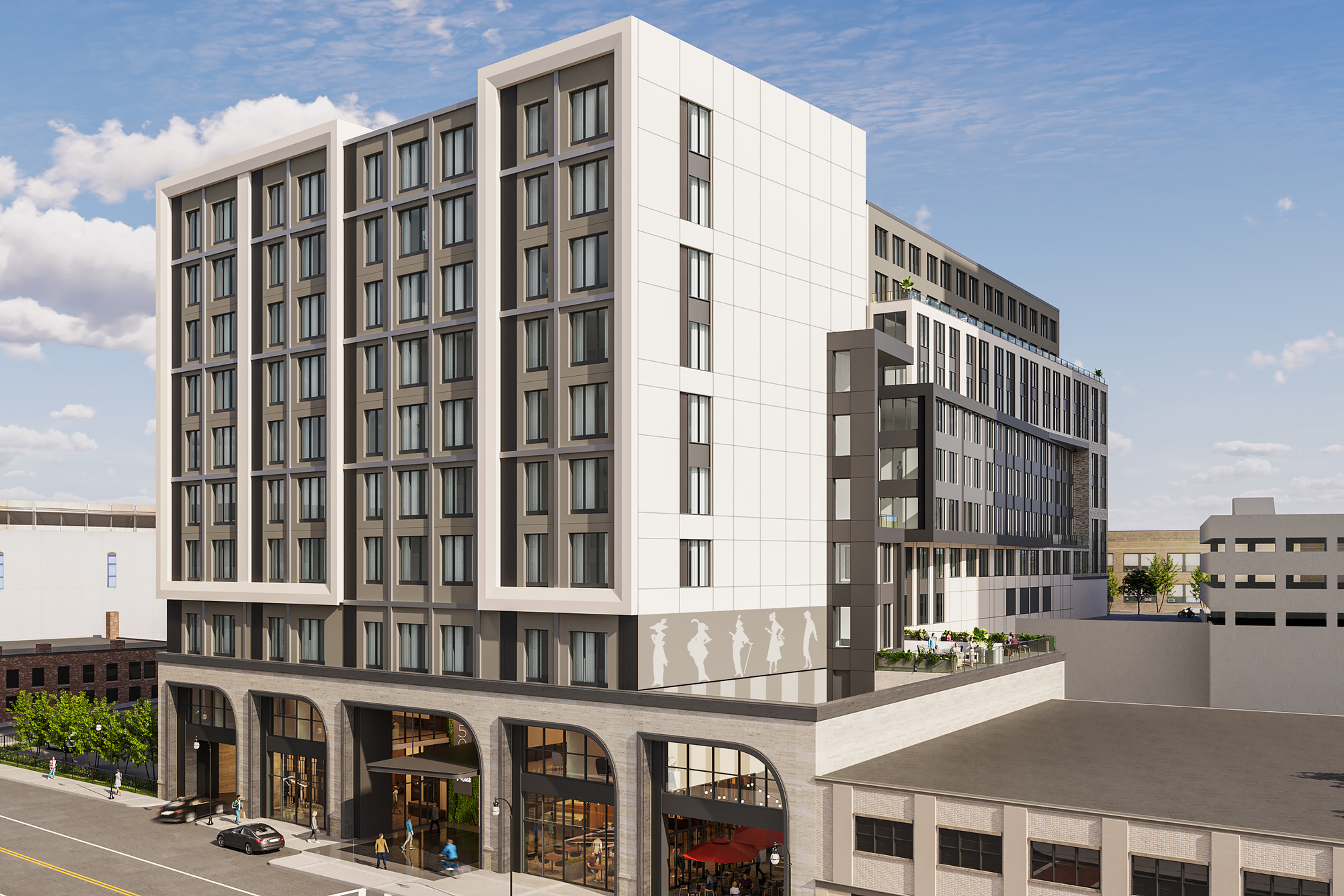

Denholm Redevelopment | Worcester
ctsketch
Sep 30, 2021
411
447
Menkiti and RMS are the front runners for demo and redevelopment. I like Menkiti's plan. 10 and 11 stores, 20% affordable, 10 % accessible and public space
Agreed it's the better of the two proposals that move forward, just judging by the numbers. That rendering is hopefully just a massing study *fingers crossed*
Sorry to see the old building go, it got a cool urban façade and some nice interior details, but it's just not easily converted into anything useful and needs tons of upgrades.
Another angle of the Menkiti master plan. There are some allegations about the business practices of one of the subcontractors. Ground level looks nice, the rest of the facade facing Main Street.. meh.
source: wbjournal
edit: added source
