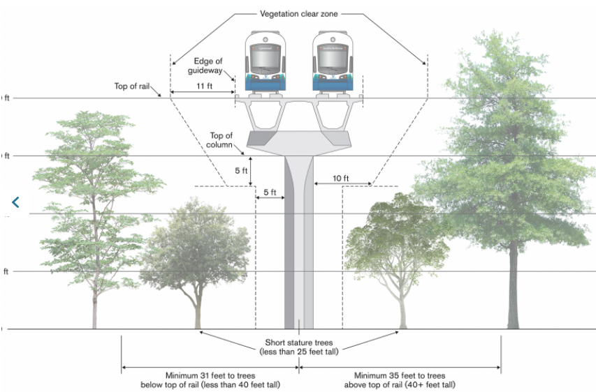

Here's a typical section from the SoundTransit website. The column itself looks to be 30 ft. tall and 5.5 ft. wide. I'd do some other measurements in regards to how well it would fit onto Broadway in Everett, but I was in an accident a few days ago wherein I broke my glasses and my nose, am recovering well but can't see the screen all that great. But anyway, something like the typical below on center piers down the middle of Broadway wouldn't be so bad, IMO. I'd look up the generic cost of a subway vs. an elevated, but like I say my vision is a bit compromised right now.

Assuming all the pieces are to scale, it looks like their recommended "vegetation clear zone" is 45 feet wide. Choosing a random spot along Broadway, sidewalk-to-sidewalk is 44 feet. I agree that the column is about 5.5 feet wide, so probably you'd need to lose parking on at least one side of the street to make space. The guideway itself is 22 feet; however, the Green Line viaducts (both GLX and south of Science Park) are more like 32 feet wide. Looks like sidewalks themselves are 12 feet wide each. So overall building-building length is ~68 feet, which is consistent with what I see on the satelite.
That would mean anywhere from 18 to 23 feet from the edge of the viaduct to building windows. And, as suggested by the mockup below, at the heights suggested here, trains would actually be potentially running higher than a three-decker (although many three-deckers have their first floor lifted above the ground, so there would still be some overlap). Stations would probably add another 20 feet of width, so those would definitely be quite close to windows.

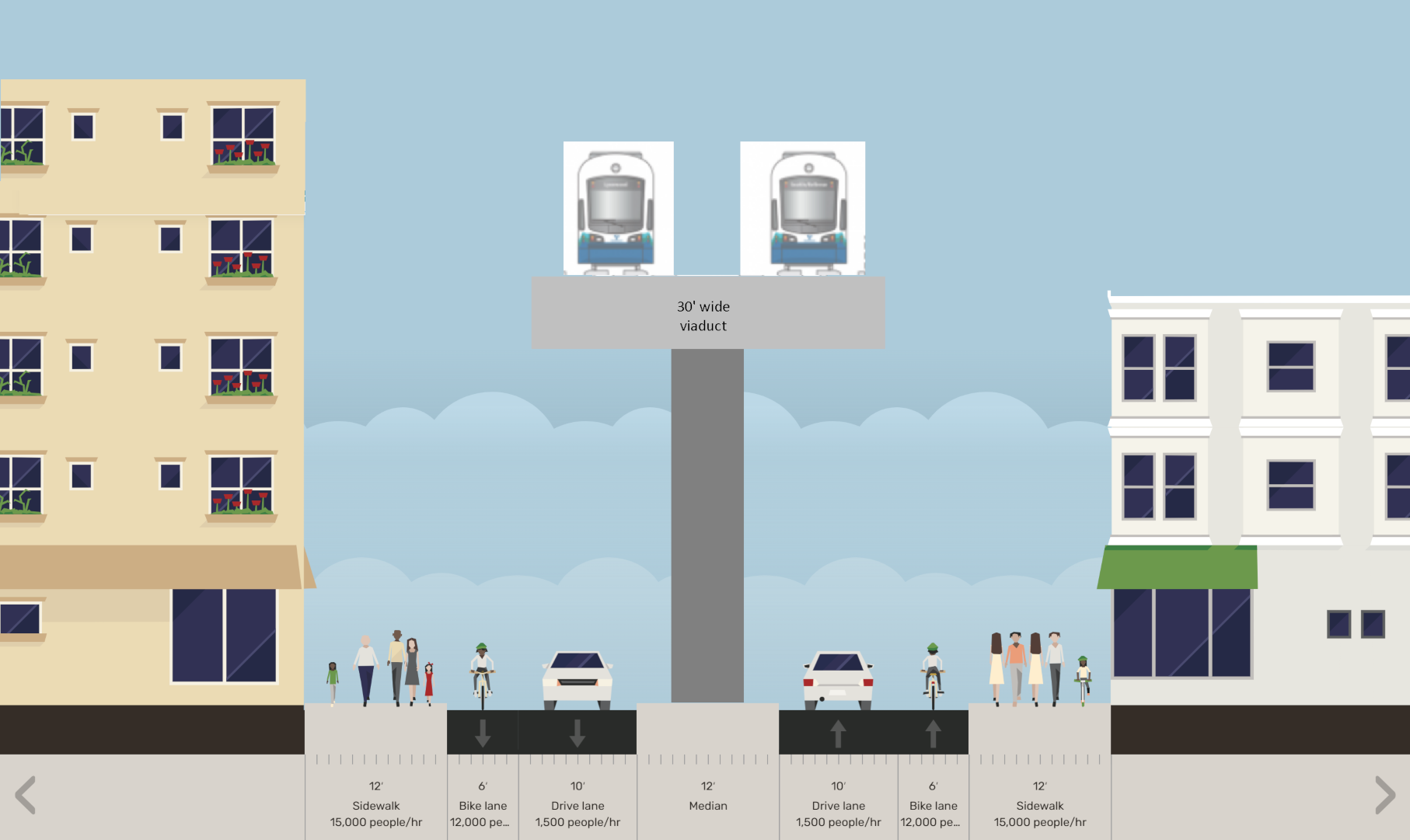

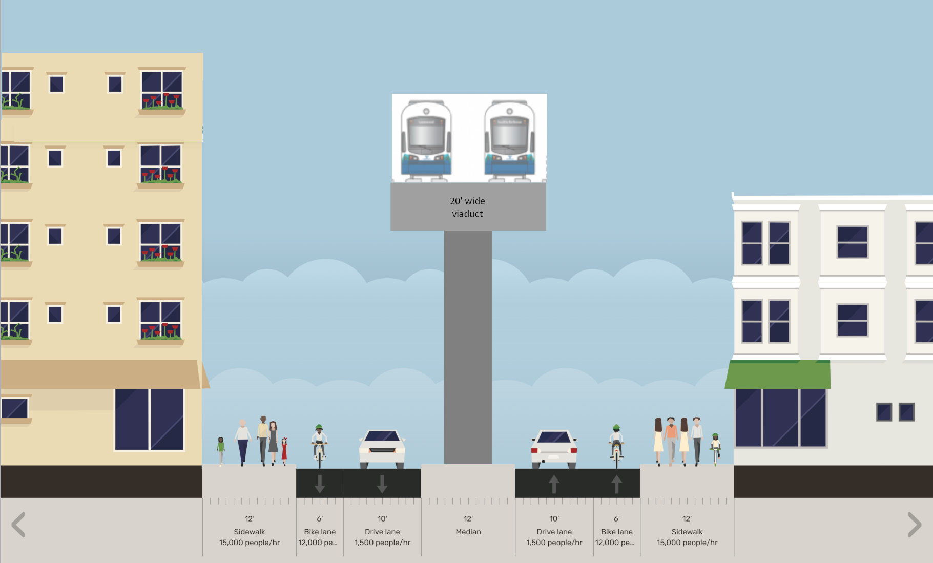

I used Streetmix and Paint.NET to try to do a mockup of what it might look like with an elevated of that height and either a 20 or 30 foot-wide viaduct.
I'll be honest: to me, the width is less of a concern than the height. (I say, having never myself lived with a train running 20 feet away from my window, which is to say that the width may well still be a big issue.) But as for the height: I don't have anything concrete (or professional) to back this up, but to me it just looks overtall for the space. It won't cast as much of a direct top-down shadow, but it will block angular sunlight, so it would still impact the street below.
