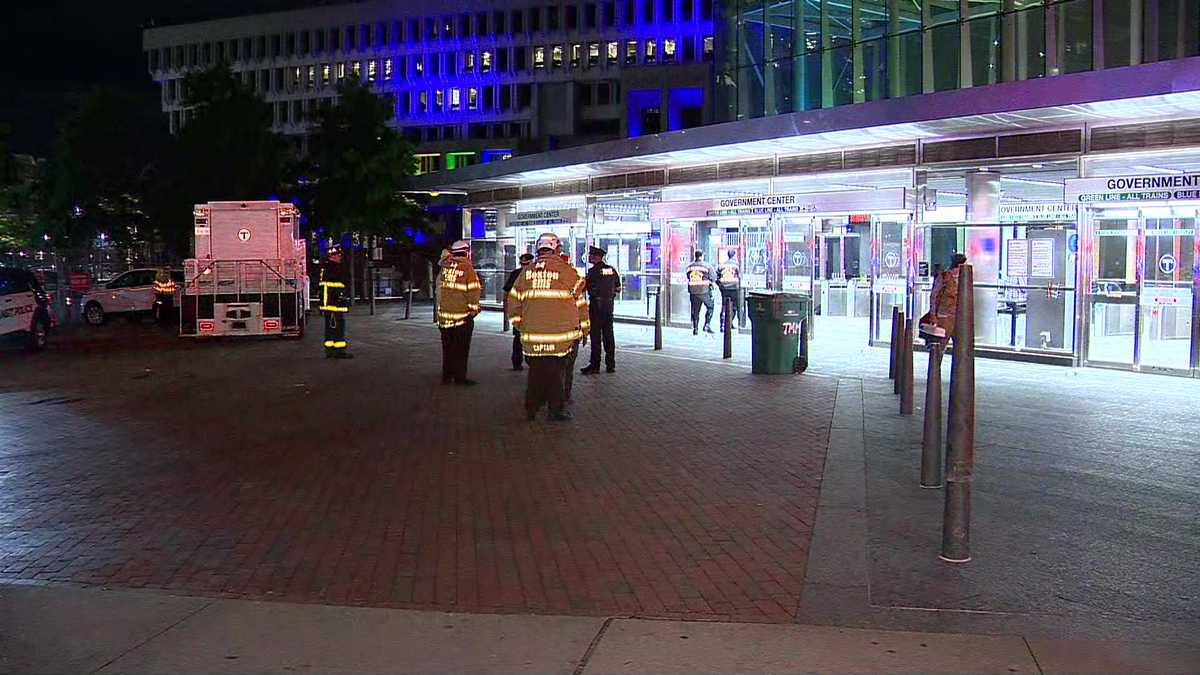

Another safety incident on the T
Green Line service resumes in downtown after collision
Service was restored Thursday afternoon, nearly a day after the collision.www.wcvb.com

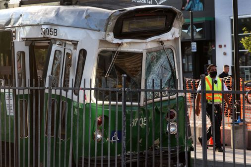

Only 86 of the 100 3600s made it to the rebuild. It's not like the attrition rate is significantly worse than it was before, nor have either of the T7s involved in this crash been deemed total losses.The Type 7's were rehabbed not too long ago, yet it seems like they are getting banged up fast! Boy! What a definite waste of money!!![]()
What does that (a high-speed front/rear collision that wrecked the car) have to do with this incident (a slow-speed sideswipe that didn't wreck the car)?Seems like any trolley involved in an accident got banged up. Remember this one last summer at Babcock Street Station?View attachment 25020

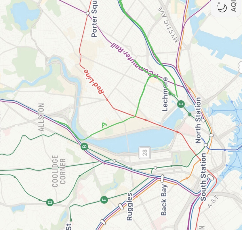

Heres a map I sketched up quick a while ago with what I think would be the easiest rail extension through grand junction. It consists of an at grade green line extension off of the union sq branch, through grand junction, ending at west station. Thats it. Its not perfect and it doesnt solve every issue, but it gives red line riders a transfer to go east-west through cambridge, it gives commuter rail riders an easy transfer at west station into cambridge, it gives blue line riders a single transfer to cambridge, it connects mit/harvard by rail to northpoint, and it gives north station commuter rail riders a single transfer to get to mit/harvard/kendall. It could be upgraded later with connections to the b line, but for now I think it would be a great interim solution.
I don't think the performance would be that bad. It would have 6-7 street crossings, and would require all-new signal infrastructure that would presumably be smarter than what the B/C/E have. The distance from BC to Kenmore is about 4.5 miles, and the GJ would be about 3.2 to Lechmere.Well, apart from the small matter of West Station not existing (and who knows how many more rounds of Harvard back-and-forth it will take before something gets done with Beacon Park), it's not the worst idea in the world. (And if it catalyzed them to building West Station a bit faster, that'd be a good thing) Can't avoid at least a little tunneling at the Union Square branch junction to the GJ, because the GLX is on the wrong side of the ROW. I've always been a little wary of whether there's enough room to dig under the Fitchburg to get on-alignment from the GJ to the GLX incline to Lechmere, though F-Line among others says there is so I'm inclined to go with that part being possible at reasonable cost until proven otherwise. Without the B-line connection, though, GJ becomes a fairly longish northern branch of the GL, I'd start to worry a little bit about operations and on-time performance (though that could be mitigated if they did what they should have done in 2014-16 and opened up (and raised) the Brattle Loop platform at GC. (It'd be useful even with just the existing GLX, and they, uh, didn't quite do it right in the renovation...)
