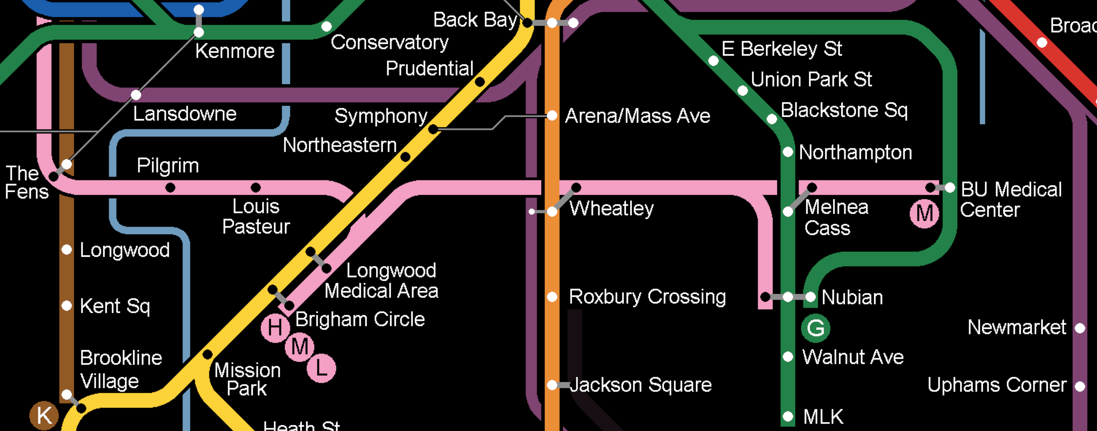

This got me thinking. The latest iteration of my crayon/GLR map has three services using Ruggles St: an H Harvard <> Ruggles service, an L Brigham Circle <> Mattapan service, and an M Brigham Circle <> BU Med Ctr service. The L and M run along Huntington before turning on to Ruggles, so aren't a concern here. So, really, the 2000' spacing would only impact something like my Harvard <> Ruggles service.
All of which is to say, maybe it wouldn't be so bad to reconfigure these services to not require a transfer at Huntington & Ruggles. Something like this:
H: Harvard <> Brigham Circle
L: Brigham Circle <> Nubian via Ruggles
M: Brigham Circle <> BU Med Ctr via Ruggles
H gets more direct service to Longwood, and through-Longwood journeys are still possible through a cross-platform transfer at LMA station. (Which, yes, should be renamed.) And given that the BNRD is relocating a number of bus transfers from Nubian/Ruggles directly into the LMA (more on that below), having the Urban Ring services do the same has benefits as well.
One downside here is that Regional Rail commuters transferring at Ruggles will have a less-direct route to BU and to Harvard's Allston campus. Transferring at Back Bay and doubling back to Lansdowne or West Station isn't the worst solution, but it's not great especially for Allston, where an additional transfer at West Station will probably be required. So, it'll definitely a question of comparing pros and cons.
