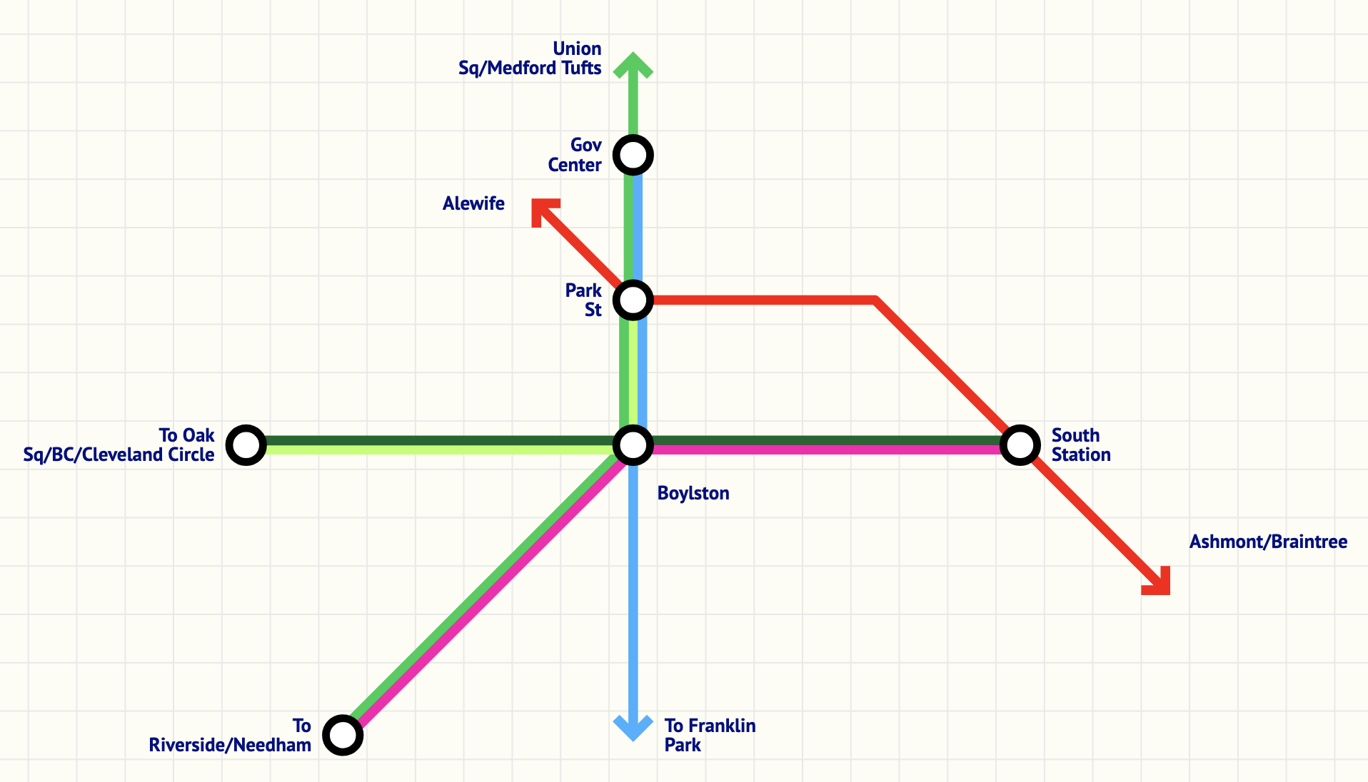

I think the main point here that I didn't realize beforehand is: You're implicitly assuming some Huntington trains would regularly turn at Park St inner loop under Criss-Cross. Now with this detail, I'm fully onboard, and I do agree that Criss-Cross can still be a capacity boost even for Huntington.
Ah oops, I see. In fact, I’m actually suggesting that Criss Cross would either loop some trains at Park, or would add a northbound crossover north of the station, or both. (This detail is tucked subtly into the track diagrams above, but I should have mentioned it more clearly. )
Previously, my mental image was that Criss-Cross would leave the Park St loop unused (except for run-as-directed trips), but Tripld uses it to terminate B and C trains. In that scenario, we're essentially comparing M=40 for Tripod to M=30 for Criss-Cross, and it does become a notable negative for Huntington.
Yeah. And it’s interesting to note that I think this is actually how it’s being used today — the Inner Loop is just being used for RADs. I dunno what to say about that.
So there's still a notable difference between LRT and HRT for an apples-to-apples comparison.
Thanks for finding those numbers! Yes, I think this is a fair point. For the moment, my thinking remains that the best path to high frequencies is a simple network topology, but obviously my thinking on that has evolved over the years, so perhaps I’ll be convinced to go the other way again!
I don't see what you meant by "keeping a version of the E in place"? Under Criss-Cross, the bottleneck isn't anywhere close to Huntington tracks itself: it's on the Tremont St subway, either at Park St or Government Center.
Sorry, this was a thought I had toward the end of writing the novel (lol) so I didn’t explain it very clearly. Using the Criss Cross designations, I’m suggesting:

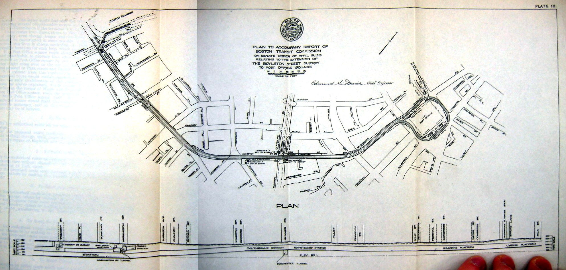

Here's the plate, for the Post Office Sq extension:
And it looks a lot like Silver Line Phase 3. Which then makes me wonder: Has the difficulty of that potentially been overstated by this board? Did the cost overruns and challenges come more from mismanagement than actual technical difficulty?
Assuming it is possible, what about a service plan like this?
This requires a flying junction at Boylston to make it work but it would allivate the loop-congestion problems that tripod has while giving more people one seat rides, or at least very easy two seat rides. So that leaves two unsolved engineering questions:
  1. Can another flying junction be added to Boylston?
  2. Can an extension along Essex St navigate the Big Dig tunnels while (presumably) staying above the Washington St subway? (Presumably yes if that was the plan for SL phase 3.)
Another alternative would be to send the Tremont St Subway under Charles St, connecting to a Stuart St Subway, which would briefly be quad-tracked as part of a flying junction. From there, Seaport bound trains would continue along... somehow. This seems like the best case for a surface connector, where a portal on Surface Rd around Tufts St would hug the west side of Surface Road to avoid dealing with vehicle crossings, then on the north side of Kneeland St just immediately dive back underground as soon as the big dig tunnels are out of the way. That would probably require cutting off the connection between Tyler and Hudson Streets and Kneeland St on the North Side, but if you can do that there should be no vehicle crossings at least. A one lane 'wrap around' connection to Tyler St would be to at least allow through-vehicle access to avoid pain for deliveries, all of which would use Beach St which would be converted to two-way traffic by removing street parking.

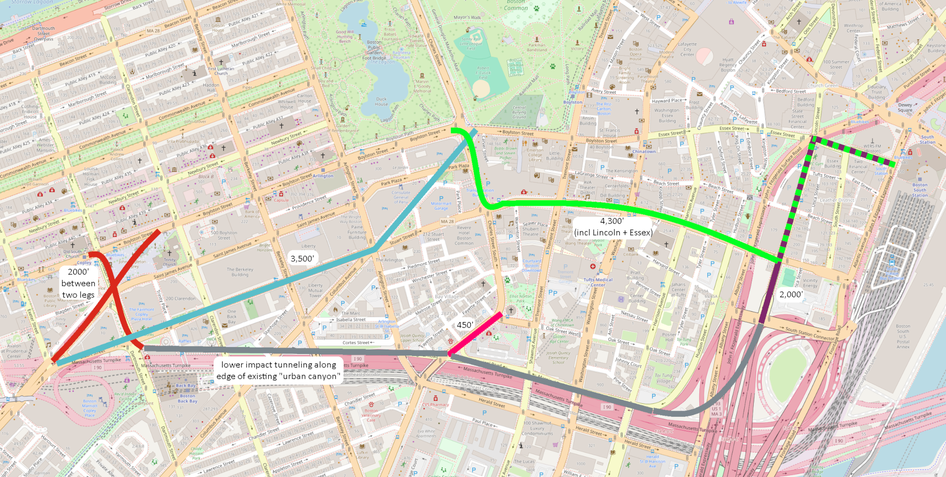

Something similar to this has been mentioned in my 2x2 plan (posted again here for convenience):
artboard-2-02-png.60823
Specifically, the N bullet (Magenta Line) basically does what you said -- except that I have N trains use Huntington Ave subway until Copley, then build flyovers for it to converge to the Kenmore-Seaport trunk (Silver in my diagram).
I don't think there's an inherent need for quad-tracking Symphony-BBY, if the goal is solely to run the Magenta route -- 4 tracks are nice but far from necessary. The capacity pinch will always be at Park-GC, not Symphony-BBY, as long as your Nubian-Tremont trains (my Gold Line) + Huntington-GC trains that don't short-turn at Park) >= Huntington-Seaport trains. Quad-tracking Symphony-BBY helps with reliability (and possibly speed if you're willing to build an express/local setup), but even 2 tracks here will always run under capacity.
A separate question is maintaining a surface connection from Huntington to Heath St, but that's not at odds with 2 Symphony-BBY tracks: you can have the "underground to BV" and "surface to Heath" tracks branch out anywhere west of Symphony.

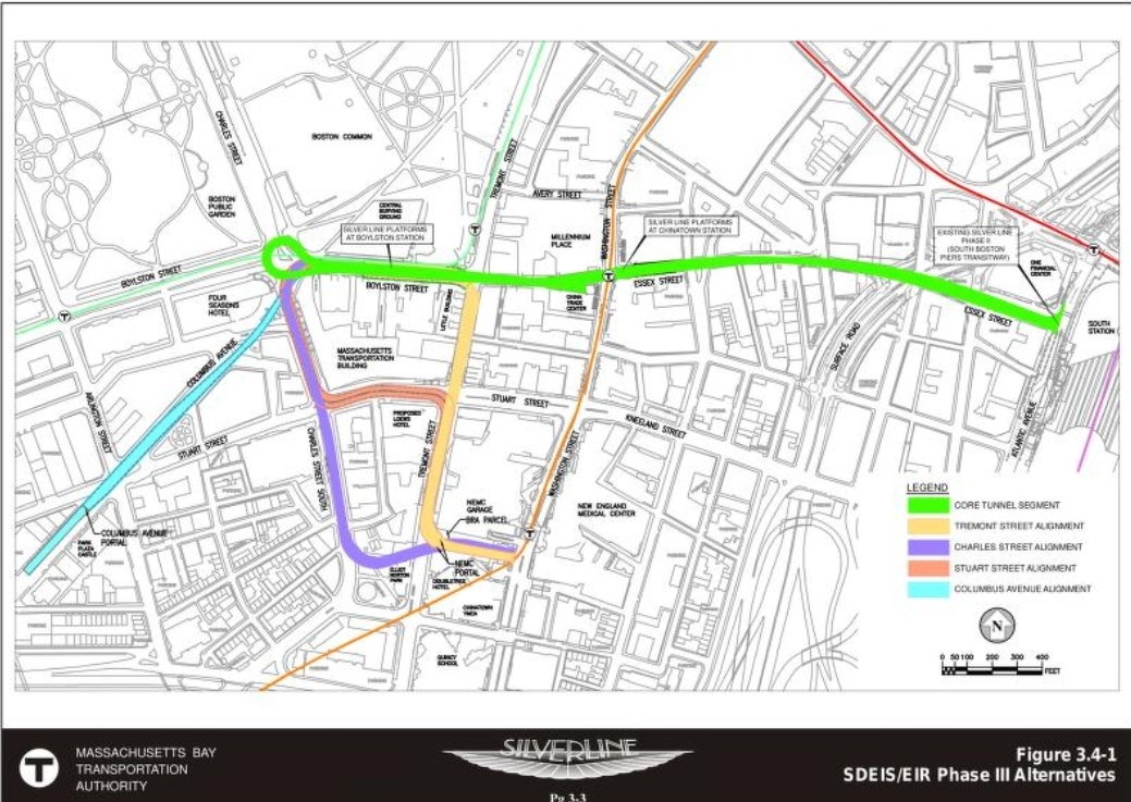

Silver Line Phase III was going to be routed under both Boylston and Chinatown stations.
That was the plan for the Post Office Sq extension too. You can see the elevation chart at the bottom, it would pass below Boylston and Chinatown, but above the RL tunnels. Which is why I'm asking if maybe the difficulty of SL Phase 3 has been overstated, if the plan was to do something very similar in 1913.
...and under the GL tunnel from Boylston Station to Charles St. South.

Some of the proposed grades would top out at 5-5.6%, higher than the 5% recommended grade in the MBTA Silver Line specs guide and only slightly less than the 6% maximum allowable grade. Chinatown's placement was modified a couple times in the scoping to fit within these requirements.
The spirit of this plan seems identical to my 2x2 plan, in that both aim to enable all 4 connections between pairs of destinations: (Kenmore / Huntington) -- (Park St / Seaport). @Riverside also implied that while he didn't explicitly draw out the 2x2, the Criss-Cross plan should allow easy modifications to add Kenmore-Park and Huntington-Seaport tracks.
So I think there's a broad consensus on a route design level; the remaining discussions mostly concern engineering of 2x2, especially with Kenmore-Seaport.
I had these thoughts before, but my answer was no: Essex St is probably still very difficult to build, even without mismanagement.
Most challenges that SL Phase 3 faced were with the geography and topology, which remain regardless of planners:

That said... The idea of a Stuart-Kneeland St Subway is actually intriguing, and I had considered similar lines before. I'll write more about this when I have time.
I would generally agree that Essex should be looked at again as a GL option. A few months ago I was looking at the 2005 EIS; What struck me from it was that the "core segment" from Boylston to South was well settled, engineered, and appeared buildable. However, there was considerable controversy about the portal alignment. Keep in mind that this was Phase 3 of the SL - it was the central segment meant to connect the Phase 1 Washington St surface running to the Phase 2 seaport tunnel - it was absolutely implicit and required that SL buses had to have a place to enter the tunnel. Look at the proposed alignments - that Tremont St routing, would have required a bypass tunnel to enable buses to "double back" along the core segment alignment in order to reach the initial portal location on Washington, built in the literal middle of a hospital, then NEMC.

The grades at the portals were absolute crap. 5.6% for the Tremont portal, 6% for Columbus (I'm not even sure why that one is so steep given the straight runup space). They were totally flailing by this point, and that's where the project started slowly coming unglued to its ultimate demise. The reasoning for the 5% "recommended" grade was that the traction motors in the buses would've had to overpower at >5%, shortening component lifespans on a captive fleet that had to make those grades every single run. Up to 6% was tolerable if T maintenance could keep up with the extra component wear-and-tear...while above that you'd simply be shorting out the motors from the power surge. It wouldn't be any better for BEB's because the traction motors are identical and they'd also have to overcompensate for the added weight of the battery bulk.

The core segment, including its turn back loop, was 3000ft. Each of these portal routings would have added another 2000ft, and with their curves? No bus was going to be able to navigate it with any sort of speed or efficiency. It would also have encountered considerable underground complexity resulting from crossing the surface.
To me at least this says to me that most of the challenges of Phase 3 were the link to Washington St, and the correspondingly complex Boylston station. If you can just, not do that, suddenly it looks way more doable.

The portals were the sticking point that ultimately killed the project when the FTA withdrew its "recommended" rating, but a whole lot of damage was previously racked up to the budget by trying to fit the core alignment. Yes, you could recycle it for LRT on the grounds that it's "proven engineering-feasible", but would it still be worth it at the going price and with underpinning work yet to come to tie it into the Public Gardens junction? Not exactly clear-cut.
It landed where it did with that awkward offset stacked tunnel because that's the only configuration that would fit within the 5% recommended grade. I doubt you're going to try to steepen it for LRV's because it's still a performance hit. And between-block would mean you're adding complexity with the long walkways (and added transfer penalty) to each station stacked onto the same narrow footprint.

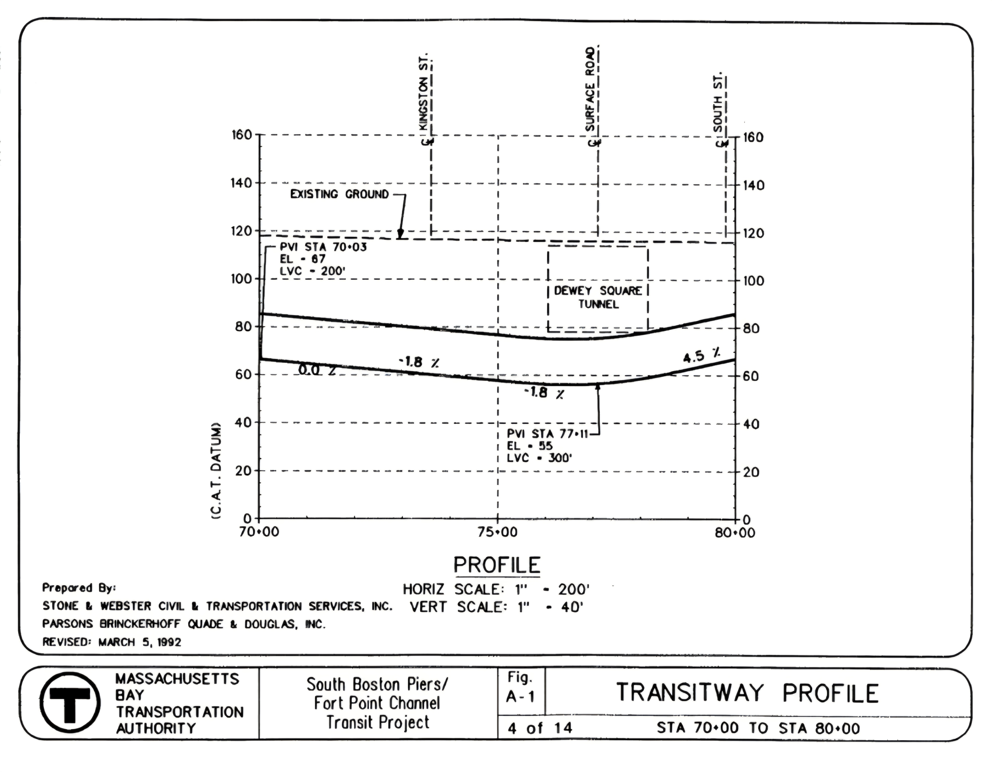

At surface road, it's apparently just barely below the surface, so you'll have to go under.
(Worth noting this section is from 1993, so while accurate for the segment being discussed, at the time they were actually proposing an Ave Lafayette & Avery routing with Chinatown platforms underneath Hayward.)

That's probably not going to be possible. The '05 EIS frustratingly doesn't include a total width measurement for stacked Chinatown, but it does offer one for almost identically stacked Boylston: 45'4" from outermost concrete wall pour to outermost concrete wall pour (meaning, subtract at least a few total feet's worth of concrete to net playable space). At both stations the egresses were contained within the pour without jutting outside because of abutting building foundations, which likely constrains you to a center-island platform because of the need to consolidate the egresses instead of having double on each side. You're allowed a minimum of 6 feet platform width before the nearest obstruction (seat, signpost, trash can, etc.), with the T coalescing on a 9-ft. minimum for new-construction side platforms. Center islands with egresses in the middle typically run 20 ft. (East Somerville) to 25 ft. (Union Square, most Orange Line-north stops) to as large as 35 ft. (Lechmere, Wollaston, most Orange Line-south stops), and of course they'd need to be larger the busier and more transfer-oriented a station is.
Take the walls, the tracks, the egresses, and the minimum-most platform allowances and you're probably scraping the limit. Take a platform allowance worthy and more or less required of a busy transfer station, and you're easily exceeding the limit. I'm reasonably confident that even an LRT do-over would be required to do stacked platforms at Chinatown for the platform accommodations to be in any way worth their salt at moving people.
That said, one additional consideration to be given to configuring and underpinning these new platforms is that LRT doesn't need as much extra volume as buses do. The existing SL and proposed phase 3 tunnels are 15ft (12ft lane with curbs) wide for a 8.5ft wide vehicle because it's an unguided busway - they needed the extra space to accommodate the vagaries of a human operator driving a bus. It's why they had to eliminate the alt of reusing the Pleasant St incline for the portal fairly early. Conversely, as the green line is railbound, it's standards are written such that it only needs 6in of running clearance from walls / other vehicles - as of GLX specs, it had 12' of horizontal clearance preferred, 11' min. As such, much of GLX's corridor was built spaced to 11'6" on center. That cumulative 6 feet saved might ease fitting both platforms on a single level for Chinatown.
@Stlin, thanks for digging this out! If you have the link to the 1993 doc handy, I'd love to look. (I found one document from '93, but I think this may have come from the appendix, which wasn't included.)
@Teban54, I think this might actually answer our questions about Lincoln/Essex/Surface Road: if I'm reading this right, the Transitway tunnel would have just fit under the highway... which means that space under the highway is available for the curve:
My concern had been about fitting the curve between the Lincoln Plaza building and the wall of the tunnel (broadly indicated in dark red above). But if it's feasible to use the space underneath the tunnel, then you have this wide open area (blue highlight) to work in, allowing you to "swing wide" (illustrative range indicated with yellow hashing) for the curve. And, as I've tried to indicate, you don't actually need to swing that wide -- we just need a little bit of wiggle room to ensure a reasonable curve radius.
But, if that curve works, then I think there's a pretty viable plan overall there. Marginal Road -> highway spaghetti -> Lincoln St -> Essex -- that's definitely not bad.
Post Office Square Redux/Essex St Subway etc: I know I said this already but I think it does bear repeating: in order to use all four tracks at Boylston, the point where your "Post Office Square" services branch off also needs to be (broadly) where your Huntington services join the Boylston Street Subway. If your divergence point is somewhere around Charles St (i.e. the extant provision for the Post Office Square extension), then you also need to build a way for Huntington services to get from Prudential to Charles St, which balloons the scope significantly. Criss Cross via Lincoln St limits tunneling to Copley Square proper plus one block south, Lincoln & Essex Streets (above), and alongside the Mass Pike (where impact will be less than almost anywhere else).
For comparison, here's how much of the "neighborhood street grid" would need to be torn up for different segments:
  • Lincon + Essex: 2,000 feet
  • Copley (plus a block on Dartmouth and Huntington each): 2,000 feet
  • Tremont St between Marginal Road and Elliot Norton Park (needed for Tripod): 450 feet
  • Charles St + Stuart St + Kneeland St + Lincoln St + Essex St (for Kenmore <> Seaport): 4,300 feet
  • Stuart St + Columbus + Park Plaza: 3,500 feet
I'm not counting the segments along the Mass Pike because they are significantly less disruptive (especially since a large fraction of the segment along the Mass Pike actually has no direct abutters to the north).
Criss Cross would be 4,000 feet of tunneling, plus maybe another 450 if we want the extra flexibility of that connection. Using Stuart + Kneeland is almost twice that, at 7,800 feet (and along major roads). For comparison, Herald St to Nubian Square along Washington St is about 8,500 feet.
Insofar as political capital for disruptive tunneling is both finite and fungible, I'd rather spend that capital on something like the Nubian Subway.
I'll get to the (excellent discussions of) SL Phase 3 engineering details at a future date, but just a quick nitpick on a particular point:
An implicit assumption of your "4,000 vs. 7,800" is that you get the Marginal Rd subway for free (Back Bay - the Highway Interchange District), or that it's already built.
Technically -- I repeat, technically -- the Marginal Rd subway doesn't need to be built. One can imagine a Criss-Cross or even 2x2 setup that mostly tunnels under Stuart-Kneeland:
  • Huntington - Park Inner: Uses Stuart St - Columbus Ave - Boylston St (your teal line)
  • Kenmore - Seaport: Uses Boylston St - Charles St S - Stuart-Kneeland Sts (your light green line)
  • (Optional) Huntington - Seaport: Straight on Stuart-Kneeland Sts
  • (Optional) Kenmore - Park Inner: Straight on Boylston St (Central Subway)
There are multiple issues with this plan (most notably: likely greater tunneling cost, surface disruption, engineering challenges of the interchange, and difficulty of placing transfer stations). But it has some distinct benefits that are sometimes underappreciated:
  • Shorter tunnel distances overall, if Marginal Rd subway is not built
  • Shorter route for Kenmore-Seaport trains, due to much less "southward deviation"
  • The route feels more "central" than following the Pike. Obviously it depends on station locations, but the entire Stuart-Kneeland alignment is much closer to jobs, shops, restaurants and hospitals than Marginal Rd.
With that said, I do think that having Kenmore-Seaport trains run Copley-BBY-Marginal will still turn out better, mostly due to easier and less disruptive tunneling. But involving Stuart-Kneeland in some capacity has its own merits that are worth considering.
Sure!
There's a couple of these; they're identically titled and dated, but are in fact different.
Less detail:
More detail:
