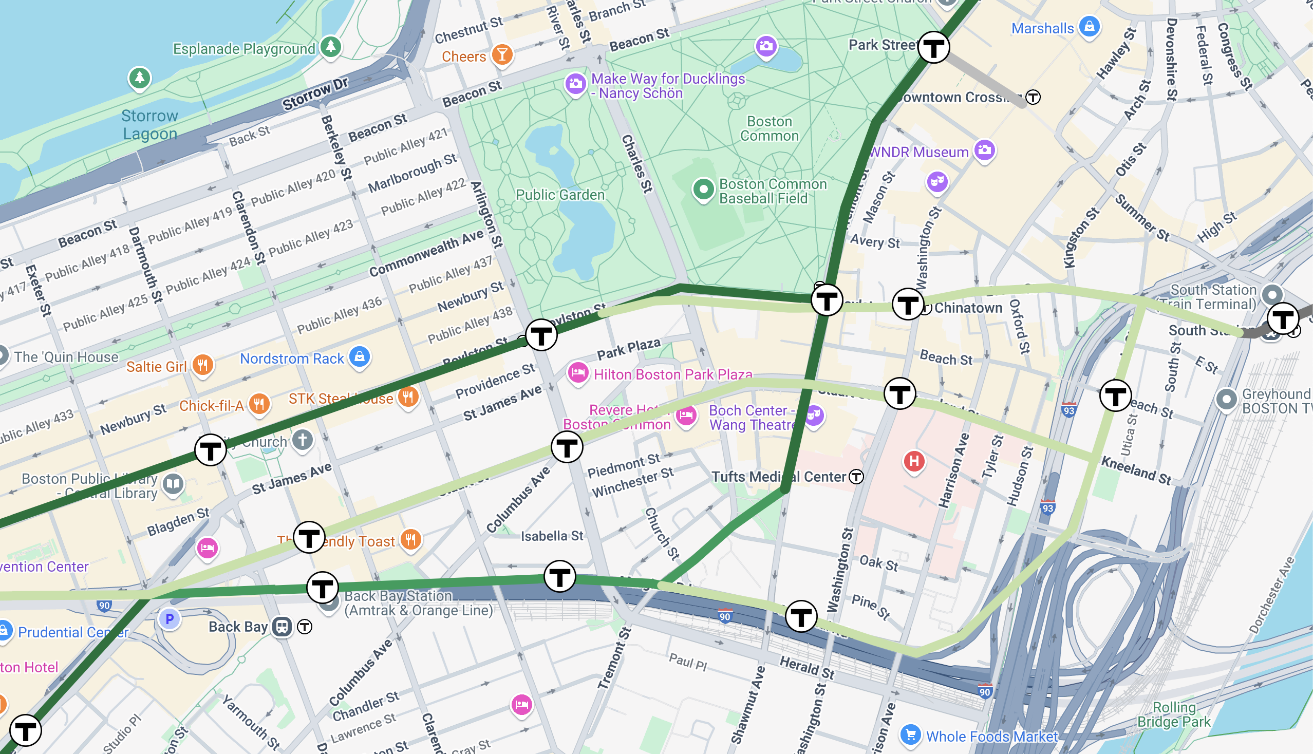

Map for visual aid.
I'd update the comparison between routing options for the Seaport Connector to look something like this then:
| Full Pike Hugger (Pike+Lincoln St) | Essex St | Stuart/Kneeland | |
| Total "Narrow street" new construction length | ~1500' (Kneeland St to Essex St to Atlantic Ave) | ~2900' (Tremont St to Atlantic Ave) | ~1500' (Kneeland St to Essex St to Atlantic Ave) |
| Total other construction length | ~2600' (Tremont to Lincoln under Marginal Rd/Hwy interchange) + ~2500' (Hynes to Back Bay, Huntington Ave subway to Tremont St portal not included in length) | ~1300' (The wider part of Boylston St, Hassadah Way to Tremont St) | ~5500' (Stuart/Kneeland Subway) + ~2500' (Hynes to Back Bay) |
| Total New Construction | ~6,600' | ~4,200' | ~9,500 |
| Total Length from South Station to Hynes | ~10,100' | ~9,300' | ~9,700' |
| New Stations (Assuming Huntington-Tremont St connector) | 2 stations, 1 expensive one | 1 very expensive one | 3 stations, at least 1 expensive one |
| Transfers | Same or cross platform to all other GL services, OL at Tufts with ~60-90s walking | OL at Chinatown with ~60-90s walking, other GL services at Boylston with 120-150s walking | OL at Back Bay with ~90-120s walking or at Chinatown with ~90-150s walking, GL at Back Bay with 60-90s walking. |
| Station Locations | Avoids downtown for the most part, Chinatown Gate is a mediocre alternative. | Basically as central as you can get | Slightly further than existing stations but overall okay |
| Service to Seaport from... | Kenmore and Huntington | Kenmore Only | Either Kenmore Only or Kemore+Huntington if a junction is built before Back Bay. |
| Big uncertainties |
Based on this I'm quite tempted to just strike Stuart/Kneeland entirely. It really just seems like the worse of both worlds (except for station placement, which is pretty good.) There's also the Prudential issue.
In terms of the 'Full Pike Hugger' alignment, the big scary thing for me is the tunnel under Prudential Center. The parking garage in particular seems like it may lie directly in the path of any tunnel there. If that's not an issue then we're back to discussing the merits of costs vs station locations vs transfer quality vs crowding etc etc.
