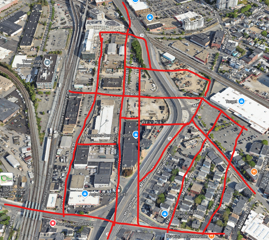

Dead-end the highway where it meets Broadway near 93 to cut off the traffic, and convert to local roads around the station, with no direct route from one side to the other. Somerville Ave is a beautiful street and then you get to target and you're just in hell.
This makes me realize that the GLX has sort of permanently sealed ofoff the inner belt in some ways.

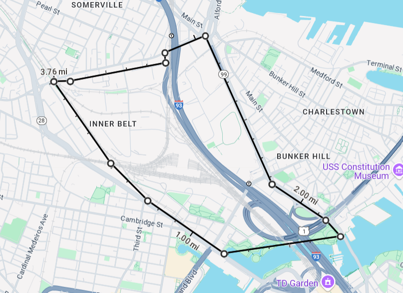

Almost all of the Inner Belt area was nothing but rail yards and associated industry until the late 20th century. Basically this entire area:
There were a few small residential streets on the south side of Washington, but that's it. Everything else was originally Miller's River, associated swamps, and Asylum Hill. The swamps gradually got filled in for rail yards and industry. Not until the 50s and 60s, when the Boston & Maine sold off the northern part of the yards, did it see non-rail industry. BHCC was built in 1973, and the Cobble Hill Apartments around 1980. While the isolation is not a good thing, it's an area that has never had proper street connections to the surrounding area.
Interestingly, the Brickbottom area (between McGrath and the GLX) was originally residential. It was already beginning to convert to industrial when the McGrath overpass was built in the 50s, and all residential was gone by the end of the 60s.
It's one of those netherworld areas like West Cambridge (west of Alewife Brook Pkwy and north of Concord Ave). For areas like these, 75 years ago a connected street grid should have been laid out on paper and some land use planning done along with that. But instead it's just been haphazard infill.
This needs to be done across the entire country, everywhere. Not sure when were going to figure this out as a country. The DC suburbs should look like chicago, instead they look like raleigh.

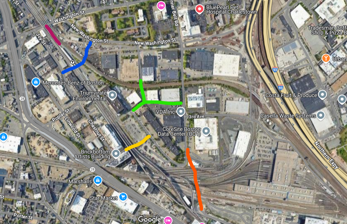

I would argue that the Inner Belt shouldn't be the highest priority for that. The southern half is sandwiched between two elevated rail lines and a rail yard, none of which are going away. The northern half is between an elevated rail line and a semi-active freight rail line. Street connections to the south and east are difficult to impossible. It's as good a location for light-to-medium industry as there is in the urban area, and that doesn't need as complete of a street grid.
That said, there are some improvements that can be made to connect it to other areas, especially to allow employees to reach the businesses:
Those connections are exactly what are needed. No one expects a perfect street grid in a historically carved-up area like this, but a connected network of streets and paths that works with the man-made topography is feasible, and is what you're showing here.
