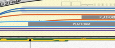

You physically cannot have a switch next to a high-level platform. Any train making the diverging move (using the orange track) will hit the platform.
A correction: it is physically possible - here's a (rare) example at New York Penn:
But you have to move the platform edge back, and thus deal with a larger gap, to make it work. Maybe worthwhile in rare cases like Penn Station where you need the flexibility, but absolutely no justification here.

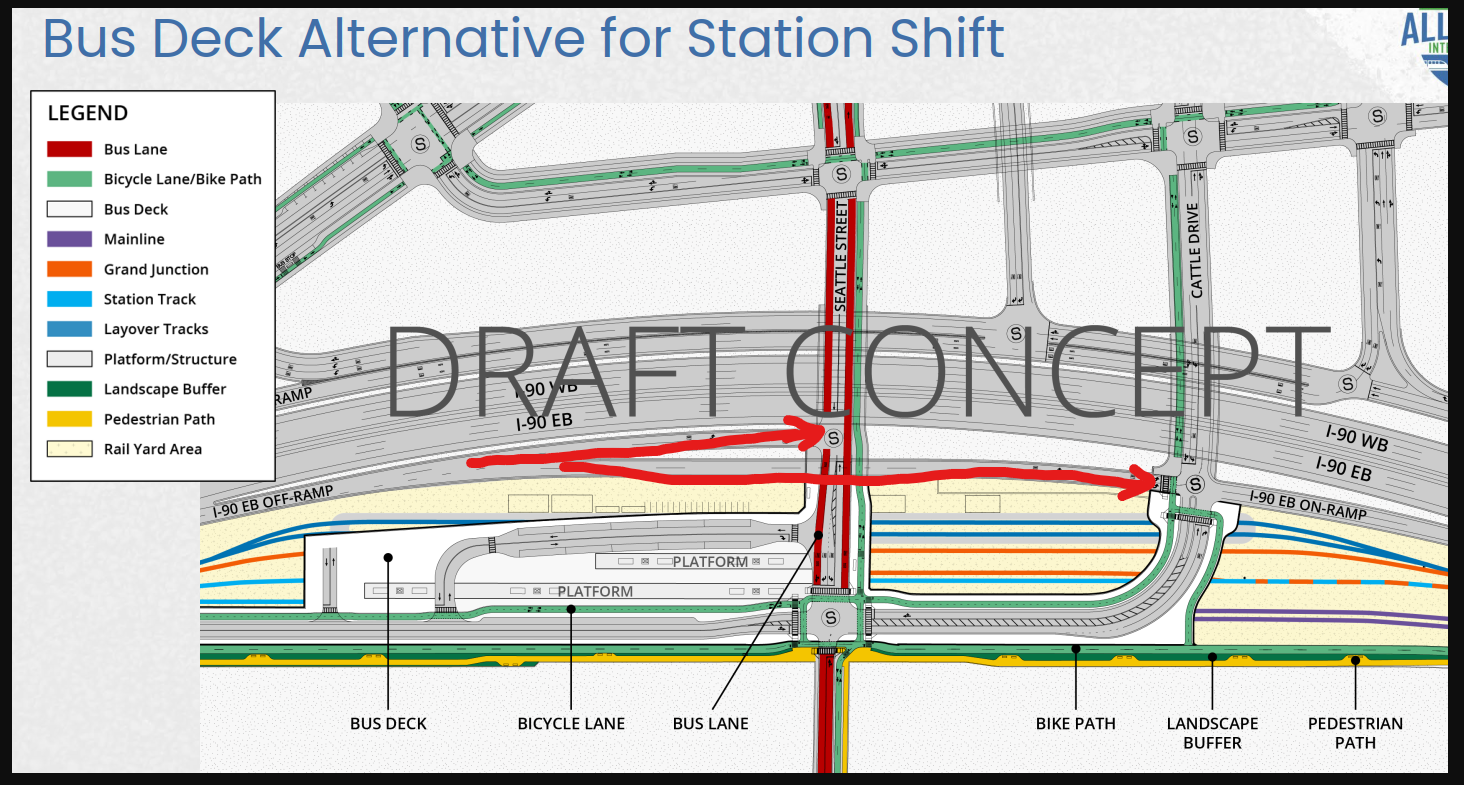

Wait a minute...I wasn't even paying attention to the new renders of the upper level. Somehow those wasteful busways increased in capacity from 6 to 10 simultaneous bus berths in the latest redesign.
Before:
After:
Again....the only buses that are actually going to use that piggish waste of space are 3 private jitneys: a Ruggles/LMA shuttle, a Harvard U. shuttle, and a Kendall shuttle. No MBTA routes (the 64 stays on-street). No general-public boarding...only open to member institution passholders. 3 jitneys that couldn't hope to saturate 6 simultaneous berths with their frequencies now can't hope to saturate 10 simultaneous berths with their frequencies. And the jitney circulation seems to have gotten a little bit worse with the flip of the deck from the east side of Seattle St. to the west.
What are we even doing here??? 🤮
Just because there aren't concrete plans to run MBTA busses through here doesn't mean it won't happen. I'd be stunned if the 64 and 66 weren't rerouted through West Station once it's built, and it is well within reason for even the 57 to get diverted. Also, the highway reconfiguration will likely last for generations, especially if the decking plans go through. Who knows what bus demand or service will look like 50 years out, and building some extra capacity now is completely reasonable.
Do I think that's why the bus deck is getting built? No, this is almost certainly being done at the request of Harvard and business groups for their shuttles. Even if MassDOT is doing this for dubious reasons, a broken clock is at least right twice a day. Does that justify 10 berths? Probably not, but it certainly justifies some.

No, it's not. Not when the project is literally DROWNING in cost overruns and design decisions that don't fit. The excessive bus berths are just ONE symptom of the chaos that is threatening to tank this project. The whole station is going to need a serious VE'ing at both the upper and lower levels to work at any cost worth paying. When so-called "reasonable" extra capacity is a key contributor to netting a project that can't be built in any form, we all lose. The whole works is teetering on the brink of collapse. To un-teeter it, you must right-size. 10 berths vs. the still-excessive 6 in the previous render is going further in the wrong direction and pushing it ever harder towards collapse. Do we want a station that's usable in our lifetimes? If so, we have to rationalize some of these nonsensical decisions with...sensical-er decisions. Stat!
Harvard and the business groups can feel free to submit their service plans and future growth projections for using all the berths if they are "requesting" so many of them. They have all failed to do so. Based on route profiles of Harvard's other shuttles, the LMA shuttles, and the MIT/Kendall-institution shuttles...the math didn't add up before for 6 simultaneous berths, and that's all the information the state had for guessing at the number of berths. It didn't add up for 6, and it damn sure doesn't add up now for 10. So how many does it truly justify, so we can save this imploding project with a proper VE? Do any of the stakeholders even care enough to say? Doesn't appear so.
My guess is there's envisioning many private shuttles to Harvard/Kendall areas as well.

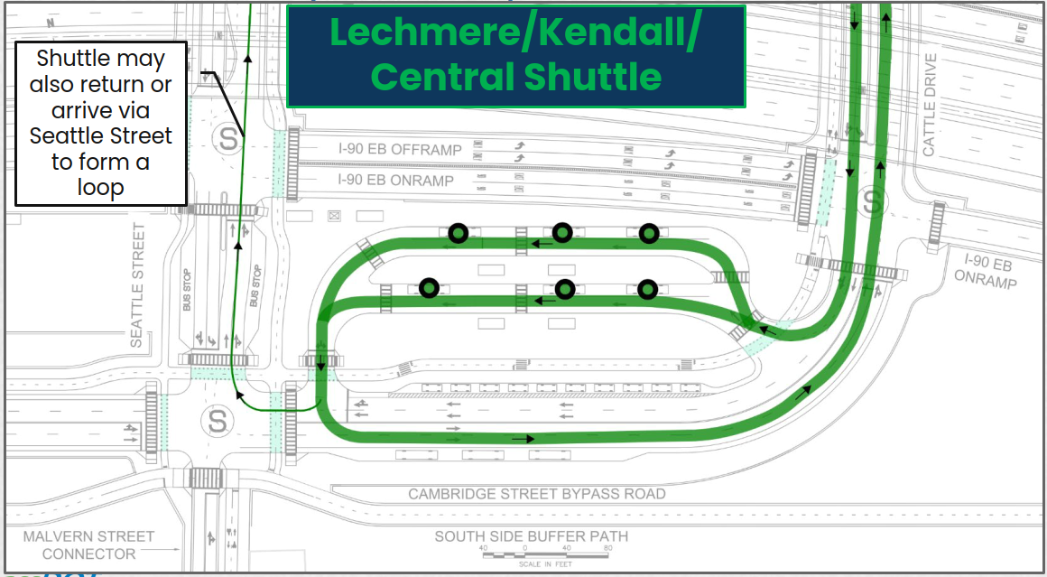

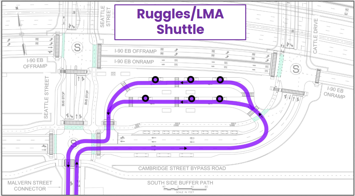

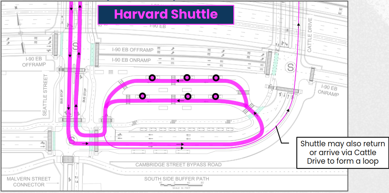

It's not "many" private shuttles. It's 3 routes:
  • Harvard campus shuttle, for Harvard I.D. holders
  • LMA campus shuttle, for Longwood Collective I.D. holders
  • Kendall+Lechmere shuttle, for MIT I.D. holders and a so-far unspecified (Charles River TMA???) Kendall biz collective
That's it. The state's project documentation doesn't even attempt to quantify the frequencies of said shuttles, nor quantify any other use of the bus berths like the extremely unlikely event that Mass Pike coach buses would rather stop here in addition to/instead of expanded South Station Bus Terminal. The 6 previous berths and 10 current berths are merely a crayoned wild guess unsupported with evidence.

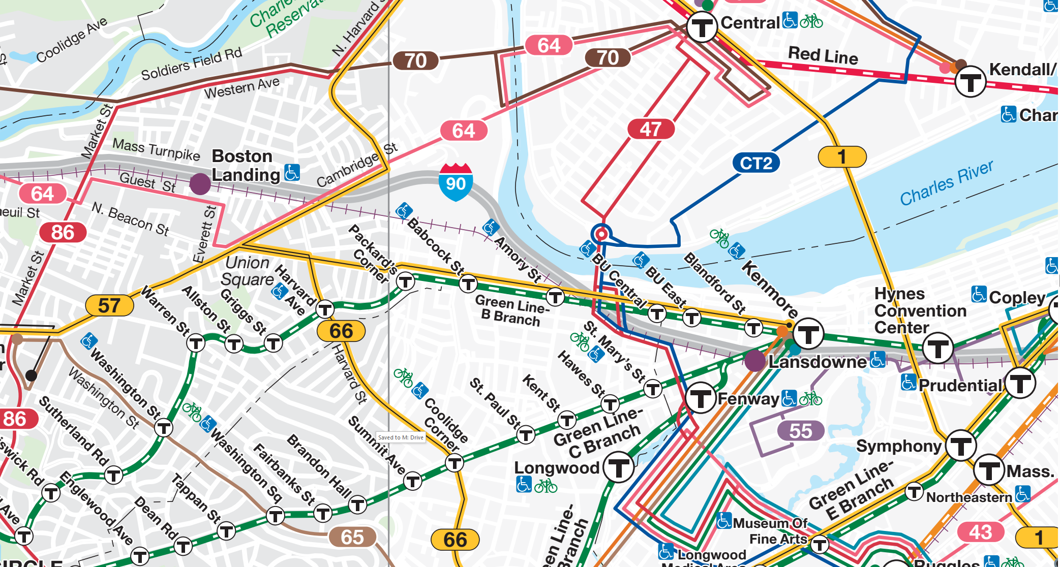

Shouldn't Lansdowne be the station for LMA shuttle connection?
And Kendall should be LRT(as well as Harvard Sq IMHO)
Harvard seems to think that the functions of what they build there will have a built-in audience for a one-seat instead of two-seat to the LMA. And that's a reasonable assumption if what they build there indeed does (biotech?), because it's not that long a route and should have decent schedule adherence despite the constipated BU-side grid it has to traverse. Of course, Harvard isn't saying publicly what it wants to build there so that's a problem...but it doesn't mean they don't have an idea privately. I doubt it would have particularly dense frequencies compared to other LMA jitneys like the Harvard Campus-LMA ones, but if the demand projects there it definitely has its place in the mix.

On another note....

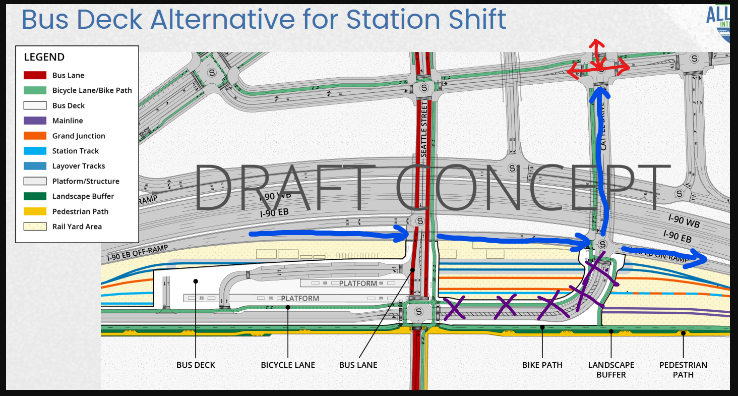

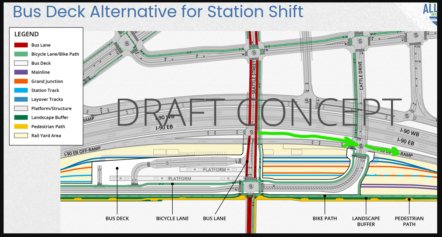

Another thing that is driving me nuts about this is the use of two separate off ramps for Seattle Street and Cattle Drive. Is there a massive grade change that I am missing in between these two streets? They connect at the four-way intersection so why not just provide a single collector/distributer road to allow seamless exit/entering of the Pike to the Street grid?
I would go as far as saying to delete the entire "deck" for Cattle Drive and make it a one-way street from the proposed collector up to the first east/west road of the new grid layout. IF there was a direct connector across the train ROW, maybe just a pedestrian/bike connection (straight connection to cycle track on Cattle Drive).

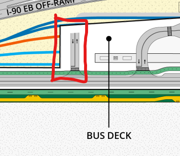

Lastly, can someone fill me in on what this seemingly random curb cut is at the western end of the bus deck? Am I missing something in the slides that would have parking here that this is providing access to?
Looks like it's supposed to be an access road to the layover yard below, given that there appears to be pavement on the ground level continuing from the same trajectory after the deck ends. Though I have no idea how it descends below-deck because there's nothing but station tracks underneath it. It would have to practically drop out of the sky to reach the layover in time. Probably another design FAIL they'll have to revisit with another iteration because it's physically impossible. Endless change orders are a great way for contractors to skim more sweet MassDOT cash, no? Helps also when the state employees overseeing the project have no @#$% idea what they're doing and are choking on the bigness of it all.
