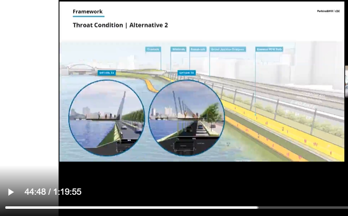

Many advocates are very interested in the possibility of elevating some or all of the paths. We even worked with CBT and Perkins&Will (who very generously did an award-winning pro bono design project with us).
https://www.abettercity.org/news-an...ign-exploration-with-cbt-and-perkins-and-will

The trees look pretty in the renders, but there is almost zero chance of them being healthy enough to grow beyond little saplings.
