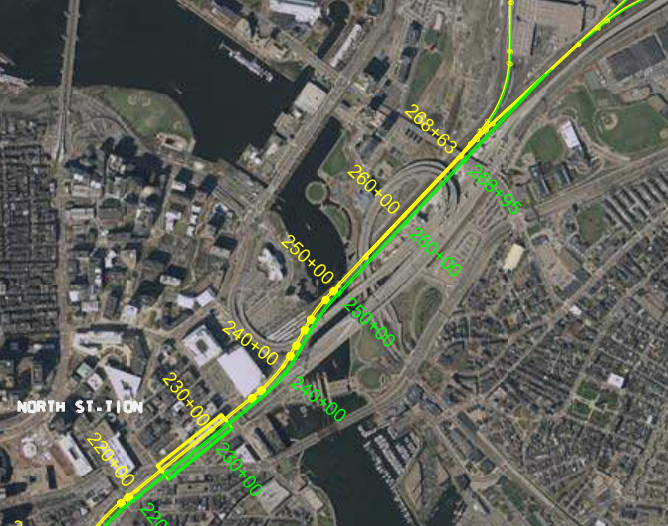

The switches visible north of North Station (from here, page 24):

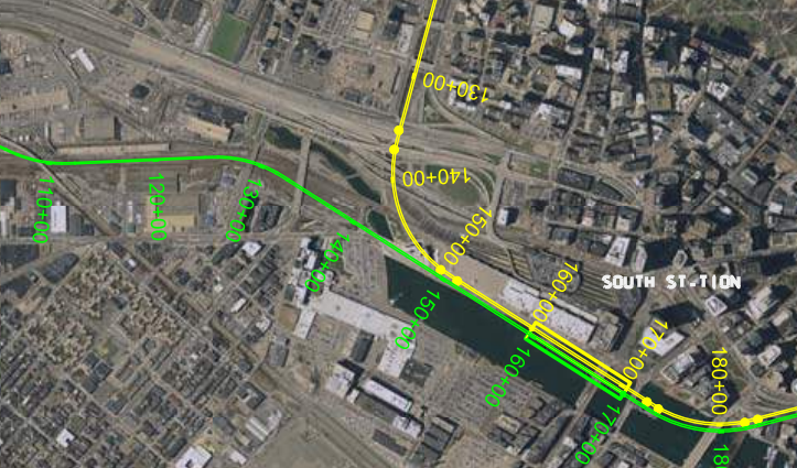

No connections shown at South Station:

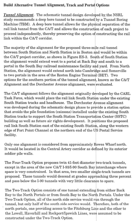

And in fact the 2003 study (page 14) specifically calls out the constraints of the area where such a junction would need to be:
"The Four-Track Option proposes twin 41-foot diameter two-track tunnels, except in the area of the new CA/T I-93/I-90 South Bay interchange where space is very constrained. ... These tunnels would descend at grades approaching three percent and pass below the I-90 tunnels with very little clearance to spare."

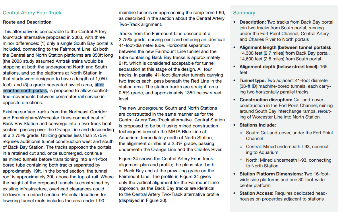

From page 23:
The four track alternatives provide capacity, and access to a South Bay portal, but I don't see anything that would point to them providing redundancy.
From page 23:
"A grade separated switch area, at or near the North Portals" implies being able to move trains to or from each line.
