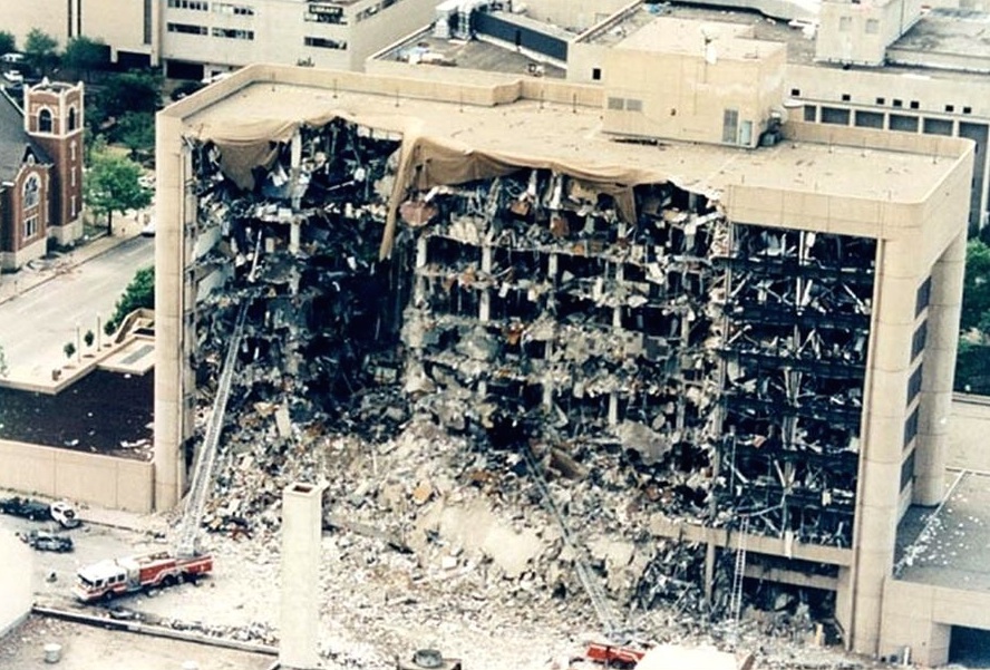

You have to understand they aren't hard and fast requirements either. From the paper that stellar linked to about the replacement OK city federal building (with much more stringent requirements than this has)
The new requirements include a recommended 100 foot building setback to create a safety barrier between the building and potential detonations in parked cars. While Murrah was nine stories high, the tenants insisted that the new building have only three or four stories. Based on further studies, discussions and test data from blasts, it was decided that 50 feet would be adequate in order to maintain a safe perimeter at the south, east and west wings Since this is half the setback recommended by the government, to account for the remaining 50 feet required by the guidelines, parking is only permitted along the far sidewalk, away from the building. GSA also requires that vehicular drop-off lanes be no closer than 20 feet from the building and that there be physical obstructions to maintain this distance. In response to this, the architects incorporated bollards in the design to create a ceremonial gateway into the site. Bollards will also run around the entire perimeter of the site but will be hidden in tall, native prairie grass.
There is currently no parking on Binney or Third, and Monroe could be made into a restricted access street.

Handbook of perimeter security design.
http://www.fema.gov/media-library-data/20130726-1624-20490-0371/430_ch4.pdf
It is not enough to simply prohibit parking, physical barriers preventing such are necessary, even if these take away street lanes (or streets). For example:
