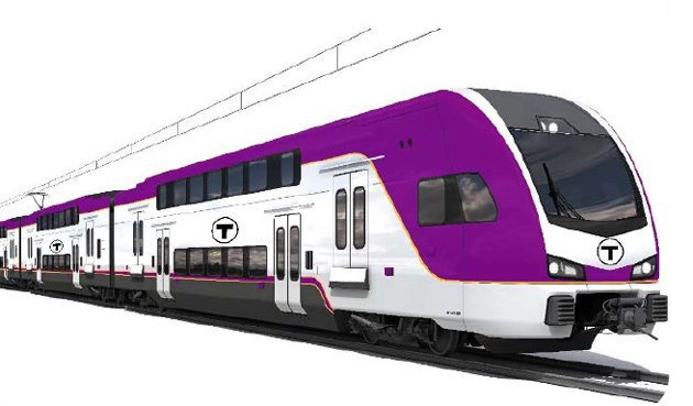

This new electric bus would add a new style to the bus line! :)

Yeah, I thought that it may be modified, possibly to suit the needs of the MBTA. Time will tell. :unsure:

The way that the doors are, looks like this train could be used either way.
The way that the doors are, looks like this train could be used either way.View attachment 18484
I'm not sure why there are two threads on this, but I'm happy to reiterate the gist of my post from the other thread where this was discussed for anyone who missed it. That's a Stadler KISS, specifically a lightly-photoshopped (into MBTA colors) rendering of the version being built for Caltrain. The California trains have the weird double sets of doors because they need to work with a.) California's standard 8" low platforms and b.) California HSR's unicorn 50" high platforms. Our high platforms are 48", and per the T's own RFI presentation the California KISS is not as-designed compatible with our platforms. The lower doors are irrelevant for our discussions because they can't be used at high-level platforms including the downtown terminals; without high-level doors compatible with our platforms the cars won't work at all. Presumably Stadler could modify the design for 48" platforms (I don't know if that'd include adding traps for the low platforms, or just keeping the low-level doors), but the word from on high is that it is not possible to just import California-spec KISSes because they're not compatible.
(And with respect to what would seem like a straightforward modification, there's the question of whether it's as straightforward as it seems like it should be, and, not necessarily relatedly, whether Stadler will do it, and do it at a price point to make these competitive with other options that are native-compatible with our platforms. Probably yes, but we'll have to wait and see.)
Well, all I know is that the MBTA has both high & low-level platforms for stations I don't think that they are going to raise the low-levels to high. They are not going to spend extra dough for that. So I think that they would have to come up with something. Amtrak has the same thing, but their trains can use both levels. Their cars have stairs that can be let down for low levels. Also, the new Siemans passenger cars (which they might get to replace the Amfleet 1's) can also do the same thing. But those cars have different ammenities & they are for long-distance traveling, either out west or on the Eastern Seaboard. But I'm pretty certain that they'll figure it all out. :unsure:
Amtrak's single-level fleet (with the exception of the Acelas) and all of the MBTA's equipment is equipped for 48" high platforms as well as low platforms (via the stairs and trap doors). There's basically no chance that the T is going to raise all of the platforms to full-high anytime soon (at the pace they've taken with the CR, it could be decades) but certainly not before the next order of cars, meaning that compatibility with low platforms is mandatory.
The T, I should make clear, understands this. The reason the T's own presentations marked the California KISS as incompatible was because the high-level doors were designed for higher platforms than our 48" platforms. There's no rocket science involved here, just technical discussions of whether and how certain vehicles meet the requirements. The unanswered question for the California KISS at this stage is how easily it could be adapted to our platforms; it'd have to have one of either 48" platform doors with traps and steps (this is what all the T's current equipment has) or a combination of low and high doors (which is what the California KISS already has, just that the high doors are a few inches too high). It could be as simple as slightly lowering the high doors to make them compatible, we simply don't know because the process hasn't got that far.
