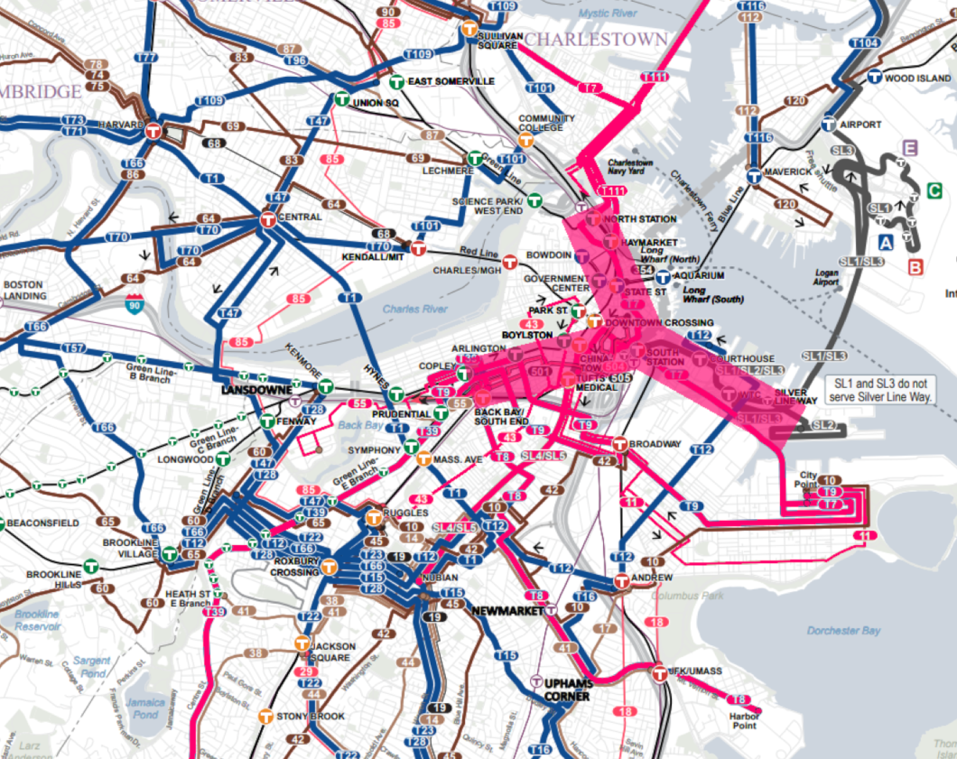

I decided to take a quick look and see what routes I would actually include in this "Inner Belt" radial network, and came up with something like this:
The general thinking is "routes that do not travel beyond the 'Inner Belt' of transfer stations like Maverick, Sullivan, Kenmore, Ruggles, etc, and which point toward downtown". I think the list comes out to:

Anyway, the reasonable transit pitch (which I believe @The EGE originally suggested some time ago) is a network of busways in downtown and Back Bay that would allow these routes to through-run with stronger reliability, and would form better links to the Seaport from Downtown and Back Bay:

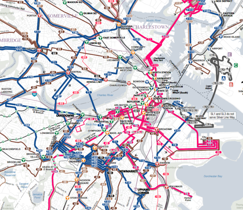

I've made a quick map of a proposal for a downtown bus lane network. I'm sure I've missed some routes with potential or have been perhaps a bit overzealous in some places, feel free to suggest changes.
Here are the major corridors I have right now:
  • North-Southish (B1): Brookline Ave to Charlestown via Longwood, St Alphonsus*, Tremont*, Malcom X, Nubian Station, Washington, Kneeland, Atlantic/Surface, Congress/Pearl, and N. Washington St
  • East-West (B2): South Station to Back Bay via Atlantic/Surface, Kneeland/Stuart, Charles, and Boylston
  • Northwest-Southeast (B3): Mass Ave and Southampton
  • Back Bay Loop: Dartmouth, Columbus, Clarendon, Boylston
  • Seaport Loop: Summer, Drydock, Harbor, Northern/Seaport, Atlantic/Surface
* No dedicated lanes
Great thoughts from you both.
On a high level, I very much like the idea of a three-way downtown busway radiating out from downtown towards North Station, Back Bay and Seaport. These three are precisely what I call the "downtown clusters":

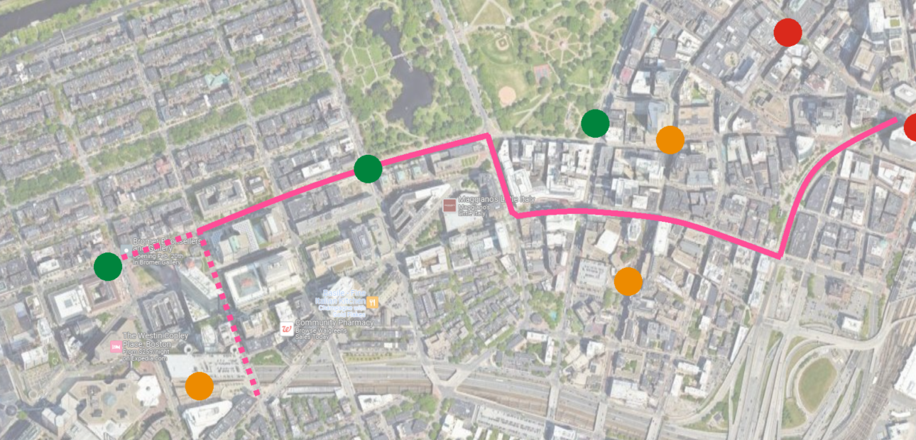

However, there's another reason why I think a Back Bay busway is worthwhile, and it's one that nobody has mentioned yet: The 50x series express buses. These routes, especially 501 and 504, are very frequent during rush hours, both right now and in BNRD:
15-min frequencies on each route (even in the face of WFH) is absolutely bonkers, especially when the BNRD gets rid of most other express buses. This means Newton Corner gets a bus every 7.5 minutes, and there's a 50x bus every 5 minutes around downtown. It's like a mini subway for Newton Corner; Watertown and Newton Corner even get some off-peak service. (The 505 doesn't serve either Newton Corner or Back Bay.) I actually feel the majority of buses using the Back Bay busway during rush hours will likely be from 501 and 504. (This also reduces the need to send the T57 into the downtown busways, as the outer T57 is covered by 501 and the inner T57 is covered by the GL B branch.)

  • T39: The challenge is that you probably want connections to both Green and Orange lines, as it gets almost equal ridership at Copley and Back Bay, but following the busway to South Station likely means giving up on one of the connections (or at least making it much worse). I guess you can still connect to OL at TMC/Chinatown from Stuart St, but it's far from ideal, especially compared to the current transfer.
