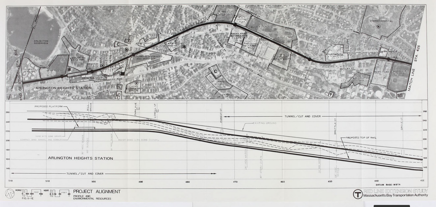

The 1975 plan was tunnel all the way. And yes, the yard (which I think was to be above-ground) was going to go on the Arlington Coal & Lumber property.
Most likely they'd keep to the 1975 tunneling plans verbatim. The only real change would be that Arlington Center and Arlington Heights stations wouldn't have the pornographic parking capacities of the very car-brained '75 plan. Both stops would probably have zero parking if done today.
EDIT: The '70s plans had the storage yard @ AH below-ground as longish tail tracks much like Alewife today. Arlington Coal & Lumber property would've been taken for the station itself so it fronted the bus station instead of putting it in Park Ave./Lowell St. triangle. See this post.
Okay a tunnel the whole way thanks. The grade change in the original study docs is very illuminating. They could build a portal at Mill St. since the tunnel is forced near the existing ground level to accommodate water/sewer pipes. But then after that the existing ground level rises 90 feet so it’s like might as well stay underground. Makes more sense now.
Another observation is the Heights station placement alongside the MBTA bus yard. If they had planned to take Coal & Lumber anyway, I’d expect the platform to be located adjacent to the west side of Park Ave vs. where it’s shown on the study. The study probably focused on MBTA/state/municipal rights of way which is why it’s placed there in the study docs.
Parking yeah Center has the existing Russell Common lot (paved paradise and put up a parking lot) so no need there, but the Heights might benefit from a residents-only lot or a small paid lot to soak up some SOV demand among the better bus connections.

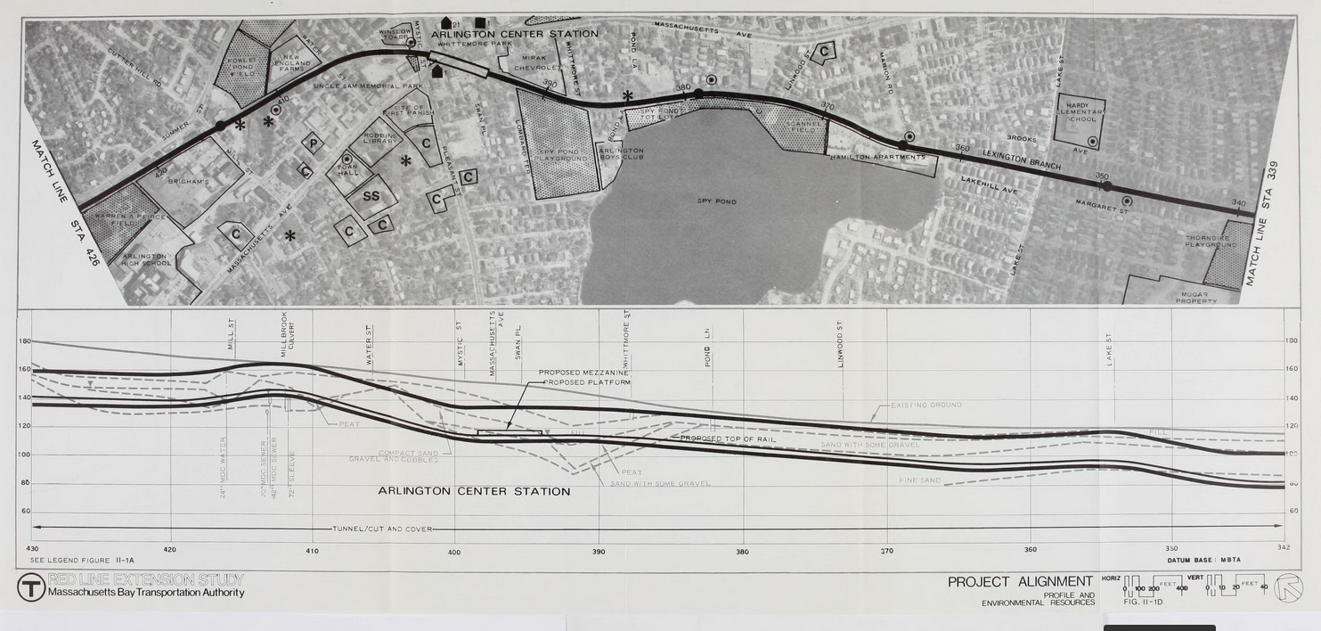

What would you even skip? Certainly nothing after Davis, so that leaves what, 3-4 possible expressed stops? Alewife and Davis are both powerhouses for ridership, if we're building to Arlington then it would be silly to skip Arlington Center, and Arlington Heights would be the end of the line. So that just leaves the hypothetical East Arlington station, and I don't see how the operational complexity 'express' service would introduce would possibly be justified by the 60 seconds or so of time savings.

Looks like a coincidence of the sand layers in the soil that the grade ends up mostly flat, such that going a couple tenths of a degree flatter would allow enough level space for a platform. But they weren't considering it at all back then. Since the grade forces the entirety of the platform to be north of the surface crossing, to do it you would need to take at least 2 houses on Lake St. and 2 on Orvis Circle to excavate the width for a station when it's all that close to the surface.
