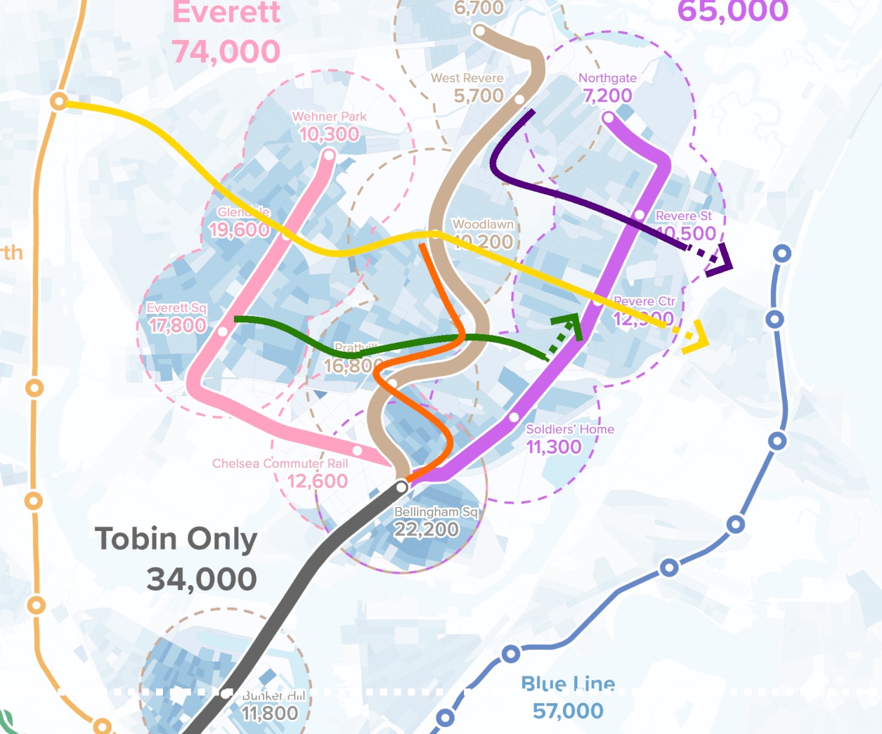

I've become convinced that Route 1 really isn't the best alignment. It's the least efficient of the three likely routes (Everett Broadway, Route 1, Revere Broadway) in terms of riders per mile, and it doesn't hit the commercial centers of either Everett or Revere. It doesn't relieve the Everett Broadway buses at all, and it only relieves the Revere Broadway buses at Bellingham Square. You're building a ling through straight residential without hitting any of the nodes.
I largely agree with you. Well, actually, I entirely agree with you that Route 1 isn't the best alignment. But, for completeness' sake, I think it's worth reframing the benefits of a Route 1 alignment, somewhat.
IMO, this actually comes back to the question of the "Lechmere Model" and the "Medford Model". Under the "Medford Model," embodied by GLX, the rapid transit service attempts to serve the neighborhoods directly, without relying on connecting surface transit, and usually employing closer stop spacing. The "Lechmere Model" (which could also more broadly be called the "BERy Model"), uses rapid transit stations as transfer hubs, leveraging surface routes to actually serve neighborhoods directly.
A Lechmere Model along Route 1, combined with a significant rework of the bus network, would be a pretty different situation. (Especially with stations added at Revere Beach Blvd and maybe Sargent St.) A better integrated network of bus routes, operating cross-town perpendicularly to the lines at each station, could be pretty effective. Something vaguely like this:
The one plausible advantage of Route 1 is constructability/cost, but I'm not even sure how much it would benefit. Route 1 is cramped, with no median and not even full center breakdown lanes; there's no room to run alongside like many highway-following lines do. Any elevated structure is going to have to straddle the highway, and be high enough to go over the overhead bridges. That's not going to end up much (if any) cheaper than tunneling.

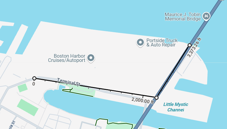

The old freight ROW through Charlestown probably works for this purpose. Here is the 3375 feet it takes to get to 135' at 4% grade. You could even cheat by running the rest of the line down that ROW but then you'd end up in Sullivan.

The curves of the highway make station location very tricky (if not impossible) for ADA platforms, limiting where transit can be effective. Not to mention, it's not like the highway was built to connect walkable areas. It's a terrible ROW for transit, period.
Honestly, the longer I look at this, the more I like bus lanes all the way up Route 1. You can take a lane for BRT/HOV. It's far from perfect, but it helps more of the people who use the bridge along the entire corridor.
If you absolutely must have fixed-rail rapid transit, I don't see it being cost-effective to build it north of Revere Beach Parkway, whatever you chose.
The stations at Revere Center and Woodlawn are both fairly compelling IMO, and Woodlawn is probably cost-effective because of point 2:
Along Route 1, both Prattville and Woodlawn are very well situated for bus transfers and integration using the BERy Model. (I like that name better and it's way more fitting, just look at the Washington St elevated stops.) They also have fairly strong walksheds as it is, despite being fairly residential. Prattville is located on the 111, and service along Washington Ave could connect well Everett or Chelsea. Woodlawn is already located on the 110, and is set up for strong connections to Revere Center.
They aren't cost effective if you have to cut an entirely new ROW through there. By that I mean, via tunnel or viaduct. There is little room for redevelopment until you get to Northgate. Those numbers aren't daily riders, just simply people who live there. Not all of them will be taking the T.
