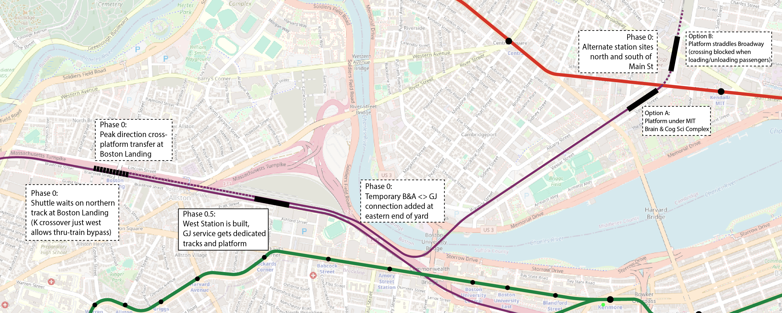

A concept for a minimum build "Phase 0" project
What we need: improved transit access to Kendall that doesn't require more people to take the Red Line.
What we've got: a largely single tracked mainline ROW with Class 1 track that could run in isolation from Twin City Plaza to Beacon Yard (ish).
Basically we've got track that could work for a single shuttle. So, let's use it for a single shuttle.
[details below]
"Phase 0" describes a pre-West Station build; operations are simplified in Phase 0.5 once West Station is actually built.
Boston Landing <> West Station <> Agganis Arena area: pre-West Station, a temporary connection will be required to connect the Grand Junction track (which runs directly into Beacon Yard) to the main Worcester Line tracks -- both to access the higher speeds of the main tracks, and to access the platform at Boston Landing. As illustrated above, the shuttle would wait for inbound Framingham/Worcester Line trains (or be timed to arrive alongside outbound trains), and then proceed in parallel to the divergence near Agganis Arena. Based on current schedules, this would likely take 3 minutes
Agganis Arena <> Main St: if this is indeed Class 1 track, that would be rated for 15 mph passenger service. The recent study suggested that there would be no particular speed limitations from the track geometry, except perhaps at the two curve points. To Main St, this is about 1.6 miles. Assuming an average speed of 13 mph, this segment would take about 8 minutes to traverse.
Upgrades: assuming 15 mph is adequate, it might not be necessary to upgrade the track to Class 3 or 4. And since there would only be a single train on the Grand Junction at a time, you could maaaaaybe avoid signal upgrades and continue to operate it "dark"
Station: assuming for the moment that we need an 800-foot platform, the cross-street locations are a little troublesome. A station that straddles Broadway would have enough tangent space, but would block road traffic when the train is there. Alternatively, a platform south of Main St could fit quite nicely, if MIT were willing to play ball; on the other hand, I have a vague idea that FRA regs would require gates to be lowered even if the train doesn't actually enter the intersection but is still in motion nearby. If that's the case, then this platform location would also be disruptive (though less so than the Broadway one)
Competitiveness: Assuming 2 minutes for cross-platform transfer + 3 min to Agganis + 8 min to Main St, this journey would take 13 minutes. For comparison, CR -> South Station -> Red currently takes 40 minutes; the 64 bus also runs Boston Landing <> Kendall and takes 34 minutes. In both cases, the shuttle's 13 minutes is a significant improvement.
Ridership: section 4.5 of the recent study lays out a methodology for estimating ridership of a service like this. Limiting the scope of the estimate accordingly, they estimate this shuttle might attract something like 1100 - 1500 daily riders from the commuter rail. Since this service would be timed-transfer only, the Allston/Brighton <> Kendall market would be less "excited", but even timed-transfers would still offer multiple peak journey options, so those numbers might be a bit higher. For context, in FY19, Kendall station had about 17,000 entries; those 1100 - 1500 daily riders would almost certainly get subtracted from that number.
Conclusion: it's not the prettiest picture. The ridership is hardly spectacular, so it would come down to, "How cheaply can a platform at Main St be built? And how expensive would it be to add the necessary crossover near Beacon Yard? And how much would it cost in ops?" None of those are necessarily super expensive, but they aren't nothing.
The study noted that the travel time savings for Worcester Line commuters would be significant enough that even lower frequency services would be competitive, compared to the other options they discussed. This illustrates the promise and pitfalls of mainline service on the Grand Junction: it's most competitive for the Allston/Brighton <> Kendall journey, in part because it runs pretty directly between the two. Contrast that with the North Station <> Kendall journey, where the Grand Junction alignment is much more roundabout. But even with the more favorable situation from West Station... mainline service on the Grand Junction really just isn't fit for purpose.
Track classes are first and foremost a maintenance standard. It includes things like how many bad ties per X feet are allowed, how worn the rail is allowed to be, how much the ballast is allowed to be decayed/washed-away, how much the gauge is allowed out-of-alignment, and so on. You'd never put a frequent service on Class 1 track. The infrastructure isn't going to fare well under the number of reps. On the Grand Junction you've got old jointed rail, so the ride would be uncomfortable. And you've got vibrations from the shot trackbed that MIT abutters would object to. Even if you don't plan to run at the max authorized speed Class 3 track with welded rail, nearly full tie replacement, and complete resurfacing is pretty much required for any tolerable and highish-frequency running experience both for passengers and abutters. Those costs are non-optional.
Finally, you might not be able to get away without a signal system. The NJ Transit Princeton Dinky is the only signal-and-PTC waivered commuter line in the country that runs a halfway decent schedule, and that one is because it runs fully sealed pinging back-and-forth on isolated track occupancy without interacting with the NEC signalized interlocking at Princeton Junction. Your proposed service would be interacting with signalized interlockings on the Worcester Line at West Station and Boston Landing, even if it stays on its own track. That torpedoes the track warrant occupancy because it's interacting with the Worcester Line dispatcher. The waivering limits for an unsignaled/un-PTC'd branch off a signaled mainline is 4 RT's per day, and the only commuter line in the country that operates such a limited unsignalized schedule is LIRR's Greenport Scoot. So you'll mandatorily be cab signaling and PTC'ing the Grand Junction to operate your Phase 0 service. And if you're upgrading the track and signalizing any which way, you might as well make it a complete North Station shuttle.
These costs wouldn't be too bad because of the short length of the line, but it's not grab-and-go by any means. The grade crossings would all have to be done over as well...surfaces, circuits, signal cabinets, and active protection. Mass Ave., Main, Broadway, and Binney don't have crossing gates yet (only flashers), and the gates on Cambridge and Medford are past replacement age. Only the fairly recent-install two MIT pedestrian crossings have up-to-spec gated equipment.
EDIT: The 2012 study estimated the costs of track upgrades, crossing upgrades, signals, and the interlocking at Beacon Park Jct. to be $22.5M. So use that figure + inflation for your starting point, and then project up for station costs. Note that figure doesn't assume double-tracking, signalizing/interlocking the existing Cambridgeport passing siding, or any unforeseen repairs to the Charles River bridge. The Brickbottom Jct. interlocking and Fitchburg Line crossovers already exist, paid for by GLX.
