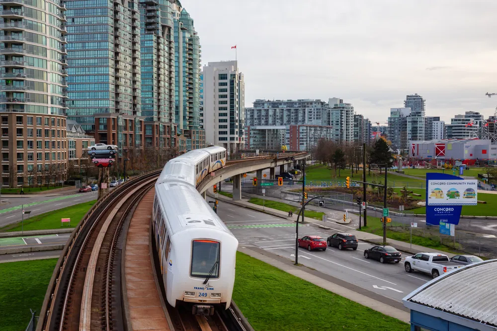

I think you could count the Honolulu and Vancouver Skyline services; they're elevated near-metro ops that are fully GoA4.
