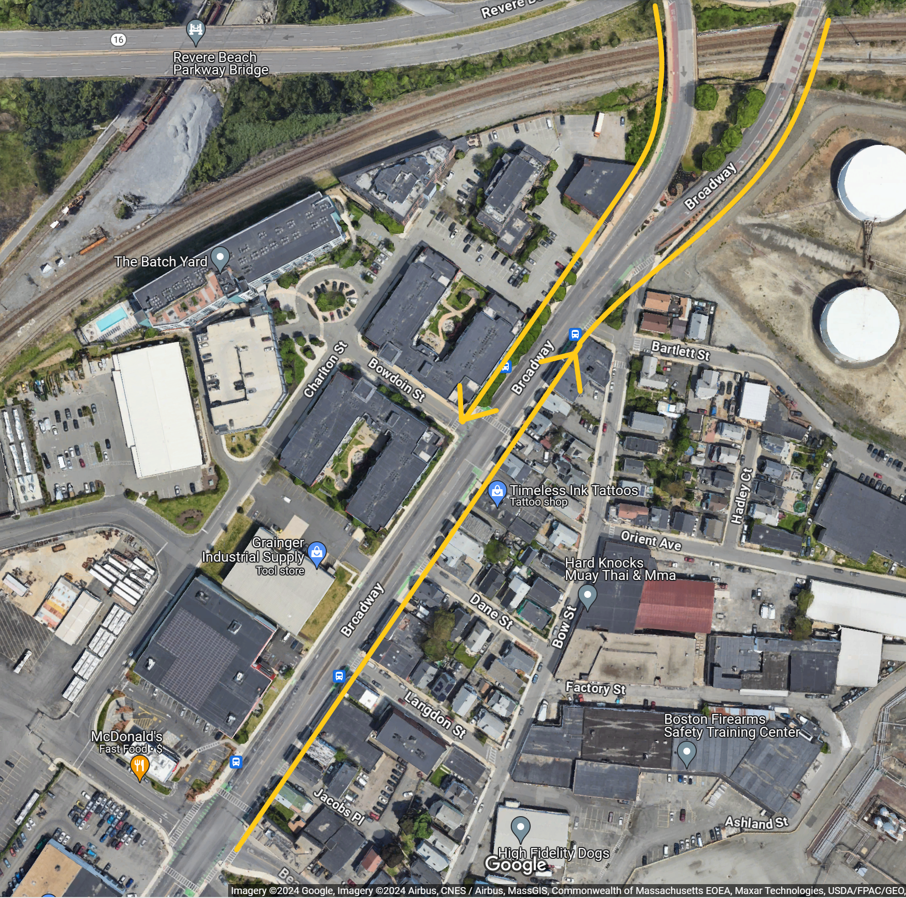

For (1), the only portion where buses run in mixed traffic on Lower Broadway is the section I highlighted in yellow, according to the SLXAA:
However, I think they're overestimating or overdrawing the segment of mixed running needed, for two reasons:
- The northernmost parts of Lower Broadway, where it crosses the railroad ROW, already has dedicated bus lanes. (The northbound bus lane is shared with right-turning traffic.) So even without any new infrastructure, the drawing in the SLXAA isn't precise.
- I imagine the redesigned Lower Broadway will have 2 bus lanes and 2 travel lanes, not 4 travel lanes, in both directions combined. This is because even south of Beacham St (where bidirectional bus lanes start), Lower Broadway at its narrowest (63.5') can't accommodate 6 lanes and 2 bike lanes without taking private properties. If 4 lanes total (+2 bike lanes) are what we're going for, then the section I drew above can also handle it.

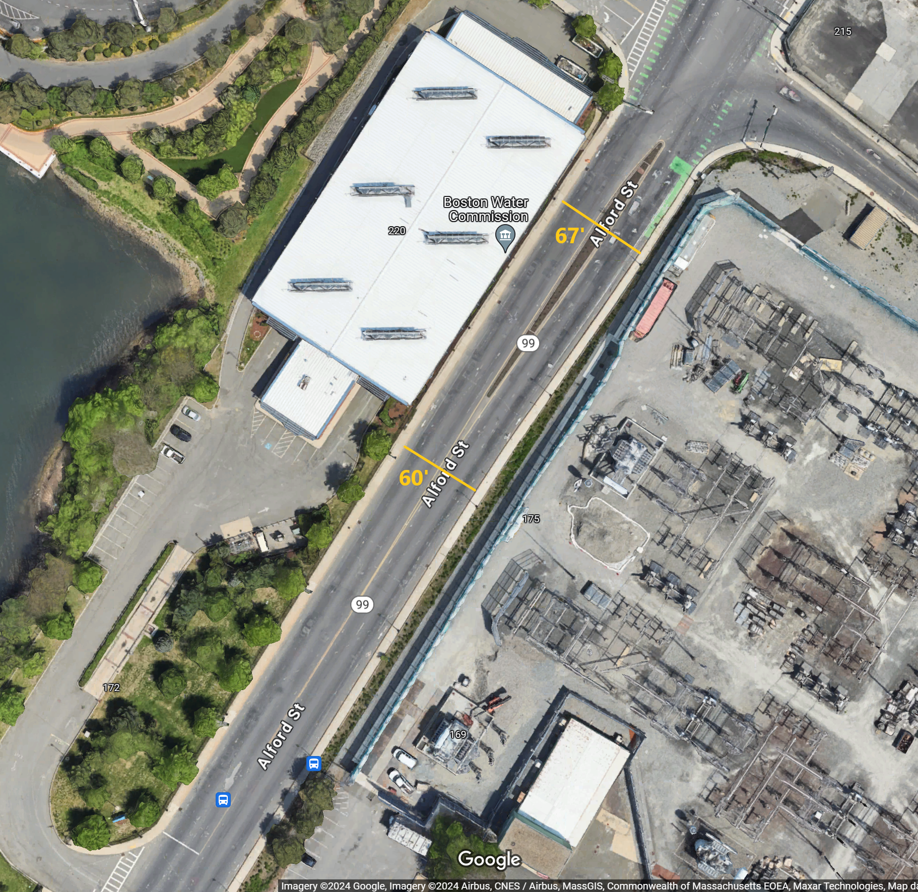

The 67' at the northern end (just south of Dexter) is easily enough for all we need (52' minimum without additional barriers or wider bike lanes). As for the 60' to the south, honestly they feel enough to me; but even if not, taking out the greenspace between the road and the private parcels should allow you to widen the road to 67'.
