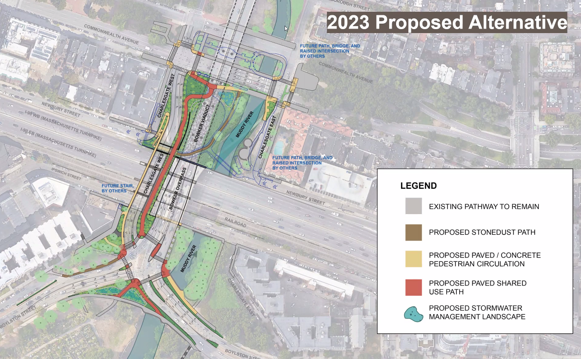

A shadow plan would be really helpful here.
I'm really getting hung up on this crosswalk across an off ramp. I mean, everything about the overpass is terrible, but this looks dangerous.
As an alternative to Bowker removal, it should be rebuilt entirely in plexiglass.When overpasses are depicted as transparent, it is confusing as well as outright deceptive.
I agree to an extent. I am an idealist when it comes to removing elevated expressways, which has been done in a few exceedingly rare places in the US. The notable examples are the Westside Highway in NYC, the Central Freeway in SF, the Arborway overpass at Forest Hills, Boston, and the Park East Freeway in Milwaukee, WI. These were all replaced with surface boulevards. So it can be done. The turning point in the US will be if/when the Federal government someday increases transit funding, thus enabling some of the transit expansion ideas shared on this board to be built. Then there can be ample justification for reducing highway capacity and tearing down more elevated highways, especially ones like the Bowker which cover up an important park.While I agree that taking down the viaduct altogether would be the best option, it's not too likely under current political-social conditions. We haven't proven ready, as a society, to completely eliminate what is seen as critical car infrastructure. This plan accomplishes one very important thing, though, connecting the pedestrian and bike paths through the Fens directly to the Charles River paths. If such an improvement is built, it will essentially be possible to bike from outer neighborhoods like Roslindale and Dorchester all the way to the Esplanade on an entirely grade separate route, through beautiful park land along the way. That in itself is a huge win.

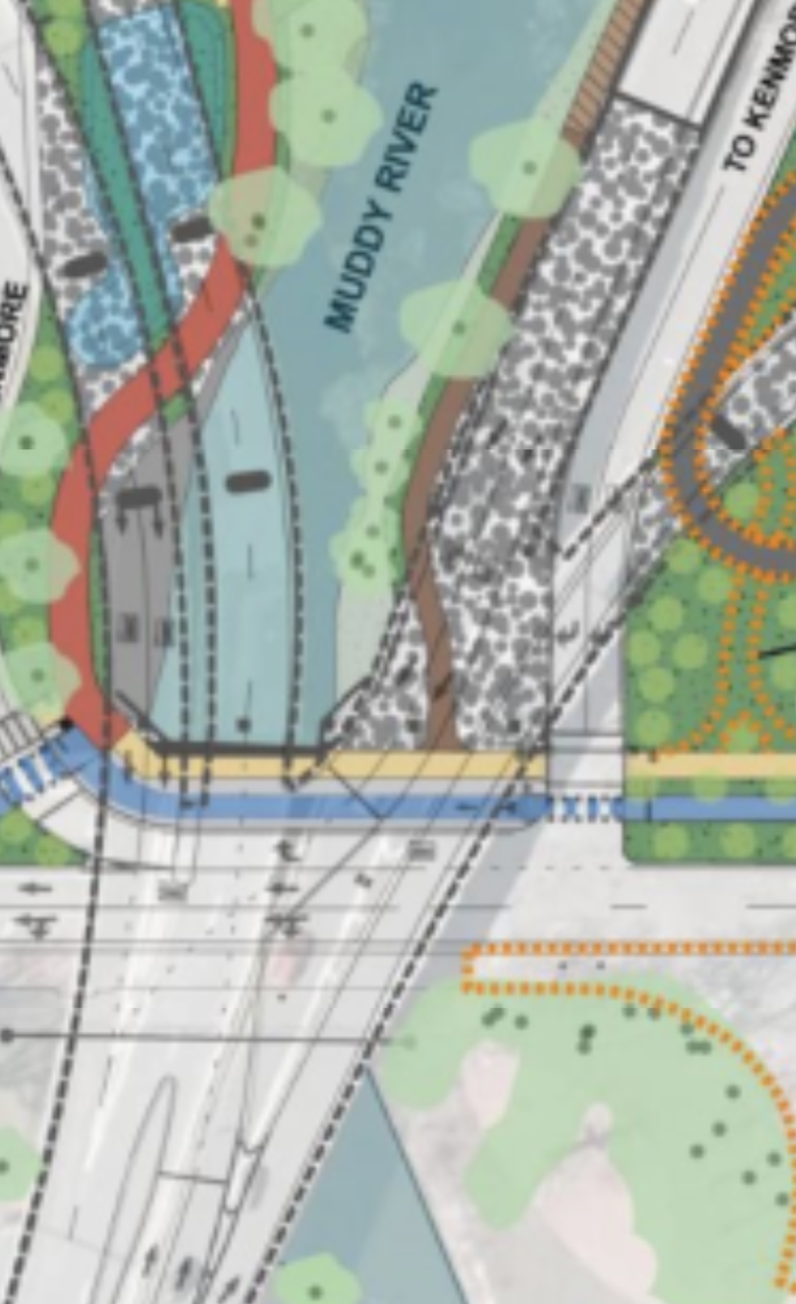

They simply cannot - full stop (no pun intended) - place a crosswalk across this section of Storrow, where traffic moves frequently in excess of 60mph and visibility is impaired by the bridge dip even for a hypothetical signaled crossing. I don't think any road regulations, besides just common sense, would allow that to occur. Is there any change this is representing a tunnel underpass or something?
Stop lights at the top of Storrow West off-ramp. The ramp is fairly lengthy so I think two lanes at say 300' would be ok volume wise for a 2 minute light cycle.This is confusing as hell

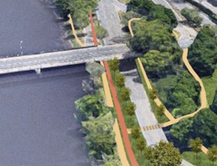

Pedestrian and bike traffic is poorly served by the red colored narrow walkway crossing a major street at its southern end. It's like they designed the roadways first and then threw in a walkway because they had to, The priorities should have been the other way around.
This plan really says traffic throughput is all these engineers understand.
It looks to be a bit tight at first glance but with a closer look, it appears to be wider than a car lane. About 12' to 15'? That seems comfortable for a couple pedestrians and/or bikes to pass by each other. But you are correct that there should be more than one ramp. A ramp should be available on the east side , to align with the pedestrian and bike flow out of the East side of the Fens.Pedestrian and bike traffic is poorly served by the red colored narrow walkway crossing a major street at its southern end. It's like they designed the roadways first and then threw in a walkway because they had to, The priorities should have been the other way around.
Think of it as a traffic calming device.All these changes and somehow the death merge at the end of the on-ramp to westbound Storrow continues into the future?

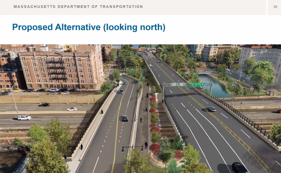

This very clearly does nothing to address concerns of residents and of those who enjoy the Esplanade and Emerald Necklace and promotes driving through areas that most definitely do not need additional cars. How this can possibly be seen as acceptable in 2023 is beyond me.Latest renders from the MassDOT meeting today. Current plans have construction starting Summer 2025.
View attachment 43892View attachment 43893
Thanks for sharing - couldn't make the meeting, but curious if anyone is organizing to oppose this happening at all? It's just crazy that the state is doing this - it's a highway widening project in an urban neighborhood.Latest renders from the MassDOT meeting today. Current plans have construction starting Summer 2025.
