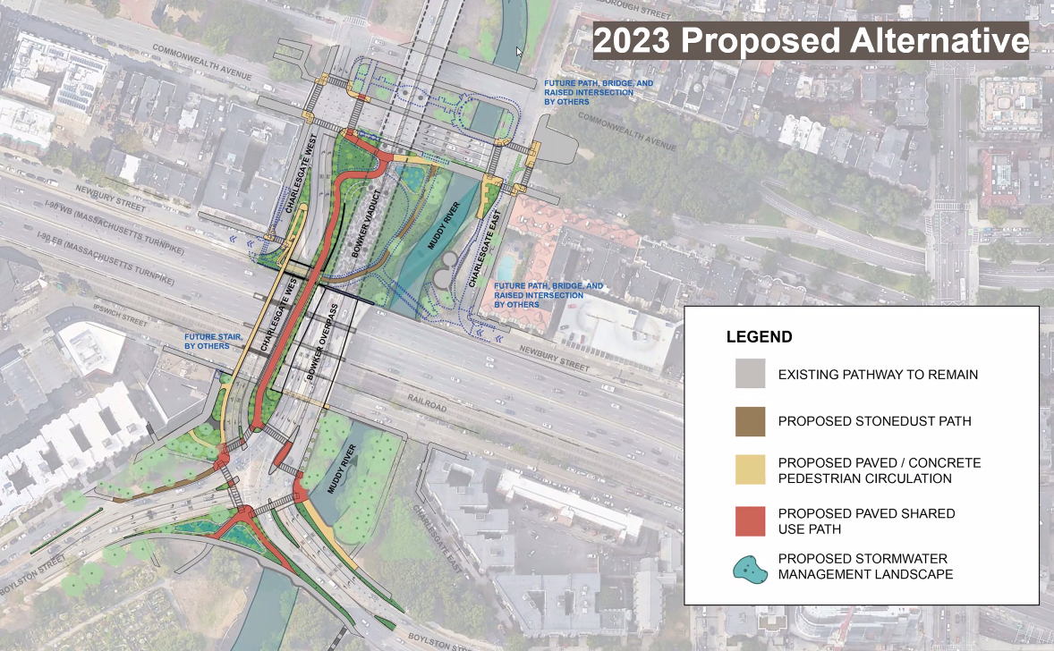

Latest renders from the MassDOT meeting today. Current plans have construction starting Summer 2025.
View attachment 43892View attachment 43893
I know that from an urbanist point of view, we want the viaduct to be completely removed, or at least truncated at Comm Ave. But I don't think we have moved the conversation far enough for that to be a realistic idea right at this time. I personally see the significant improvement for walking and biking connections as a win, even though it is overall still a very car focused design.
Note that all the elements in those pleasing renderings shown a few pages are on these drawings, but are listed as "potential" and "future" and "by others." I.e., they're not going to happen.
IIRC those aspects aren't MassDOT jurisdiction to implement. I don't see much reason to think won't do City of Boston isn't going to do those things?

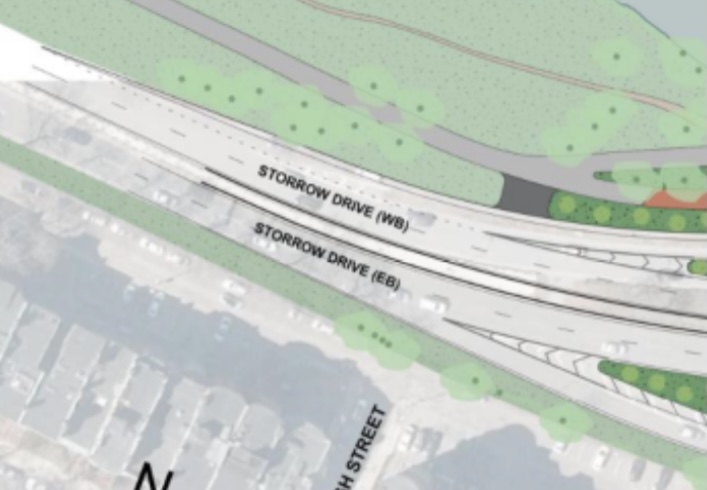

Are you referring to the merge onto Storrow WB itself or the lane reduction on the ramp? If the former, that merge is proposed to get a full length parallel acceleration lane as opposed to the ‘lol hope you have a V6’ entrance thats there now.View attachment 40426View attachment 40427
It's pretty rare I drive out of Boston by getting on Storrow but I was reminded of this fucking merge a few weeks back. Death merge is an understatement.
