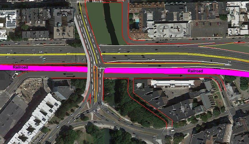

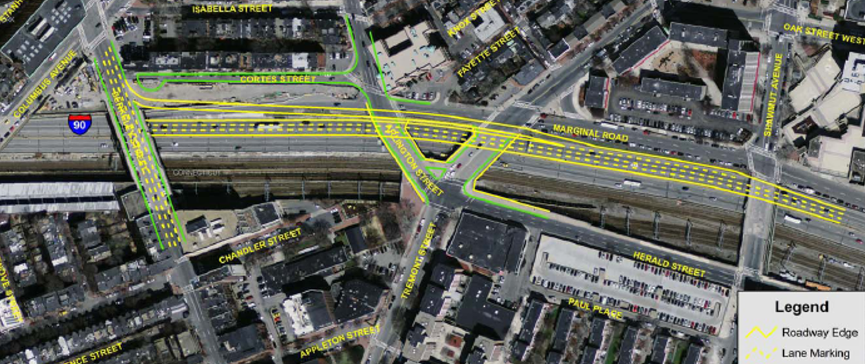

Herse are a couple of possible ramp options for the Mass Pike:
This one by MassDOT a few years ago, for a westbound off-ramp to Berkley st and Columbus Ave:
And this one I laid out myself for an on-ramp from a truncated Bowker to eastbound Mass Pike:
The Bay Village ramp is too far east to help much with Longwood access.

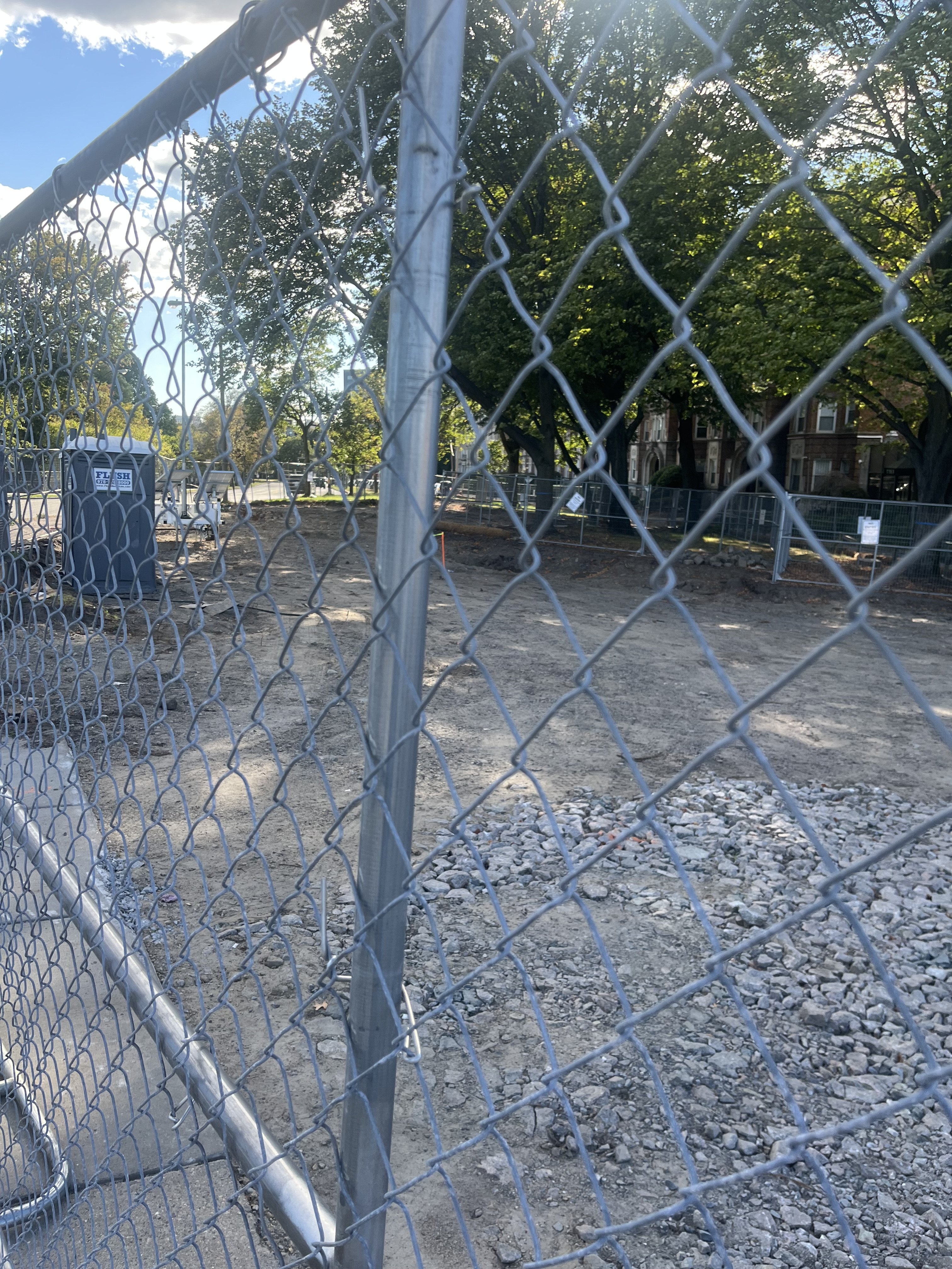

Some activity at the Commonwealth east bound side, construction fence and more trees cut down. Looks like construction is underway. Sorry no pics.

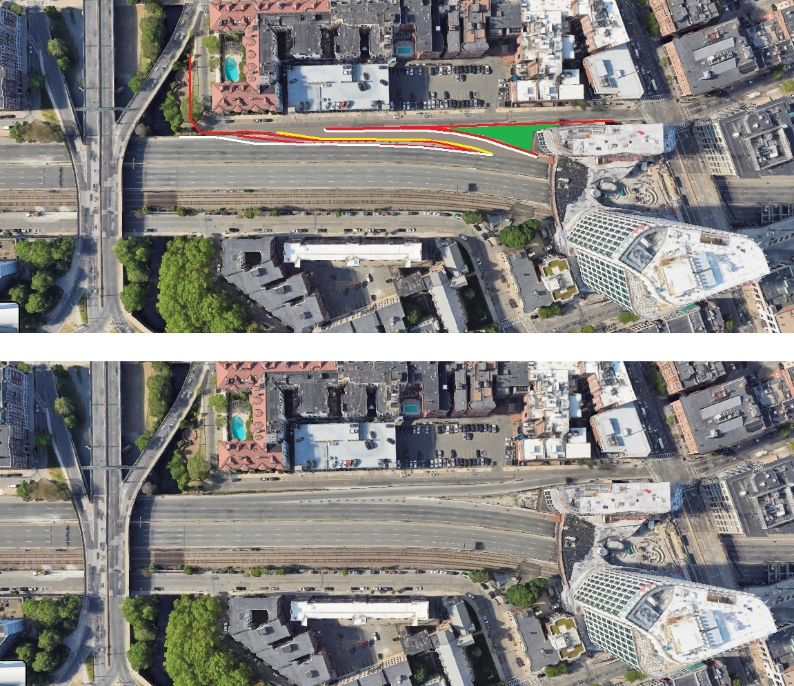

No problem. Eliminate the westbound onramp from Mass Ave and replace it with an offramp. Proposed, and existing shown below:
I think you could do a westbound off ramp connecting to Newbury Street behind Kenmore Square, which would avoid eliminating the eastbound on ramp from Mass Ave.

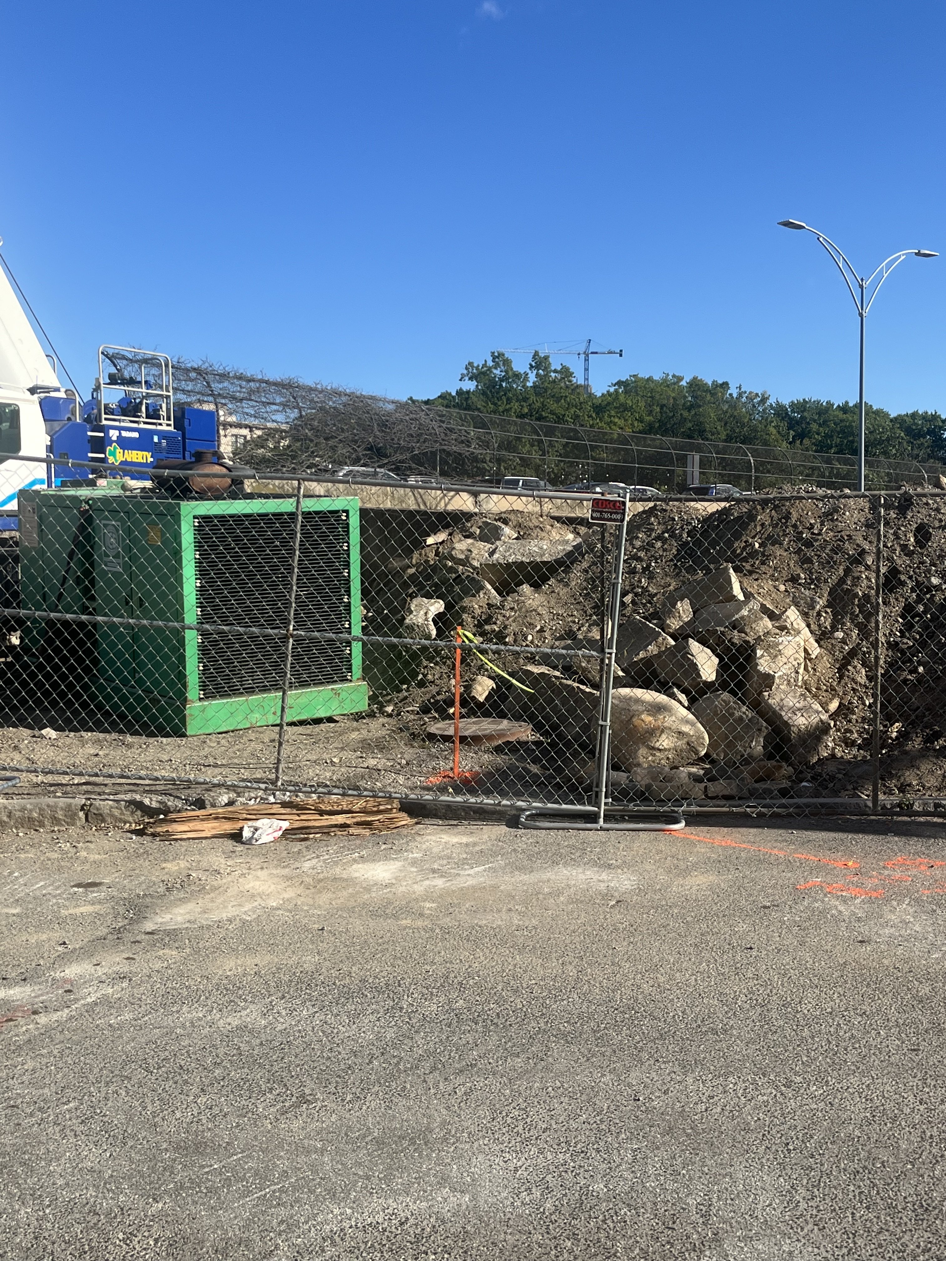

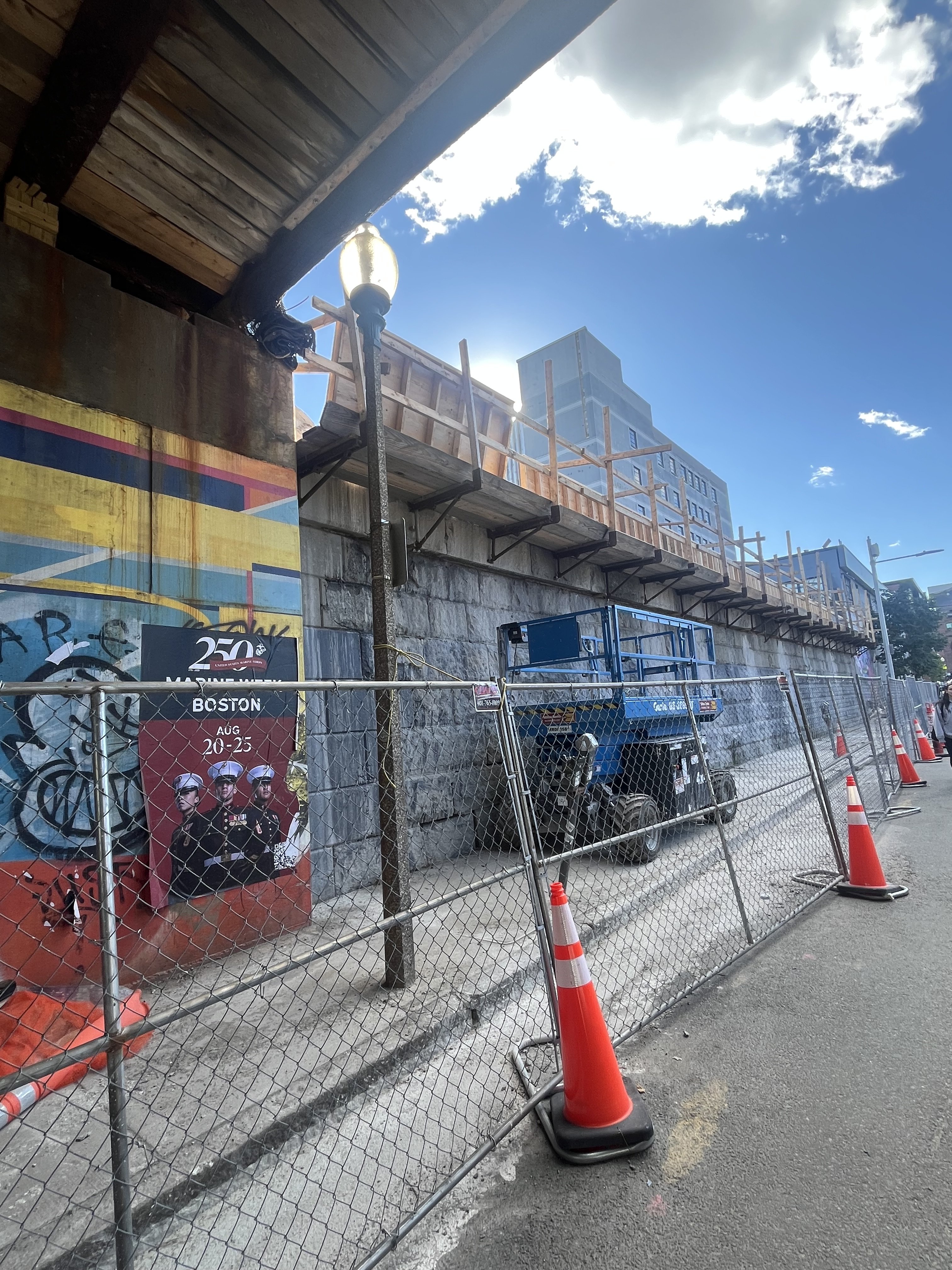

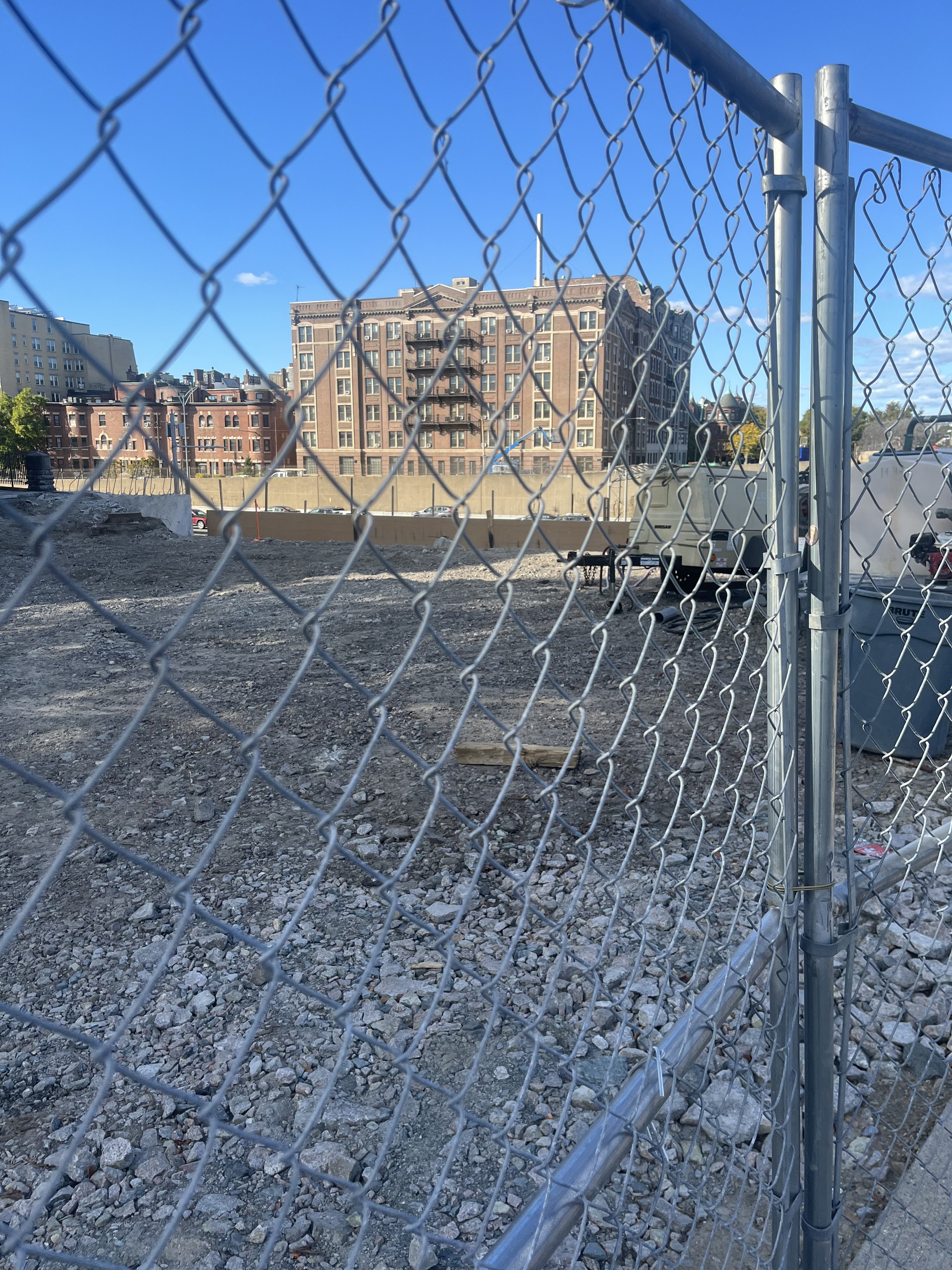

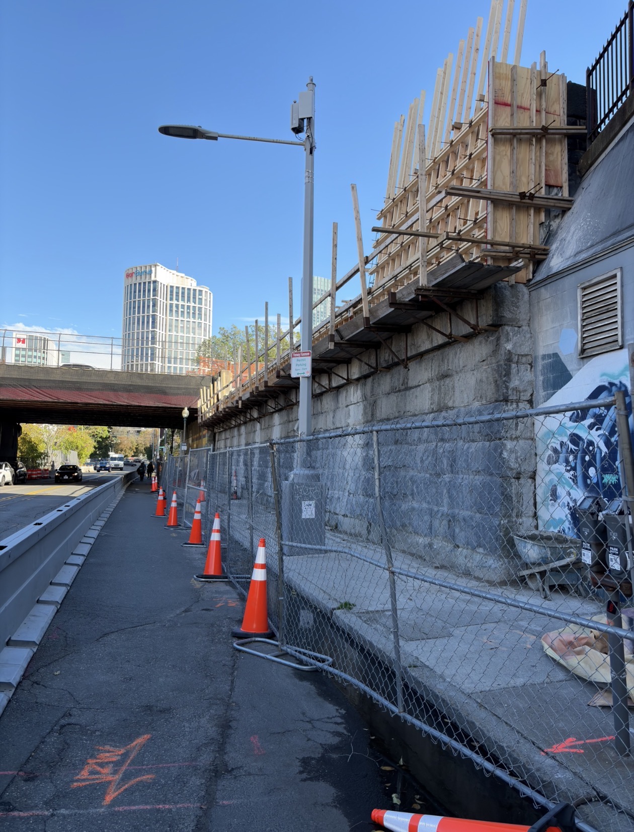

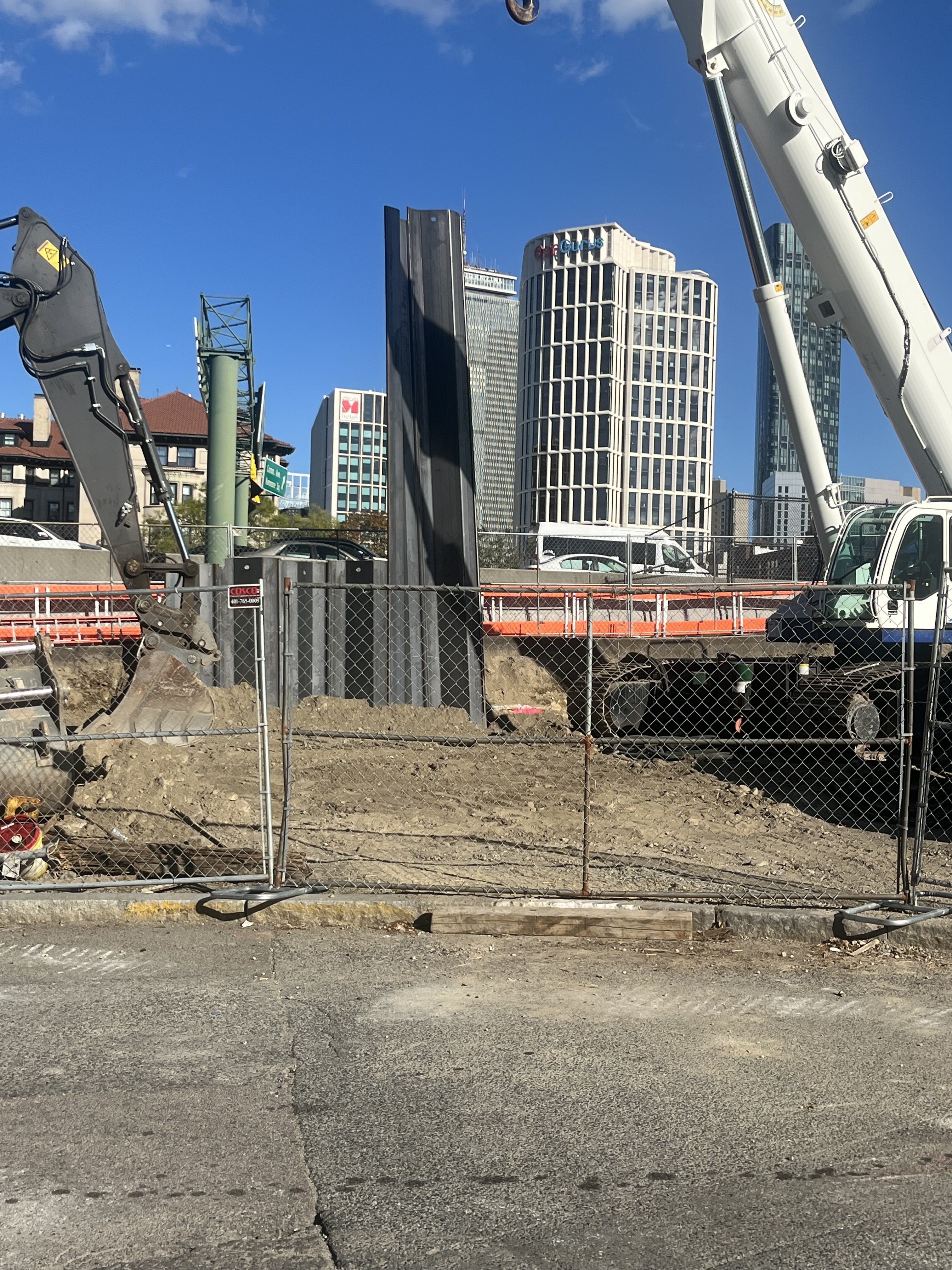

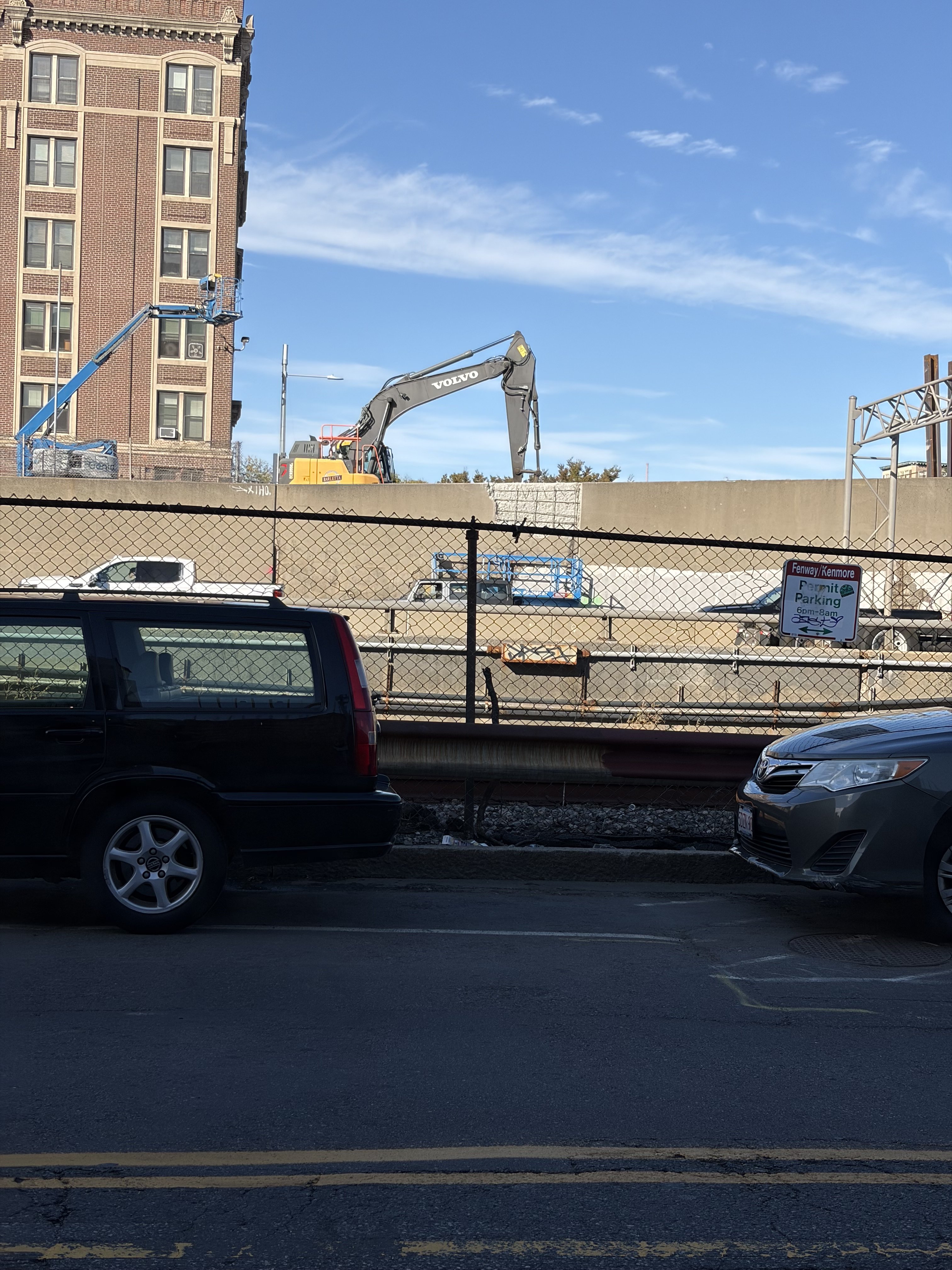

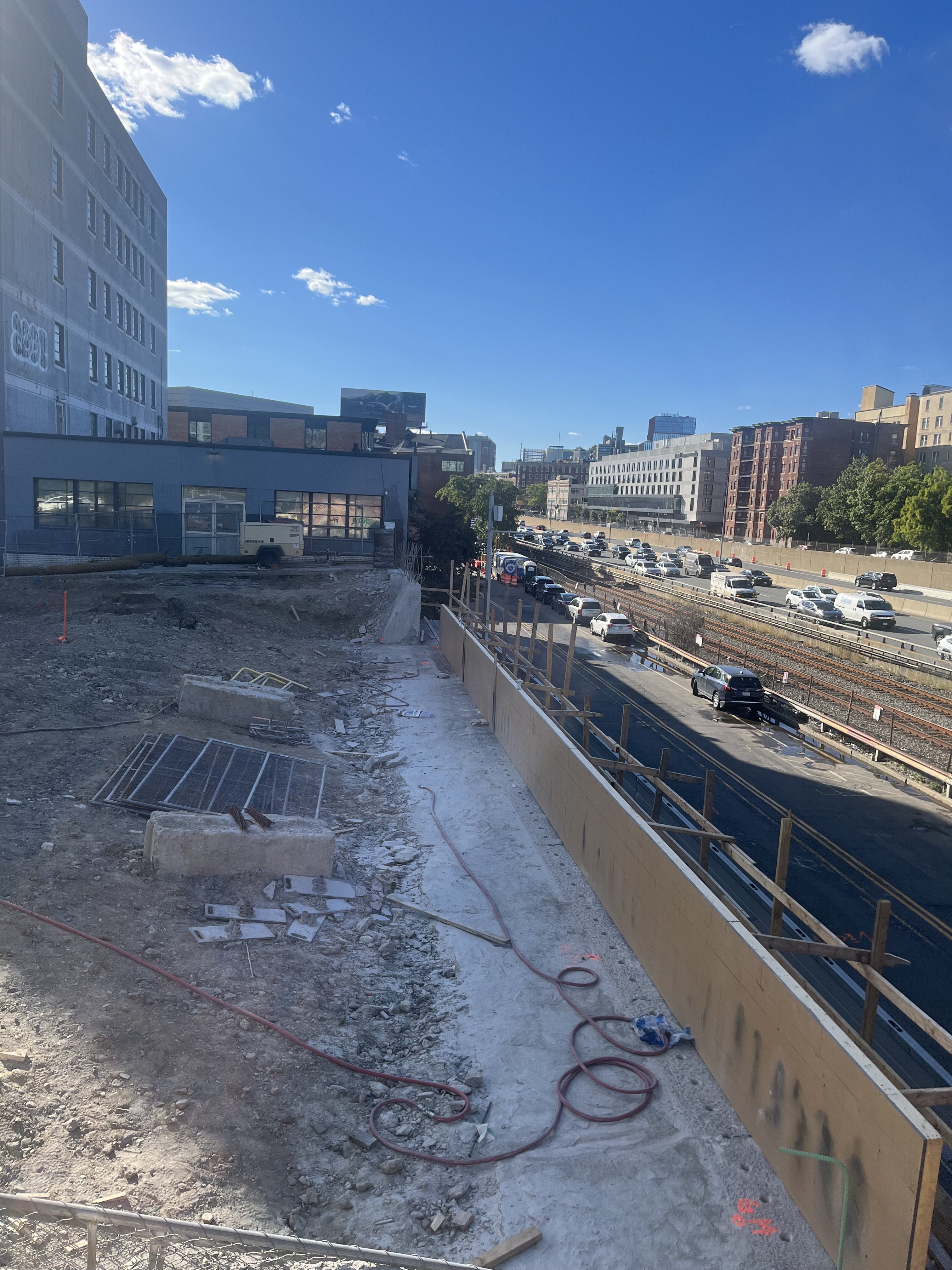

10/15

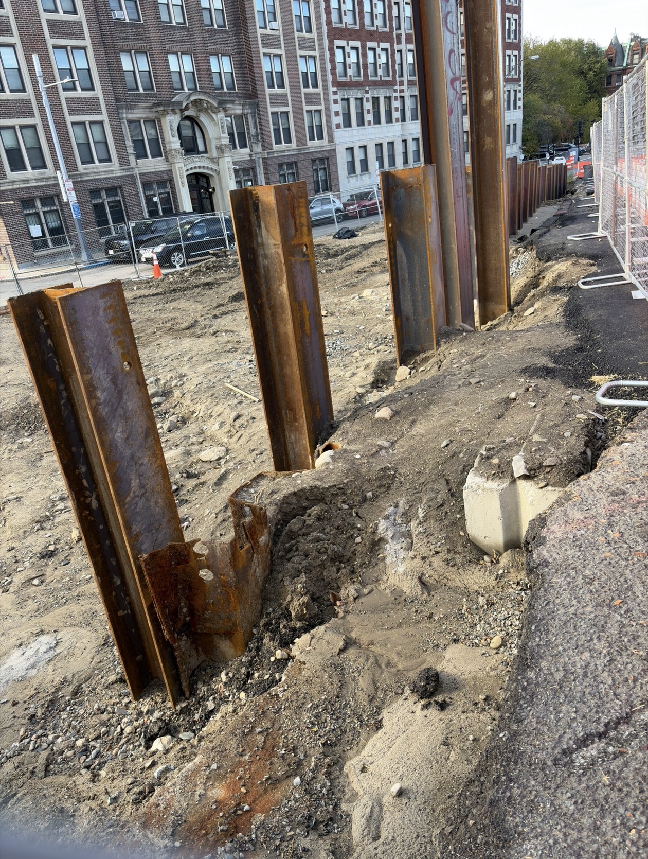

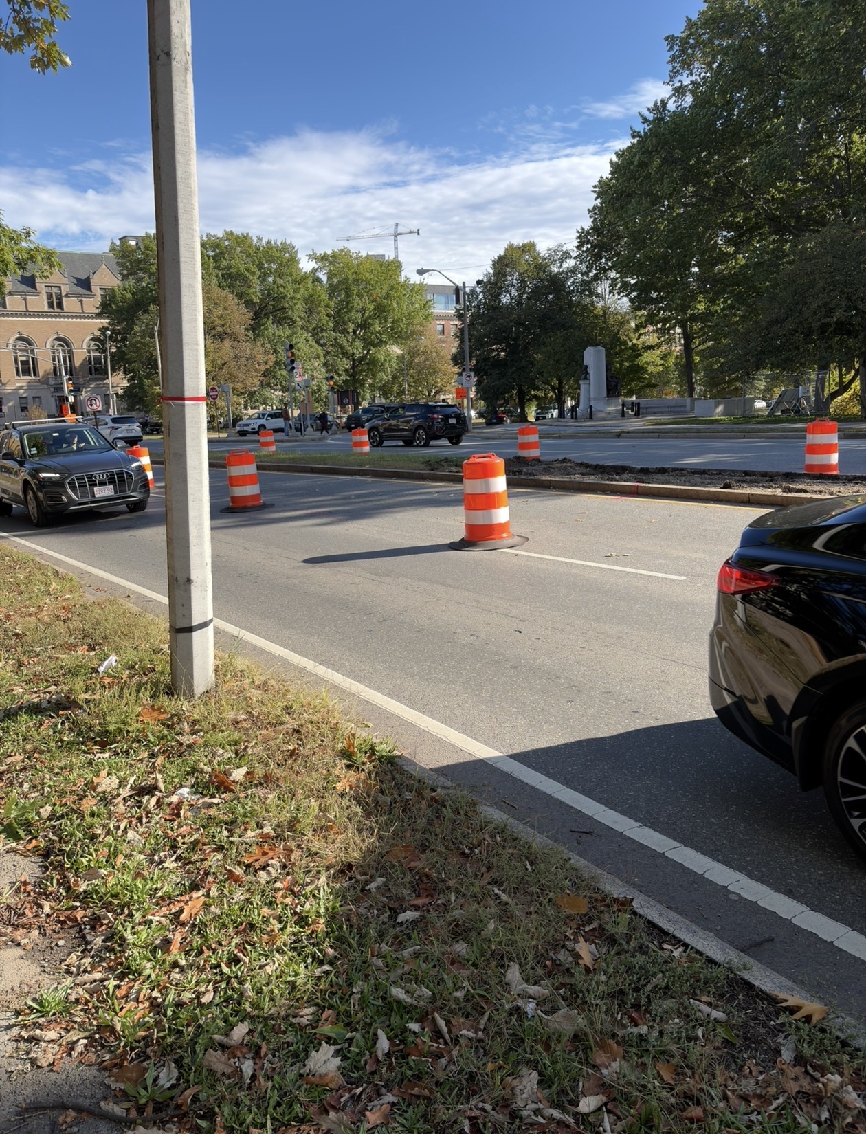

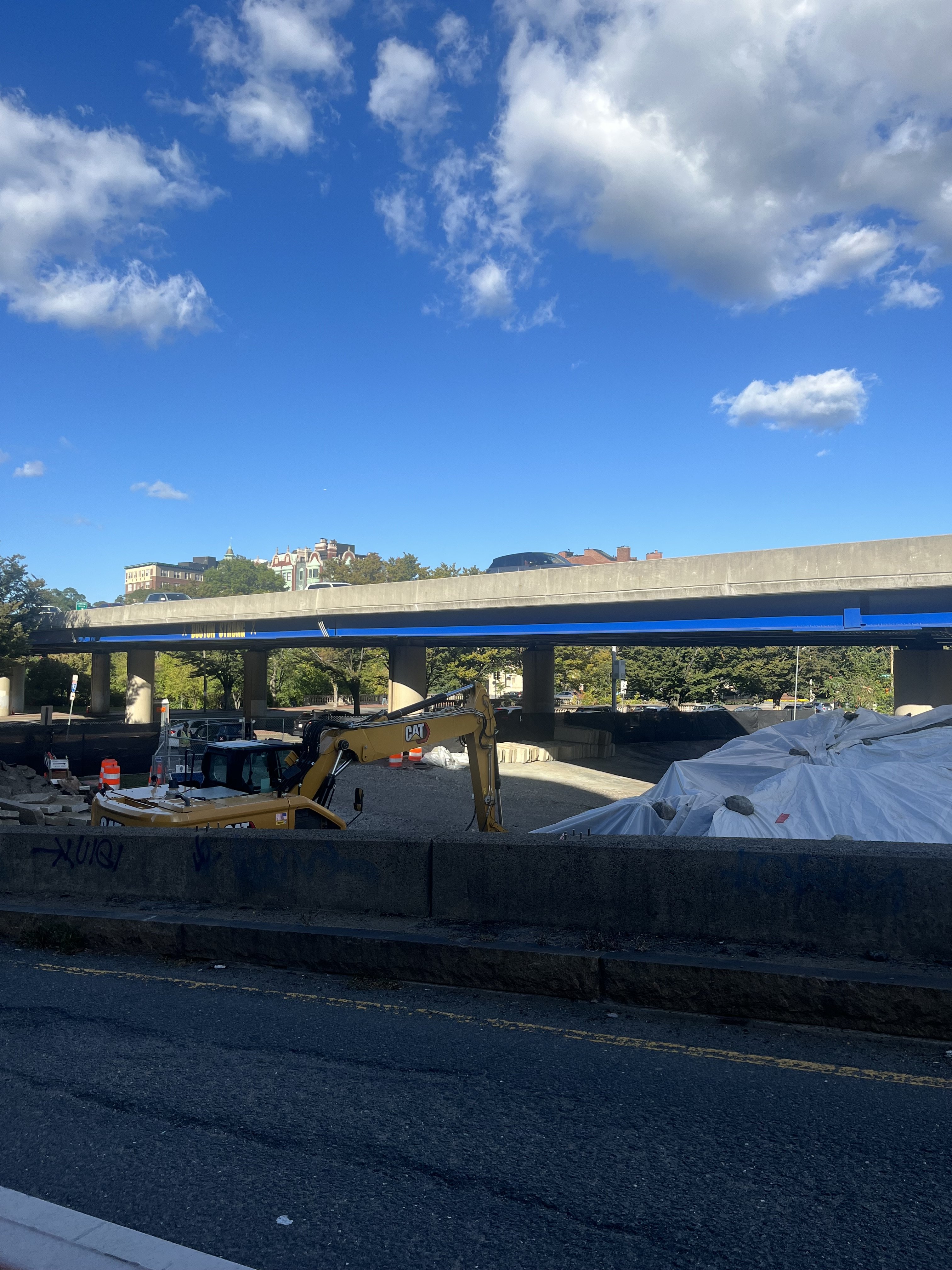

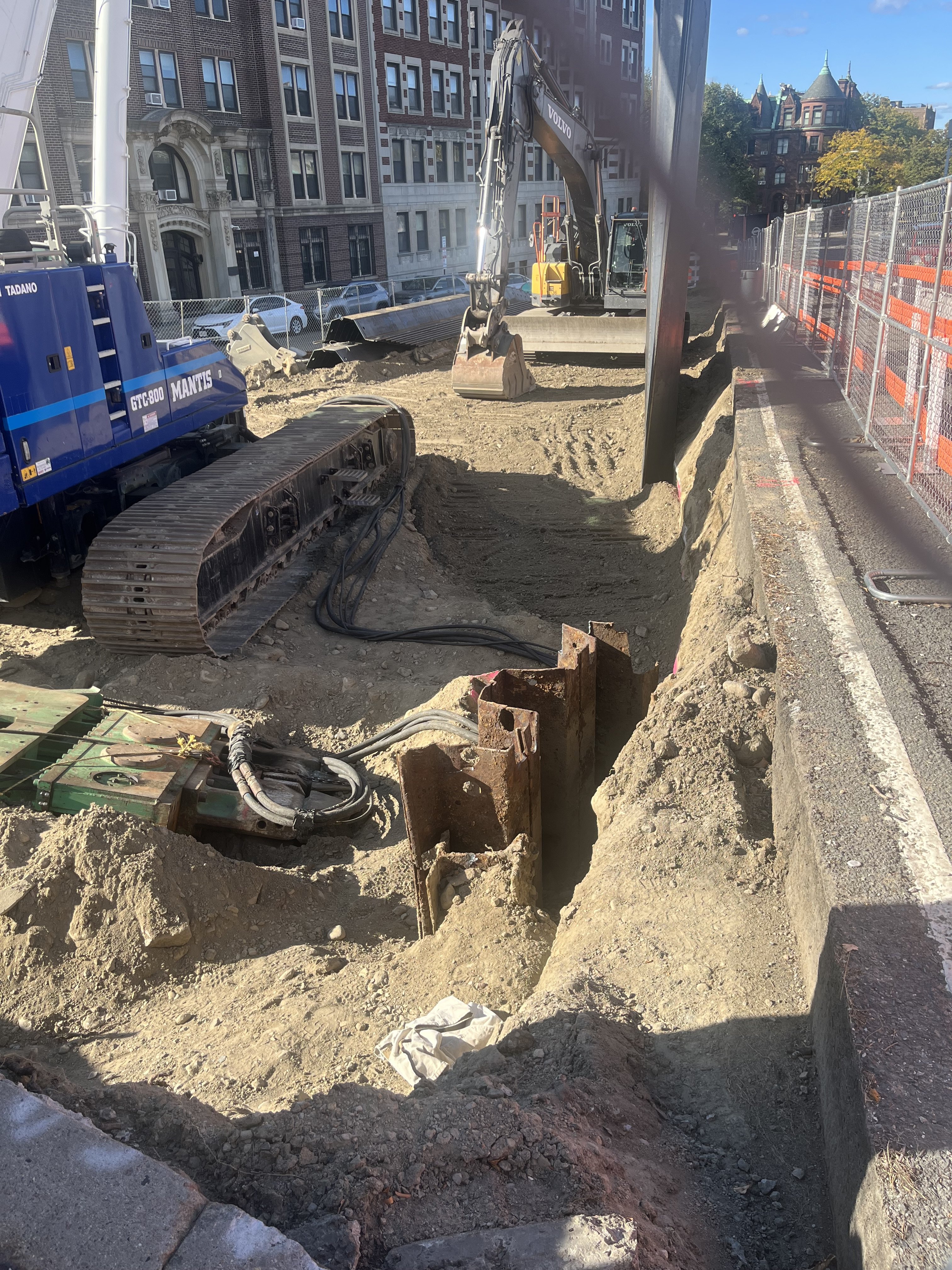

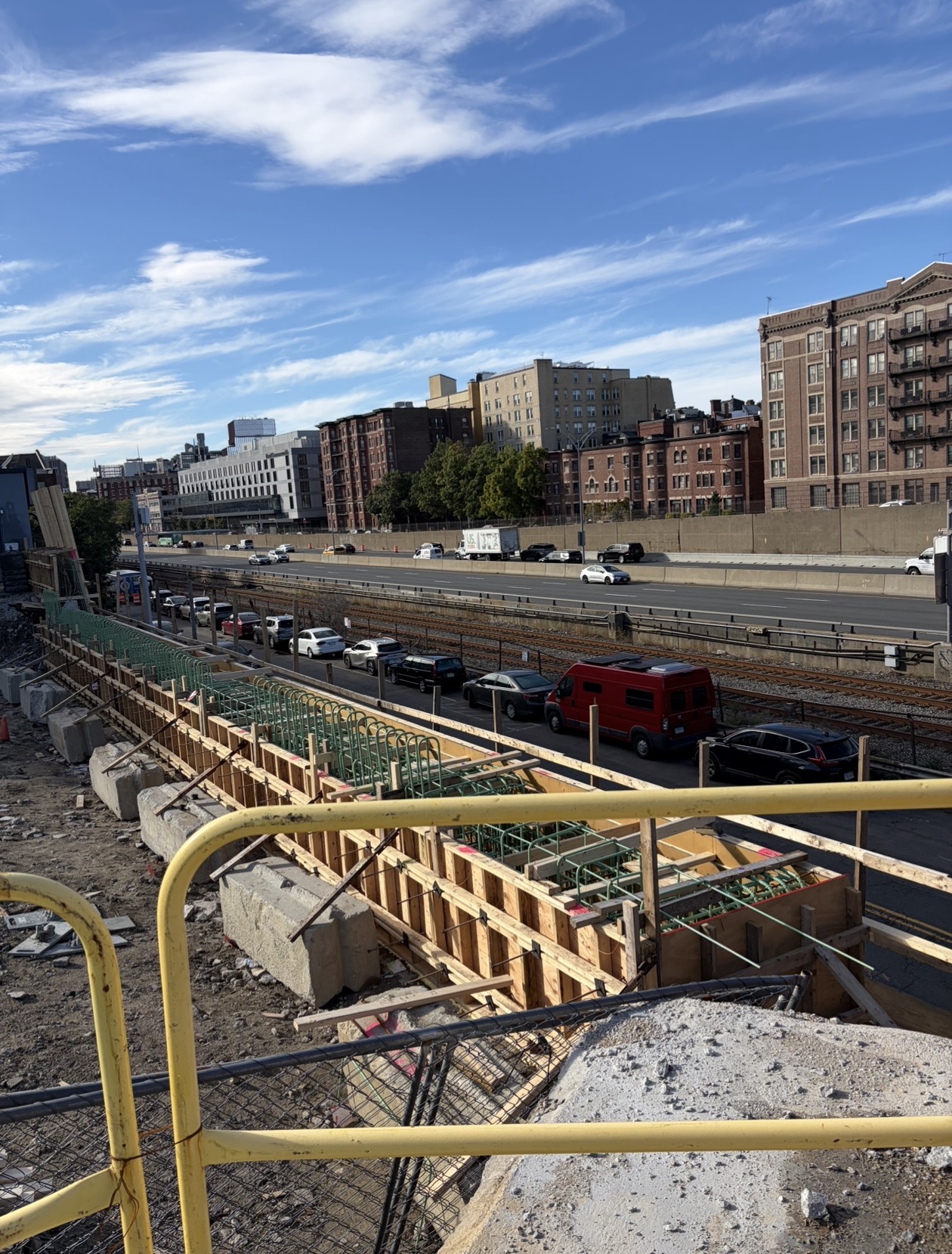

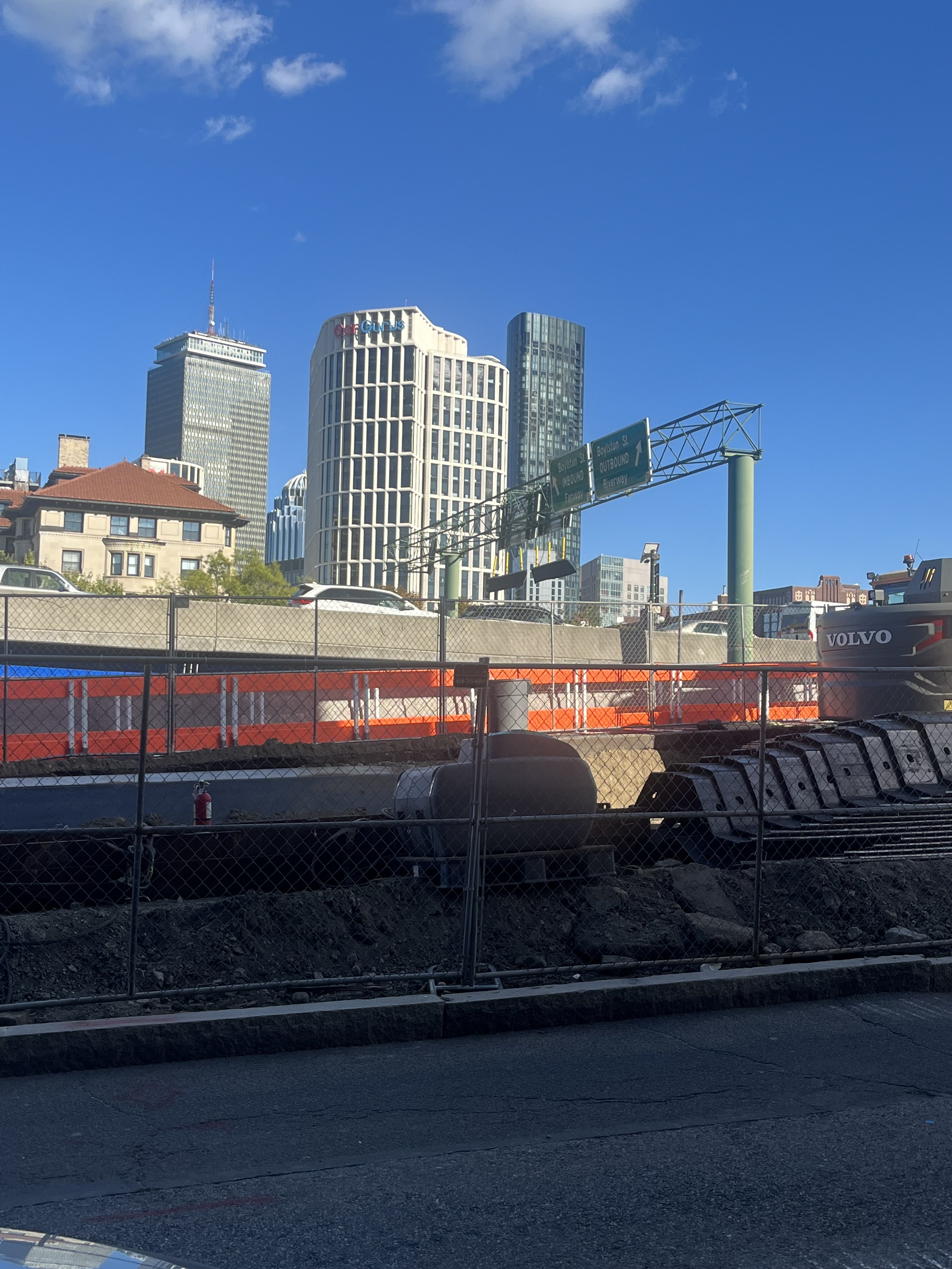

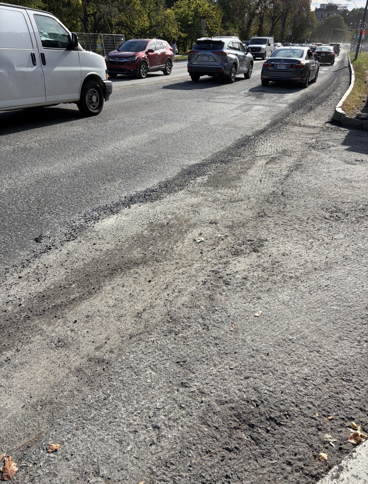

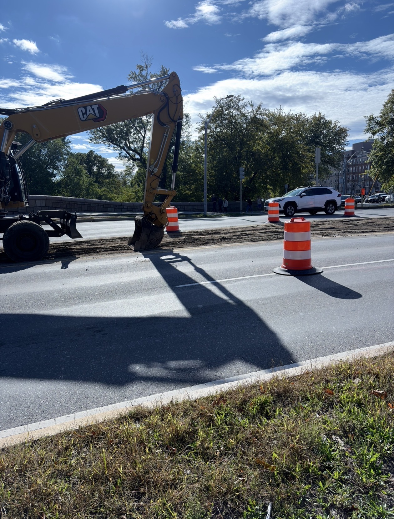

Median has been removed on Boylston Street east of the overpass and the Boylston Street has been milled west of the overpass. Temporary signals on wooden poles have been installed at the intersection. Bridge abutments are being formed.
