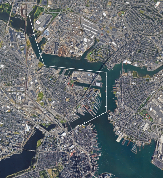

Its freaking awesome to be able to go outside. I always hate getting on a train on a nice day. I would love the choice to either take the crowded Orange line from Wellington... or to hop on an "extended" Encore Ferry all the way into downtown Boston to work.
The Amelia Earhardt Dam locks: "The largest is 325 feet long, and 45 feet wide; the two smaller locks are 120 feet long and, 22 feet wide."
For strictly speedboat-y type excursion runs that's not a far reach at all if Wynn fun bux were floating the cost. The only reason we don't see something like that already is that nobody local retains a fleet with the performance profile for a short-hop like that. Extant carriers are either too big (T/Massport ferries, Aquarium) or too small (duckboats). All those proposals for more Ft. Point Channel boating that paint themselves onto SSX & the re-knitting of Dot Ave. are predicated on bringing in some of those midsize craft with the performance profile for making multiple stops, so it's not at all unreasonable to see that being a decently-utilized thing (so long as we don't go all NYC/de Blasio "FERRIES EVERYWHERE!" insane with the subsidizing). The Seaport-centric forces pushing for better public utilization of the Channel just need to put their heads together with Wynn and Massport so both sides of the Inner Harbor have equal-weight utilization hooks.
Only thing I'd caveat is that the Assembly riverbank is way too silty for that to be included in the route. The boat landings are all north of the dam because the runoff profile immediate-south doesn't leave depth for much more than a dinghy dock at Draw 7 State Park. And that's not a thing that dredging's going to perma-fix because the runoff profile of the dam is predicated on directing it to that shore so it's directed away from the other bargeworthy shores. Sullivan, on the other hand, should be able to rake on that utilization with the barely-used ship docks behind Schraffts. The whole Little League field next to Alford St. used to be an aggregates (dirt, road salt, etc.) barge-loading dockyard about 50 years ago. And while Encore probably has to do some substantial dredging in its narrowed channel to be able to get a midsize ferry in there at non-restricted speed, the sandbar-choked Alford side of the inlet used to be totally clear and host more docks in its industrial past so that's not a hard place to buff back out.

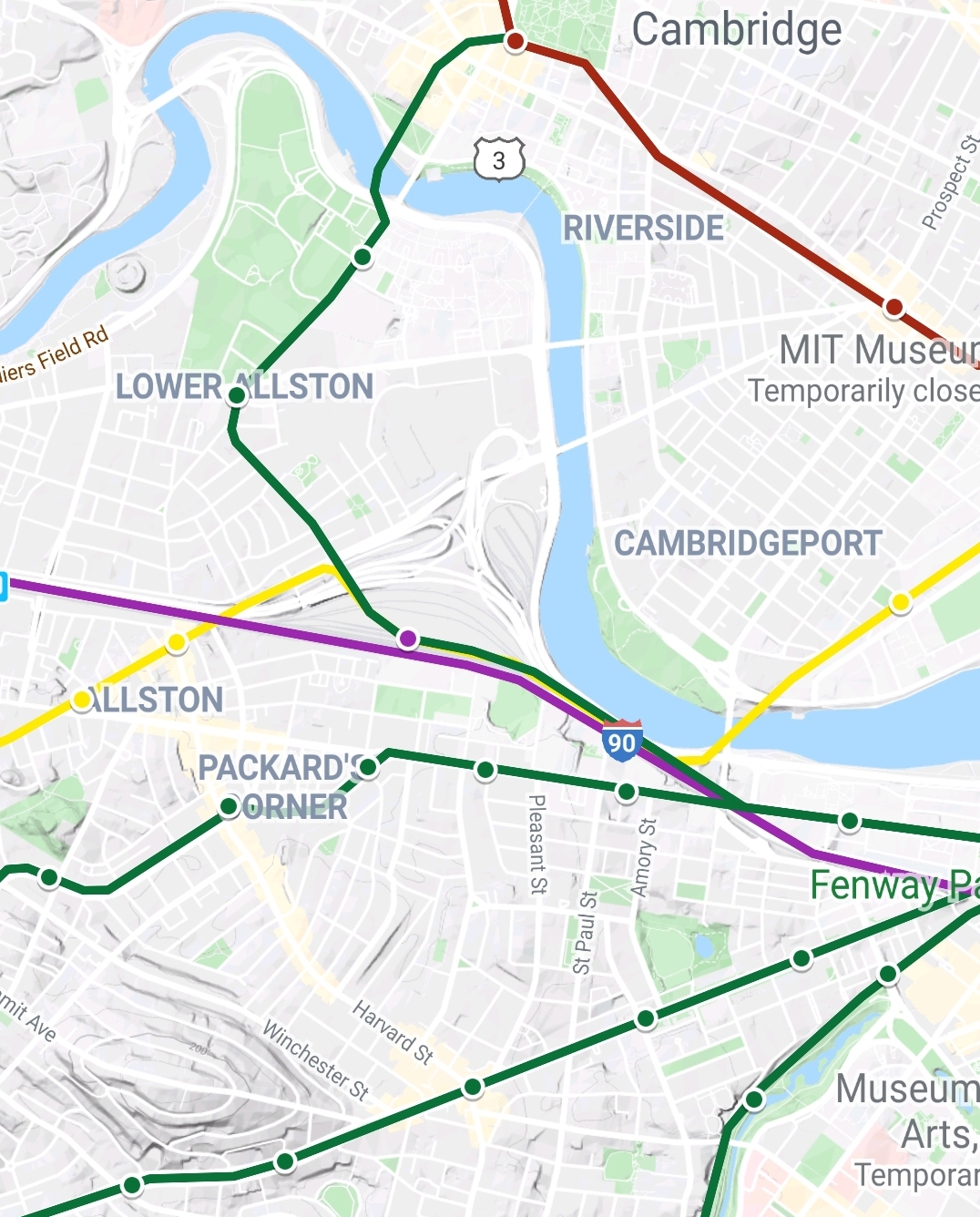

So given that the Btunnel, GJ conversion, and West Station would all be preceding this, would this routing (the one in yellow) potentially make more sense for the A? I worry about congestion in the central subway by adding this and the Harvard extension, but I'm not sure about crossing the cambridge street bridge over the pike. Also just having more connections running through West Station as opposed to Packard's corner seems preferable.
At an absolute level it's doable just like the A is doable after the BU Bridge subway takes out the garbage. Only reason I'd be leery of that one vs. the Packards split is # and intensity of traffic lights. Assuming the St. Paul combo station is first one out the B portal the only traffic lights between there and Union Sq. are:
  1. Comm Ave. (5 lanes) @ St. Paul St./Buick St. (2 lanes ea.) + protected turn cycles
  2. Comm Ave. (5 lanes) @ Pleasant/Agganis Way (2 lanes ea.) + protected turn cycles (unless the curb cut is deleted in favor of uey reverses @ Babcock for Comm Ave. WB and Armory--before the new subway portal--for Comm Ave. EB)
  3. Comm Ave. (5 lanes) @ Babcock St. (2 lanes) + protected turn cycles
  4. Packards Corner (4 travel lanes ea. direction + semi-permissive turns)
  5. Brighton Ave. (5 lanes) @ Harvard Ave. (2 lanes) + protected turn cycles
Via West Station (via latest MassDOT render) it's:
  1. Cambridge St. South (5 lanes) @ Seattle St. (4 lanes) + protected turn cycles
  2. Cambridge St. South (4 lanes) / N Harvard St. (3 lanes) @ Cambridge St. (6 lanes) + protected turn cycles
  3. Cambridge St. (5 lanes) @ Lincoln St. (3 lanes) / Lincoln St. Connector (4 lanes) + protected turn cycles
  4. Cambridge St. (5 lanes) @ Harvard Ave. (3 lanes). Existing signal w/ protected turn cycles.
  5. Cambridge St. (2 lanes) @ Derby Rd. Existing.
Same number...possibly less for Comm Ave. if you uey-laned your way into a Pleasant/Agganis curb cut elimination after the subway extension sets up the easy uey pocket east of the portal. And the MassDOT renders around West are subject to further wild changes (we've already cast suspicion on whether those superblocks will even work on-spec). But in head-to-head comparison virtually all those signals up Cambridge St. from West rate absolutely brutal. Potentially even worse than today if that new grid about Cambridge St. South over-encourages the induced demand. On Comm Ave. the directional bias for the mainline vs. the side streets renders St. Paul/Buick extremely minor, Pleasant/Agganis and Babcock (NOTE: which bafflingly isn't connected as a Beacon Park cross street in the latest render) pretty minor. So it's just Packards and Harvard Ave. with any sort of heavy diverging volumes, while damn near everything on the Cambridge St. grid is a major all-directions distributing intersection in the New World Order, hence the proliferation of extra protected-turn lanes on the cross streets to lengthen up cycles.
Should also note that there's no median from the Cambridge St. trajectory at Union Sq. proper, and all that over-generous side plaza-packing that could widen a median is stacked to the south (Brighton Ave.<==>Cambridge St.) side of the Square and not the north (Cambridge<==>Cambridge)...because that's the space re-claimed when the Union trolley loop was deleted from the active non-revenue trackage in a 1980 track rebuild. So you're going to be harder-up for space for making an outbound platform on that side of the square.
Can't make any sweeping conclusions today because that Beacon Park grid looks so fundamentally messed up this can't possibly be the final major do-over of the street config. It needs desperate levels of further troubleshooting. But if you're banking on odds, Comm & Brighton Aves. default to not-bad at all with the portal west of the BU Bridge clusterfuck while Cambridge St. has to hail-mary itself on fairly radical improvements from current plans for those 5 West-to-Union lights not being a soul-destroying carpocalypse. Odds are going to overwhelmingly favor the traditional Packards split, since Cambridge St. simply has too much ground to make up to achieve non-dysfunctional layout.
As for subway congestion...I doubt that's going to be a major issue. It can't be understated just how bad the BU Bridge lights and overcrowding at the BU surface stations are for throughput. Replaced with the subway + a BU East subway stop the rest of the B is a dispatching piece of cake. Moreover, movement on the UR is also going to encourage movement on things like relocating the E split off Copley Jct. to grade separated environs via Boylston/South End. The extreme west-weighting orientation of Central Subway service...which was NOT an original feature until the north & south branches got mass-pruned...starts trending back to geographical balance over time. And the needs of the south-half Ring, which of course doesn't have its dedicated ROW to be anything other than on-street BRT, puts weight on 'alt-spining' the Huntington subway and Transitway connector as load-bearing pipes to help balance the spread of growth. Such that the Green Line you eventually re-spur Oak Sq. off of (because we aren't treating Oak as a top-heap priority today) is going to be well on its way to trending to a very different type of system than currently laid out. It's hard to picture in-full, but treat a relatively minor appendage as this as catching the wave mid-evolution...not having its tail pinned on any current species of transit donkey we're currently familiar with. GLT is starting that evolution with the new ops practices, but the endpoints and how an eventual 'Ringed' and 'alt-spined' Green Line circulates people means it's going to be a whole different higher-level species altogether. With entirely different scalability, despite that 1897 downtown tunnel segment still being the linchpin amidst (not-its-first) service reinvention.
