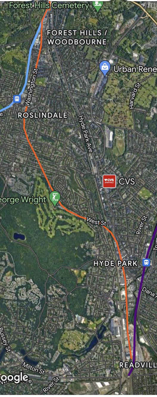

What about two southern branches to the OL. One on the Needham Branch and another that veers off to Readville. They could split before Roslindale Village there’s enough room for a flyunder there (maybe). The Readville Branch could roughly follow Poplar St. cutting across under Metropolitan Ave and serving the golf course (wealthy golfers would like that) and then under Hyde Park Ave or something.
What about two southern branches to the OL. One on the Needham Branch and another that veers off to Readville. They could split before Roslindale Village there’s enough room for a flyunder there (maybe). The Readville Branch could roughly follow Poplar St. cutting across under Metropolitan Ave and serving the golf course (wealthy golfers would like that) and then under Hyde Park Ave or something.View attachment 32034
The only place the lines would split is Forest Hills, because of the Northeast Corridor serving up a surface ROW to avoid the heinous cost of that much tunneling. And the NEC doesn't have space, because Amtrak has claimed all 4 track berths from FH to Readville as necessary for future frequency expansion. If you're going to tunnel anywhere, it's under the NEC...and I doubt the costs are worth it for that when 15-minute service on the Fairmount Line serves Readville and Hyde Park plenty well.
