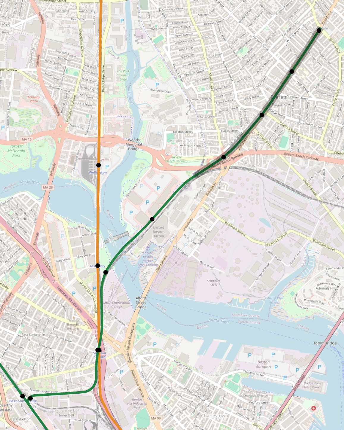

I don't think it's possible to make that curve. Not only do the platforms at Assembly go further north, ending around Foley St, but there is also the Earhart Dam to contend with, plus the need to get 30-ish feet of height clearance over the river necessitates some pretty steep gradients. That part is probably doable but it's certainly not making it any easier. All three of those factors combined make me think it's not possible for an Everett Diversion to also serve Assembly and avoid demolishing part of the Gateway Center.
The dashed line is meant to indicate that the alignment is not precise. The gradient aspect is one I hadn't thought about, though, as you say, it's probably doable. I don't see why Gateway Center would need to be partially demolished though.

I was also influenced by this:
These are prospective "nodes" for Everett and Malden rapid transit services. The lighter colored circles are potential locations of stations if a route gets built along that corridor, but they themselves are not necessarily the "target" nodes for an alignment. What's notable to me is that both "Parkway" and "Square" can be served with an "Everett Diversion" style approach (at least in terms of raw deviation distance):
Which brings us to a bigger question: more than where should an Orange Line extension to Everett go, the big question is where should the stations be?
This isn't a trivial question. From "Parkway" to "Glendale" is just over 1 mile. At Red Line stop spacing, that would point to stations just at "Parkway" or "Square" and then at "Glendale", running express through most of the denser half of the city. And is "Glendale" itself a strong enough draw for a station/node for that?
And on the other hand, Orange Line Southwest Corridor stop spacing is about 0.5 miles, which is where we'd see separate "Parkway" and "Square" stations along with an infill somewhere along Broadway. This calls to mind the distinction we were drawing in the GLR thread between the "Lechmere Model" (emphasizing transfer nodes) and the "Medford Model" (de-emphasizing transfer nodes and instead just focusing on serving the community directly).
Big picture, the question I'm trying to get at is whether there needs to be an "Everett Line" (or "Branch") or if an "Everett Diversion" would be sufficient. And the Diversion approach doesn't need to be thrifty! For example, a modest subway through downtown:
Or, like above, a more curve-intensive option that maintains service to all current stations (potentially with a relocated Wellington platform):
The ultimate question here is whether an Everett rapid transit service needs to have stations northeast of Everett Square. And maybe it does! I'm not trying to argue against that. But I do think that's what all this hinges on. If further stations past Everett Square are needed, then:

Soooooo am I suggesting that it's a forced choice between "Everett <> Downtown 1SR" vs "rapid transit stations in northeastern Everett"? Not necessarily; anything is possible. But when you look at the system overall, the paths of least resistance seem to point to those objectives being hard to achieve in tandem.
The best compromise I can see, as mentioned above, would be a Green Line branch into an Everett subway:
But... (insert comments here about frequencies, vehicle capacities, throughput capabilities, relative construction costs, and the fact that either way you're building about ~1.25 miles of subway so which one is gonna give you the most bang for buck, etc etc)
I personally think that's the best transit option for Everett, but the tunneled section would most likely be prohibitively expensive.
An all-surface alignment like this is more realistic, but it doesn't directly serve the densest part of Everett, north of Route 16.
