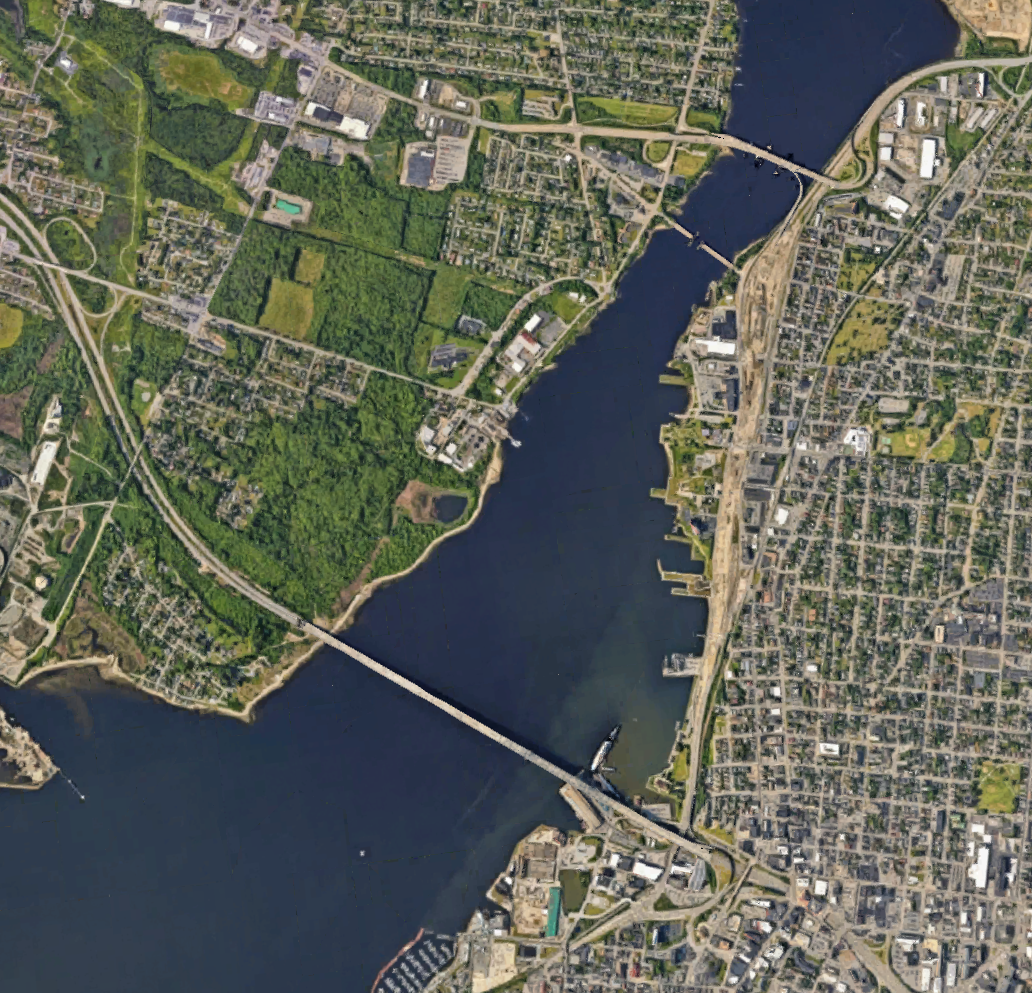

FWIW, you might consider using the old crossing a bit further north:
[see screenshot in previous post]
It's (a lot) shorter of a water crossing, and I think wouldn't need to be as high (or could just use the drawbridge, perhaps). It would also let you capture whatever TOD goes in around Fall River Depot, and maybe provide a little bit more service to the neighborhoods along there (e.g. an interurban infill at Maple St or something).
Maybe, it would definitely save on the costs of a new bridge or tunnel. I just don't really see how you'd get there.

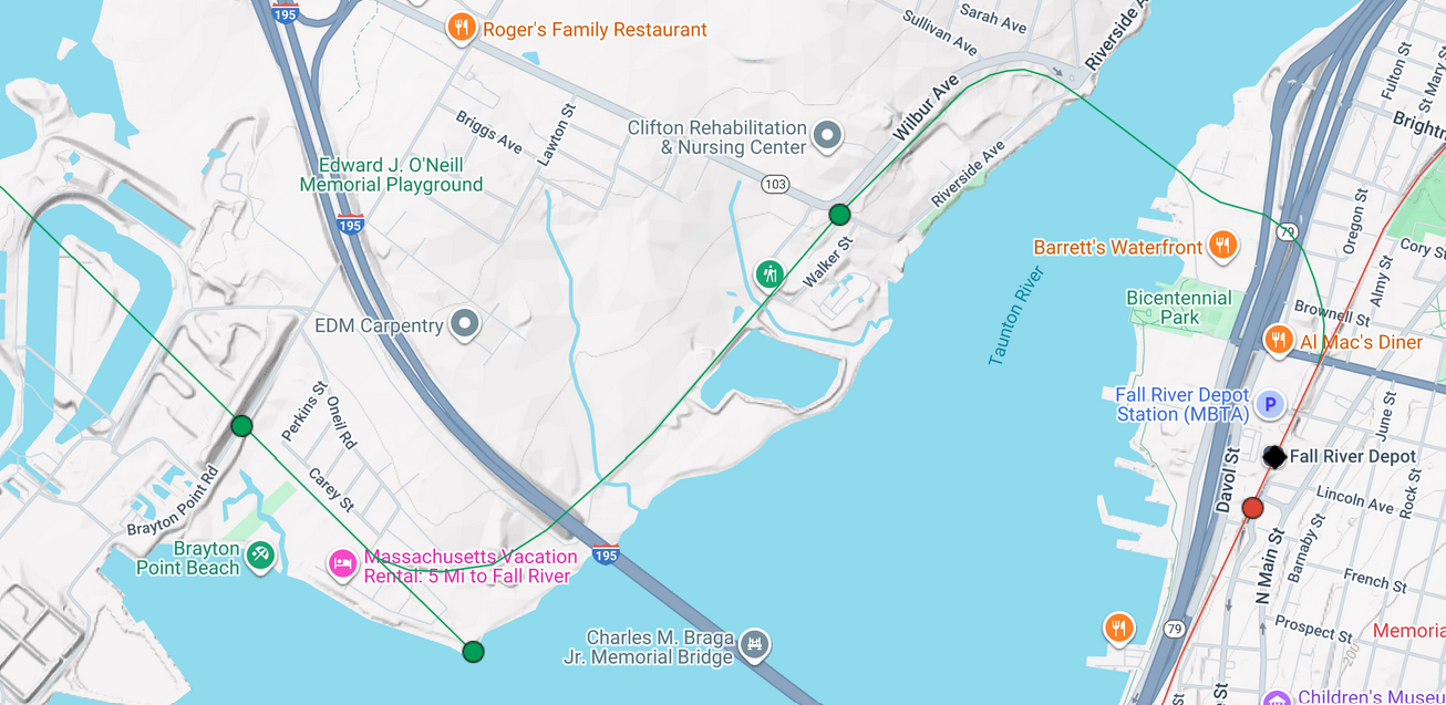

Well, so this uncovered an interesting mistake on my part. The abandoned drawbridge I was looking at is actually an old automobile bridge, which explains why there isn’t a clear ROW leading into it. The rail bridge was a bit further south; I haven’t looked super carefully, but my suspicion is that Wilbur Ave is built on or along the old ROW. (Indeed, the width of the parking lots, and the general character of the buildings, points to it being alongside.) I’m pretty sure the ROW continued through the woods along the Walker St Path, cut through the residential neighborhood south of the highway and across the power plant lot, to a crossing at Long Point.
So, there is perhaps a path from 195 to the old rail bridge, but south of the highway, it doesn’t look nearly as feasible.

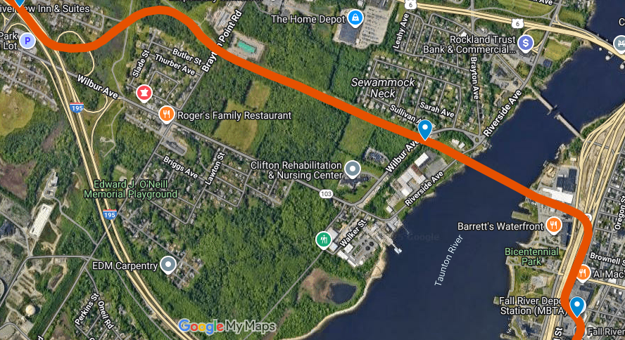

The rail bridge was the Slade's Ferry Bridge, which had rail on top and road below. Abutments are still there on both sides.
The ROW paralleled Wilbur Avenue to the east. A bit west of Riverside Avenue, there's an abandoned battery house (used to supplement the power station at peak hours) in the woods. There's also a bridge abutment at Walker Street, and remains of the pre-Slade's Ferry Bridge ferry wharf.
Definitely the best corridor for getting a rail line across the Taunton River at Fall River. It ties beautifully into the existing Fall River station, and there is plenty of wooded area west of the river to route a rail line. The question is how to continue eastward across Fall River from the existing commuter rail station. I would go for a deep bore tunnel under downtown.
That Old Slade's Ferry Bridge corridor would make the best location, IMO, for a Providence/Fall River/New Bedford interurban line crossing of the Taunton River. The river is relatively narrow there, and the crossing is near the existing Fall River commuter rail station. Here's the route I would use, utilizing the wide I-195 median to the west. Stations are shown by the blue markers.

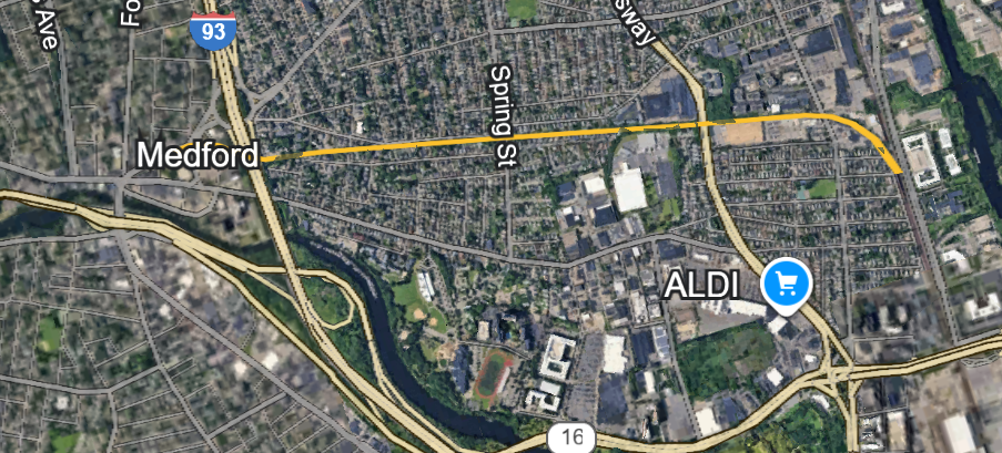

Always wondered how a branch of the orange line to Medford Square would pencil out cost + ridership-wise...
Using old ROW w/ cap cut tunneling and the existing flying junction could bring costs down substantially. Only like 5-6 houses would need demo (plus a BUNCH of backyard construction).
I think a station at Spring St would have a pretty good walkshed in a relatively underserved area in eastern Medford, but unsure on what the best alignment/station placement would be for Medford Square.
This feels pretty crazy due to the invasive construction and impact on orange line scheduling, but maybe in another world it would be a realistic proposal.
This extension has been proposed as far back as 1945 and detailed in this 1947 report which included a description and cost estimate: https://archive.org/details/reportofmetropol00mass
If you go to page 39-41 you’ll find the description. The intent was for it to remain as a freight route at night only with gauntlet tracks at stations and electric rapid transit (orange line) during the day. Of course, this was an active freight line at the time so the costs today would be substantially greater than initially estimated ($1.45M if 1945, ~$26M today adjusted for inflation)
The original rail ROW has been so encroached and built upon, that major land takings and residential demolition would be required to build a transit line, either surface or tunnel.
