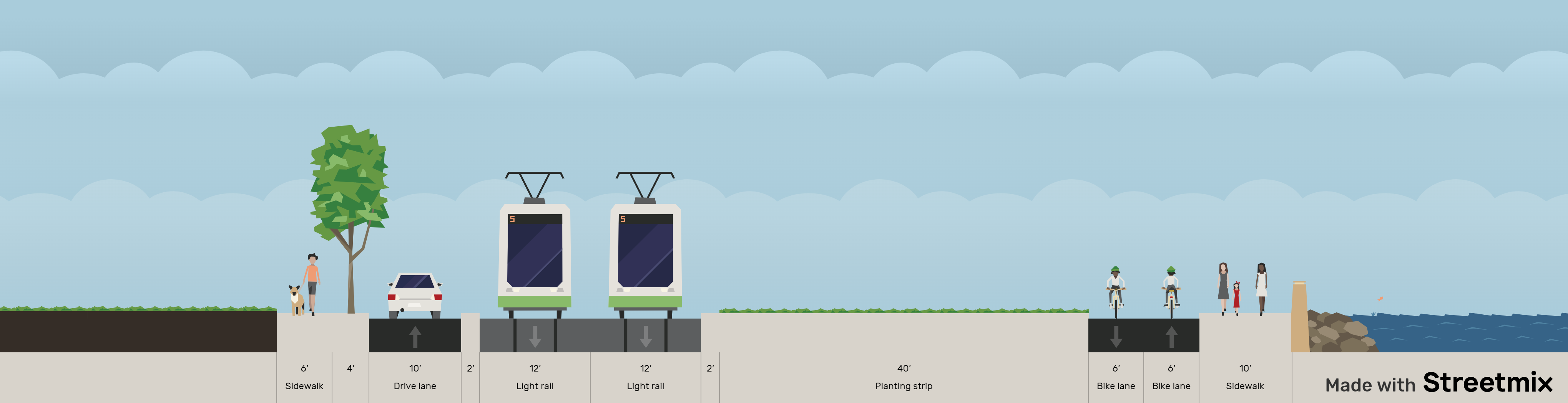

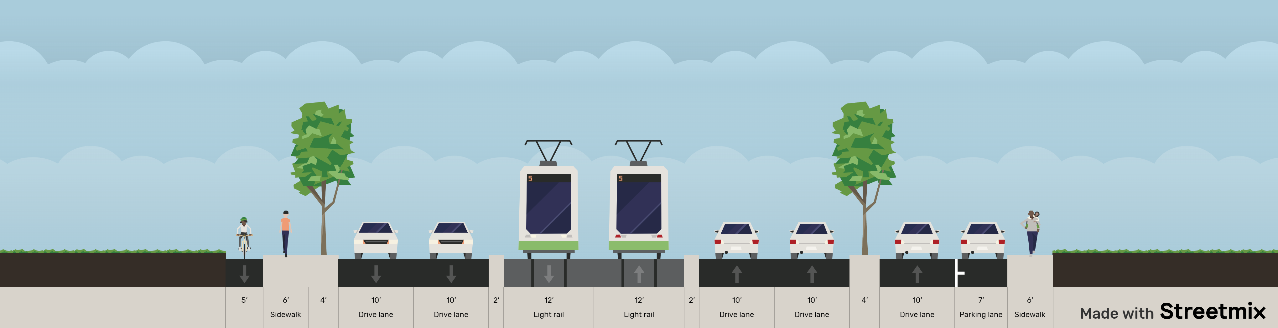

A boulevard. Not a highway. This is already how Comm Ave is in Brighton. I should clarify I was also referring to all of Soldier’s Field Rd. and Storrow as just “Storrow” for simplicity but the section I was commenting on was Soldiers Field Rd. as there isn’t room for additional development on the actual Storrow Dr. without the expense of waterfront parkland. The point of making the full expressway into a boulevard is to reconnect the city to the waterfront and reduce the horrendous noise pollution the current configuration brings. On SFR there wouldn’t need to be a local access avenue on both sides like Comm Ave but only on the Allston side as that’s where there’s room to replace some parking lots with housing. The Comm Ave single local road and tram reservation configuration can fit within 110’ with room to play with medians, buffers, sidewalk/lane width, and bike infra to fit into even less area.
That's about the same width as Soldier's Field Road from outermost tree to tree. With this configuration, all of the road infra could fit within the existing pavement of SFR with only lane marking alterations to shift traffic to the curbs and free up the median area for rail. If no rail (rail should be a priority) but just maintaining most of the existing median, it becomes a whole lot easier to narrow lanes or shift them towards the center by shrinking the median slightly and freeing up space for a local access lane. The cost would come from doing rail and what kind of buffers or the extent of buffers used for separation. Adding more intersections at places like Telford or one of the parking lot access roads in conjunction with narrowing lanes and slowing speeds will allow more and easier pedestrian access to the Charles River Waterfront. This kind of transformation of the road would make it a road used for people to access and enjoy Lower Allston rather than the polluting Pike-alternative Allston passthrough it is today.
The ultimate effect of altering SFR to not be an expressway would be a reduction of traffic at N. Harvard, Western Ave., and Arsenal due to the road not being a skip to downtown that draws in traffic which would in turn improve bus service on 3 of the highest ridership and key buses in the T and the 64. Alterations to roads
DO affect and reduce traffic when done in a way to discourage use by those who don't need to be there. Road changes can also induce transit use. If the drive along SFR to get to Cambridge is no longer faster than taking the 86, 64, or 70, then more people would be encouraged to take the bus instead. On the other hand, more people would take the bus to access the waterfront park if it was more convenient to walk to from Western Ave. than to drive to the big parking lot.
