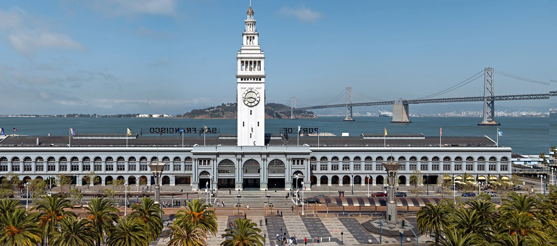

Conceptually I like your idea, but where are you going to find capacity in ANY mode of transportation to replace the 82,000 car trips per day that are happening on Storrow east of the interchange?
What are your thoughts on how this sort of thing worked out for San Francisco?
