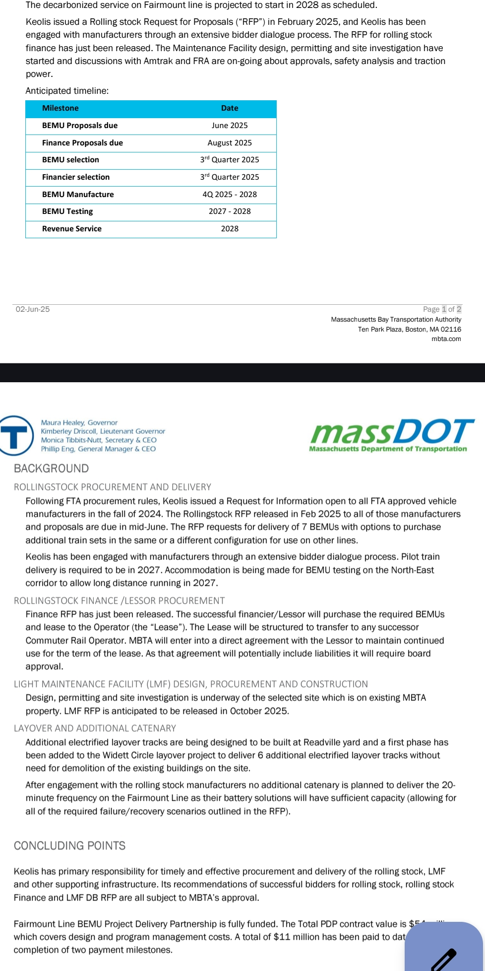

In January, Keolis, the private company that operates the MBTA's commuter rail system, announced that it had issued a "request for proposals" (RFP) for new battery-electric trains to run on the Fairmount Line by 2028.
It's a major step towards implementing the T's plan to start running trains every 20 minutes South Station and Readville using faster, cleaner electric trains, which would replace existing diesel locomotives.
