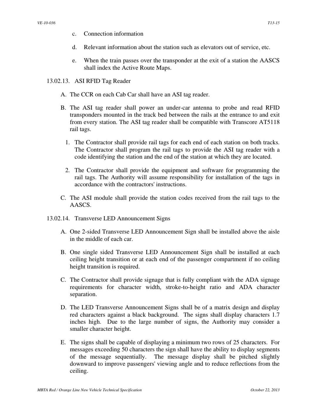

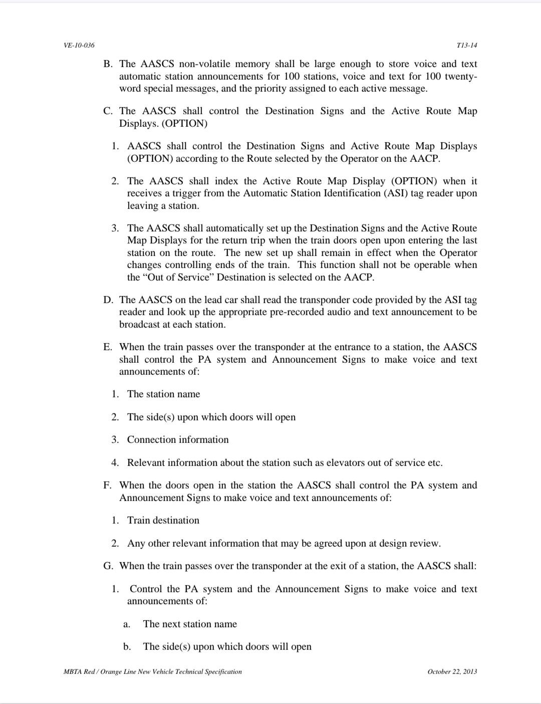

It works the same way on all 4 lines. The cars ping RFID tags placed on the ROW coded with the station ID's, because GPS doesn't work well in the tunnels. Missed signals can cause hiccups in the system requiring the operator to manually intervene on the onboard computer to reset the station sequence, and that's particularly a problem with the Red 01800's.
There is something really weird about the "unique coding" versus a "sequence of announcements". If the system really used unique coding mapped to unique messages, it would be self correcting (miss an RFID read, simple skip the announcement, and move on at the next RFID site to the correct message). Clearly the trigger is for next message in sequence, rather than for a unique message, so once a sequence step is missed, the system is fubar. Not a very robust design.
To be fair, what you describe is the intended function of the system as per the 2013 specs which the CRRC cars are supposed to adhere to. Any issues therefore on the CRRC fleet is indeed odd.
However, given that the same spec provides that the winning bidder is to provide new tags, its entirely possible that whatever encoding they've provided confuses the ca1990 electronics of the 1800s, which perhaps default to the "known station sequence".
The AASCS on the lead car shall read the transponder code provided by the ASI tag reader and look up the appropriate pre-recorded audio and text announcement to be broadcast at each station.
E. When the train passes over the transponder at the entrance to a station, the AASCS shall control the PA system and Announcement Signs to make voice and text announcements of:
1. The station name
2. The side(s) upon which doors will open
3. Connection information
4. Relevant information about the station such as elevators out of service etc.

Just speculating, but I wonder if station-sequence is used a fallback behavior. e.g., "We passed a transponder but could not read its signal, so we will assume it is our last known position + 1."
You can imagine, then, how a semi-operational reader on a train would have an off-by-N problem if it knew it was passing transponders, but couldn't read them, and also missed N transponders entirely.

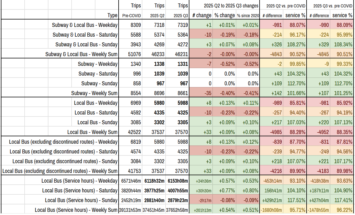

(The scheduled revenue bus service hours update for Summer 2025 I won't be able to do until late July)
Update: The scheduled revenue bus service hours for Summer 2025 was posted earlier this week. (I don't use the upcoming GTFS data, I use the historical data file with the actual data that shows what was actually delivered, hence the 6 week time lag)
Apparently scheduled revenue bus service hours increased with the Saturday schedule, despite fewer trips, while the opposite is true for Sunday. I had to check all 3 Sundays in the data file since the summer schedule started (June 15, 22, 29). However, they all come out lower than the Spring 2025 Sunday hours.
Weekday scheduled bus service hours increased by 0.5%, but the number of trips is only up 0.1%.
