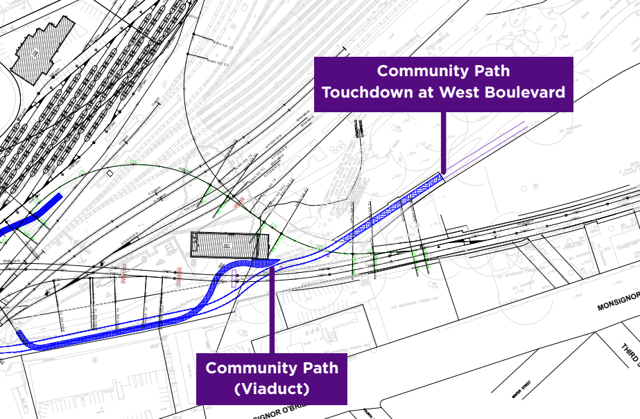

Sorry if I’ve asked this before…but where/how is the Community Path connecting between East Somerville stop and right as it approaches Lechmere? Does it go underneath the tracks :
Or does it go behind the apartment building (where there’s already a temporary path, and is somewhat awkwardly close to private patios)? Here:
It ducks under the GLX viaduct and connects to Morgan Avenue. It looks like there will be an off-street path on the northeast side of Morgan - it's already in place south of First Street - which connects to the North Point Park trails at Education Street.

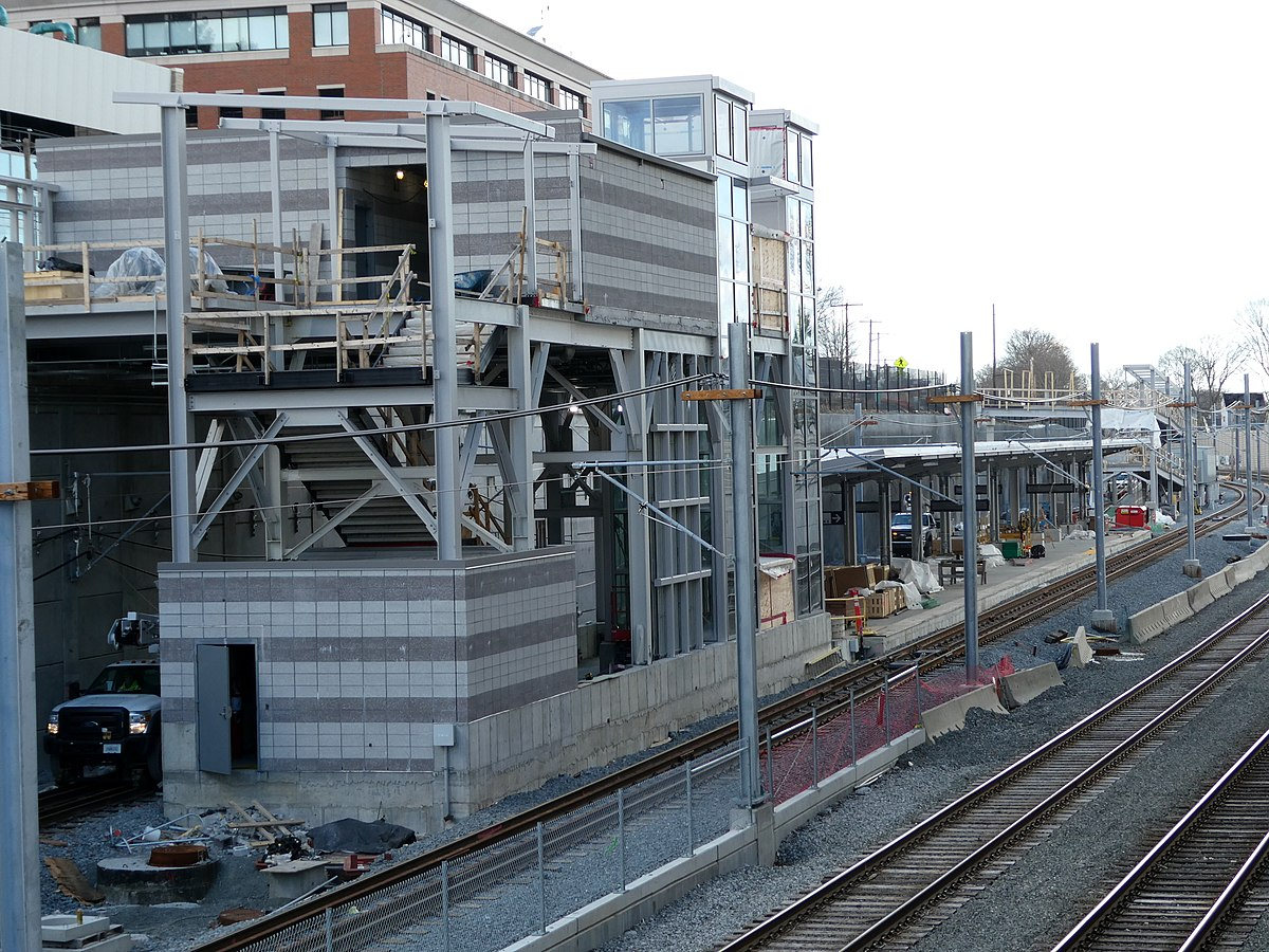

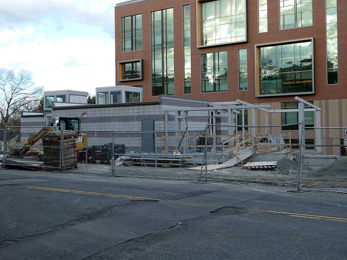

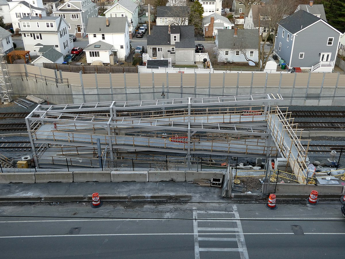

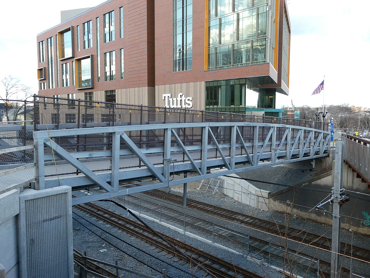

The footbridge at Medford/Tufts is open. Unfortunately, it was starting to get cloudy, so I wasn't able to take full advantage of the good angle.
I really hope these bare cinderblock walls get painted someday - even plain green would be great for branding.

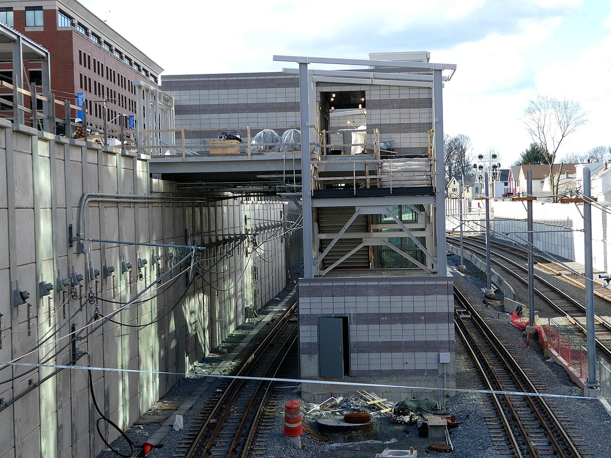

The emergency exit at Medford/Tufts is a good reminder why long ramps alone are no substitute for elevators. It has about 400 feet of ramps for 20-25 feet of vertical - a significant difference in time and energy versus a 10-second elevator ride - and probably cost just as much as an elevator. (Obviously the ramp is necessary as an emergency exit that doesn't require electricity, but it would be vastly inferior as the main entrance.)

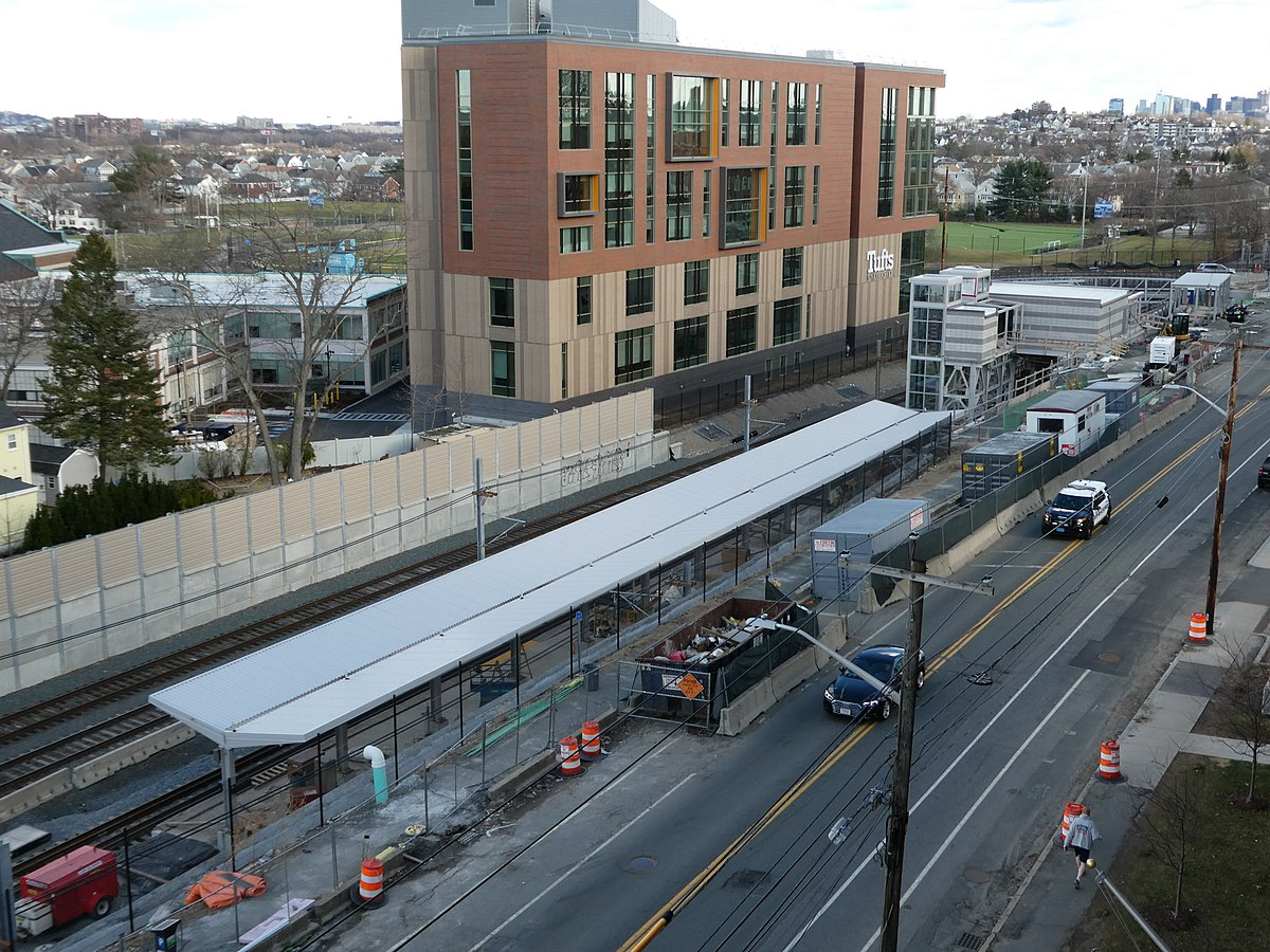

One of these days Tufts is going to yell at me for photographing from their parking garage, but for now it's a great angle even with crappy light.
And that's that for my March 2022 GLX photos. (Save for the politicians at the opening, but those aren't very interesting shots.)
What are the laws around accessible emergency evacuation points? It’s obviously not a requirement for buildings. Is it required for transit stations? Is the T going above and beyond here, or just covering for themselves if both elevators break on the same day?
As far as I'm aware, not strictly. Last I saw College Ave and Magoun were supposed to have "areas of refuge" or glorified cages some distance from the station itself as an emergency exit egress location.
When did they add this ramp structure to the plan anyways? The last station plan I saw had the aforementioned safe refuge area.

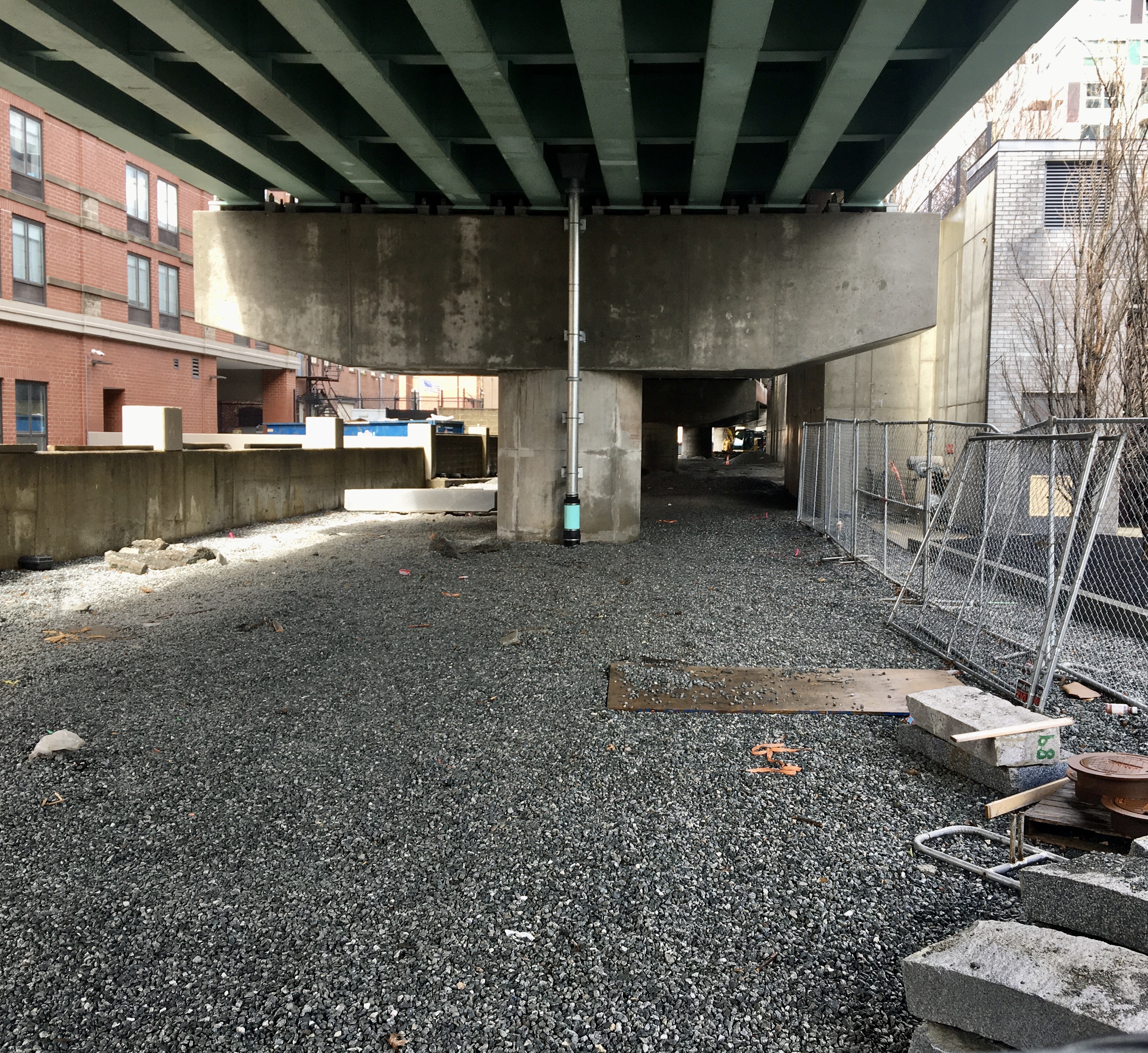

I'd be terribly afraid to walk under here during the day, much less at night! Very little lighting there now, none at night!! They need to get some lights under there if that is to be a walkway!!! Look how dark it is there!! :eek:
I'd be terribly afraid to walk under here during the day, much less at night! Very little lighting there now, none at night!! They need to get some lights under there if that is to be a walkway!!! Look how dark it is there!! :eek: View attachment 23259
I don't think the path will be following along the underside of the GLX viaduct. It will quickly cross it and end up connecting to Morgan Ave, according to this earlier post:
Thank God!! Of course, I'll be on the trolley anyway, so that dark & dismal area will pass right by me!! :eek:

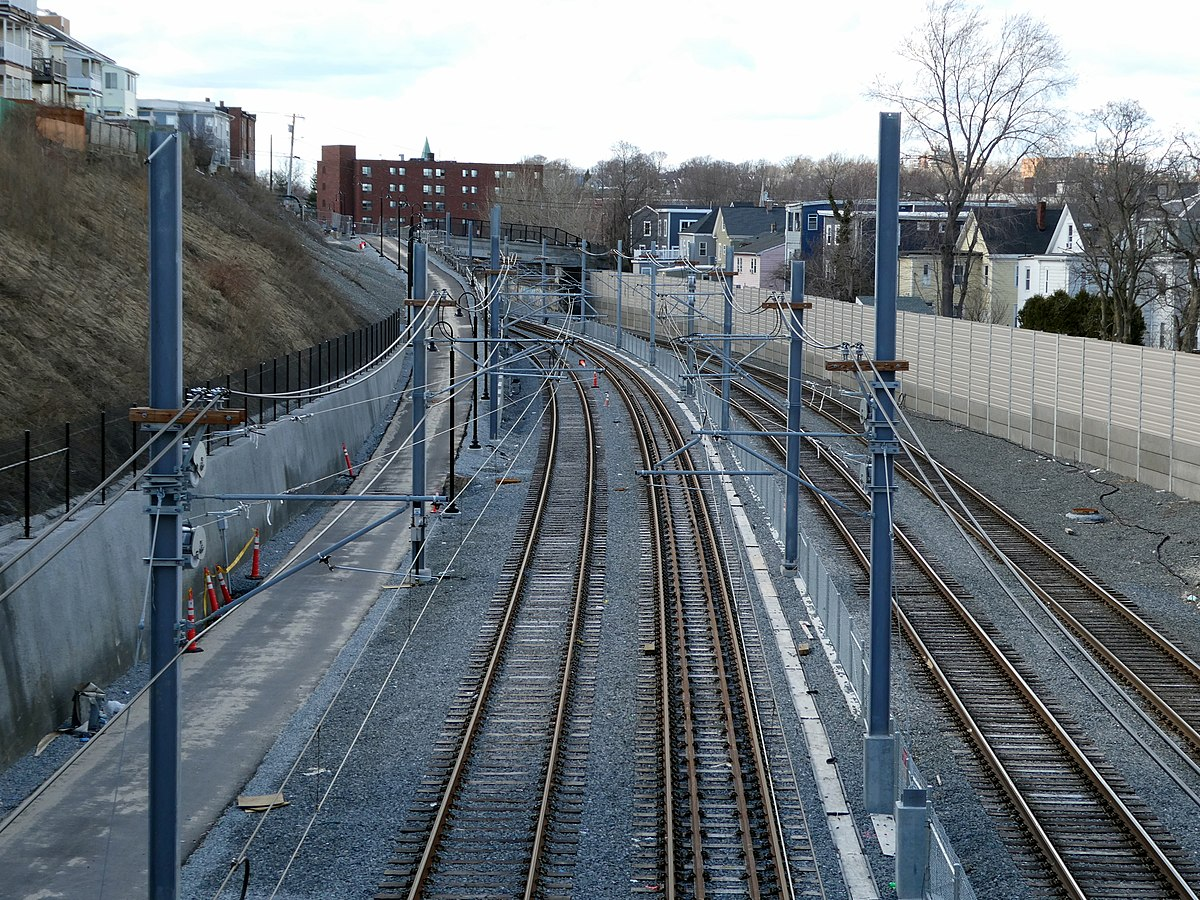

Those support poles look so height-inconsistent. I realize some of it maybe camera distortion but some, like these in the second picture below, look unnecessarily high.View attachment 23289
It's not camera distortion. The height of these poles vary wildly, and I always thought it looked weird (if not sloppy), but I always figured they knew what they were doing and had a reason for it. Anticipating settling into the ground? Waiting until the end to lop off the tops to make them even? I am very curious to hear the reasoning behind this.
If differential settlement is expected to be over a foot, we have wayyy bigger problems than sloppy looking poles :).
Since l dont see baseplates, l would put money on all the piles being the same length, but with varying depths below grade. If they’re driven, makes sense to hit refusal at slightly different depths. If they’re drilled shafts, the expectation would be more or less equal depths, but not unheard of for some weird subsurface conditions to change that.
Either way, a little bizarre the tops weren’t cut off given steel prices right now. Maybe priority number 1 was to get the thing open?
Any chance some are light poles or maybe the tall poles are for the eventual electrification of the commuter rail?
