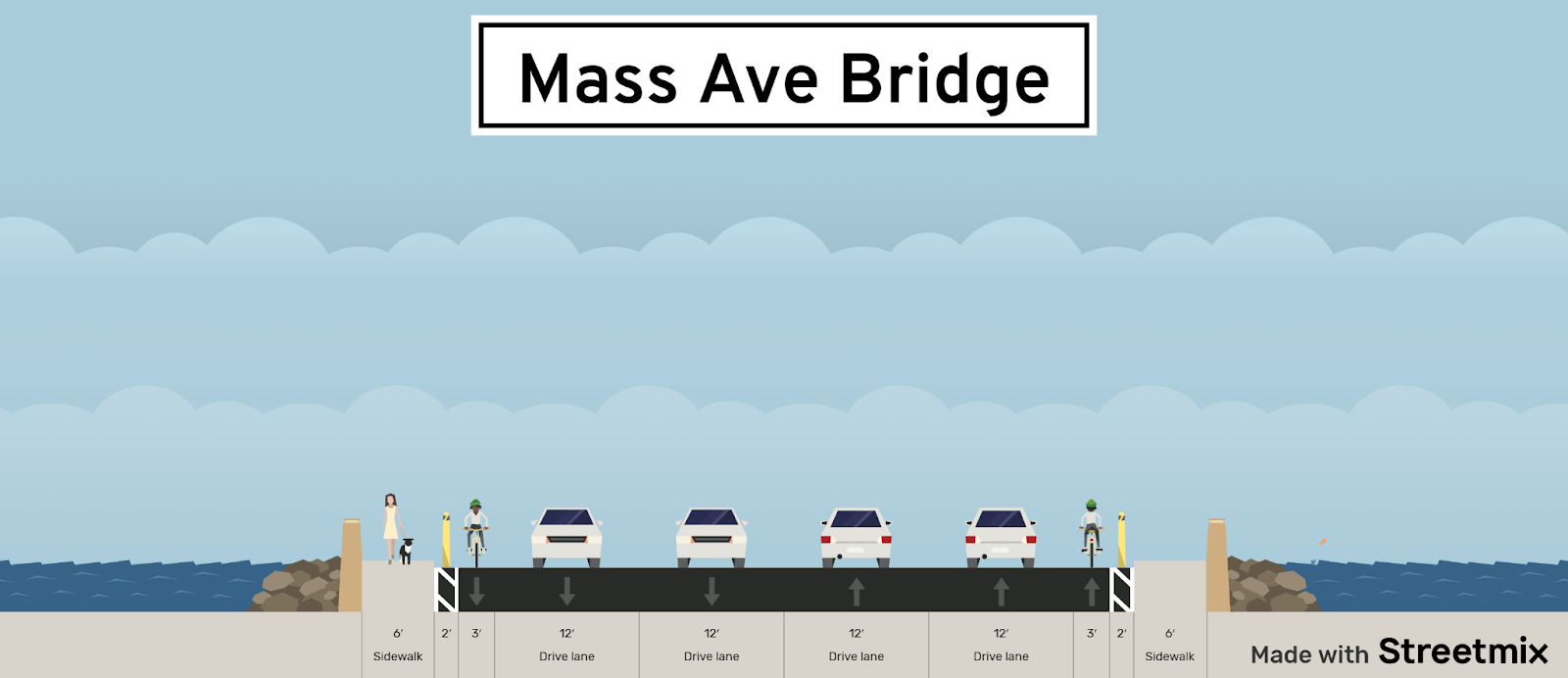

2) Claim two lanes on Mass Ave for BRT and LRT (which should be done for the 1 bus already anyway). Include a stop directly at MIT’s main campus
3) Cross the river using two lanes of the Mass Ave Bridge

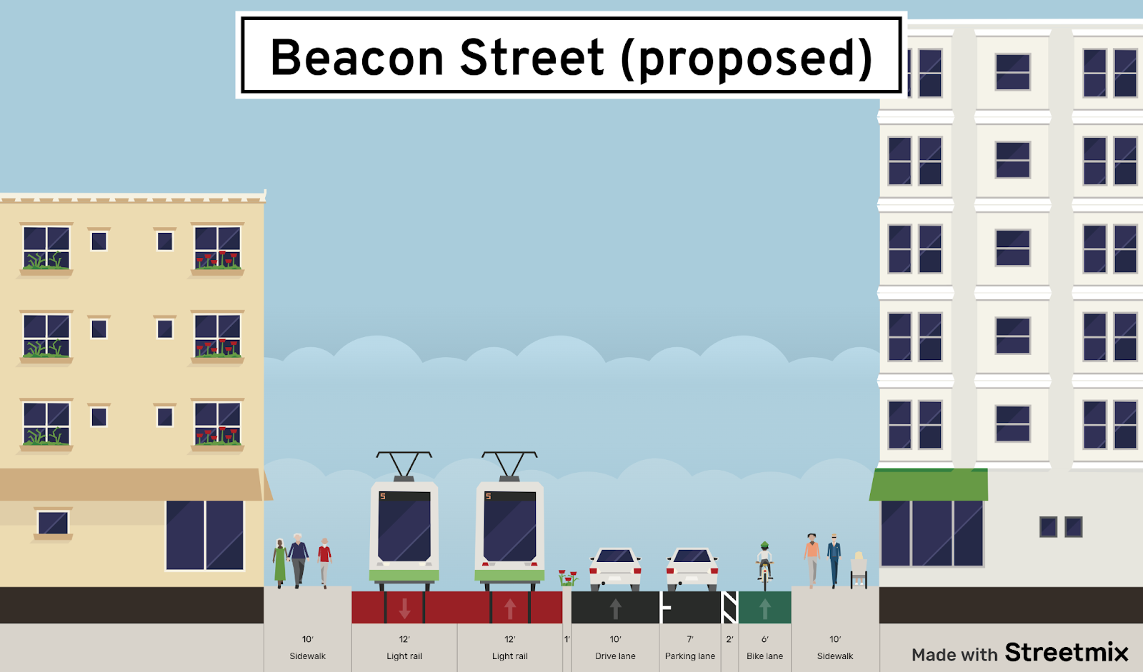

4) Turn west at the intersection of Mass and Beacon. Reimagine Beacon Street with two lanes for LRT tracks (and optionally BRT), one travel lane, one parking lane, and a one-way bike lane. This will require the taking of one travel lane and one parking lane along the 0.3 mile stretch.
Cenk8lAzuTbUr6ITGfzETBI7ljSWplV1xHb-TedY5n3a8zck1Uqe6qbXSJcFA_hVW9KOSwbLUJwdaYgaN4i3ETO3CxXYjoJRidw0oDNCxKjx4_1XVDmgN_T_tNBA1O5brwGYid6c
CRDNIRJXeaij31VUsAWxnHeatfI1fguqqOW5we4SW0gtOd0hQbwb9EQMYd6PIk9e18lZJ01XAWWR3aNZpOpFcNvpsWHcFUSFd_e2rnTmGox__032G9Ue5rRQr3rqzOyr0xS7V3qs

1) Mass Ave is tight on the bridge.
  1. There are four travel lanes, two shoulders doubling as bike lanes, and then two relatively wide sidewalks. I’m not sure it’s quite feasible to just paint two of the lanes red and lay down tracks – the lanes still might be a bit too narrow to keep up good speeds for either automobiles or transit.
  2. Yes, there would need to be a traffic study to understand the impacts of reducing auto traffic lanes by half on the only river crossing for a mile in either direction. Perhaps these reductions could be off-set by making the transit lanes more like HOV lanes – allowing private buses, cars with 3+ riders, delivery trucks…?
  3. If the sidewalks could be narrowed, even only slightly, that would provide well-needed wiggle room. For reasons I’ll describe below, my recommendation would be to split the lanes up by mode, not travel direction – meaning that one sidewalk could potentially be separated from auto traffic by two bike lanes, which might make the narrowing a little more palatable
  4. (Parenthetically – those shoulders-as-bike-lanes look absolutely absurdly narrow.)
2) Beacon St is tight.
  1. This would be a significant redesign of the street, so it would be important to work with the community to make sure concerns are addressed
  2. This neighborhood has slightly more limited east-west thoroughfares, so reducing Beacon St would redirect some westbound traffic down to Commonwealth, which itself is already only one travel lane heading west
  3. I believe the overpass through Charlesgate itself doesn’t have parking lanes, so for the true chokepoint there could potentially be two travel lanes
  4. A surface stop could potentially be added on Beacon St at the Mass Ave intersection, which could mollify residents somewhat; the downside is that it would require eliminating both parking lanes along that stretch

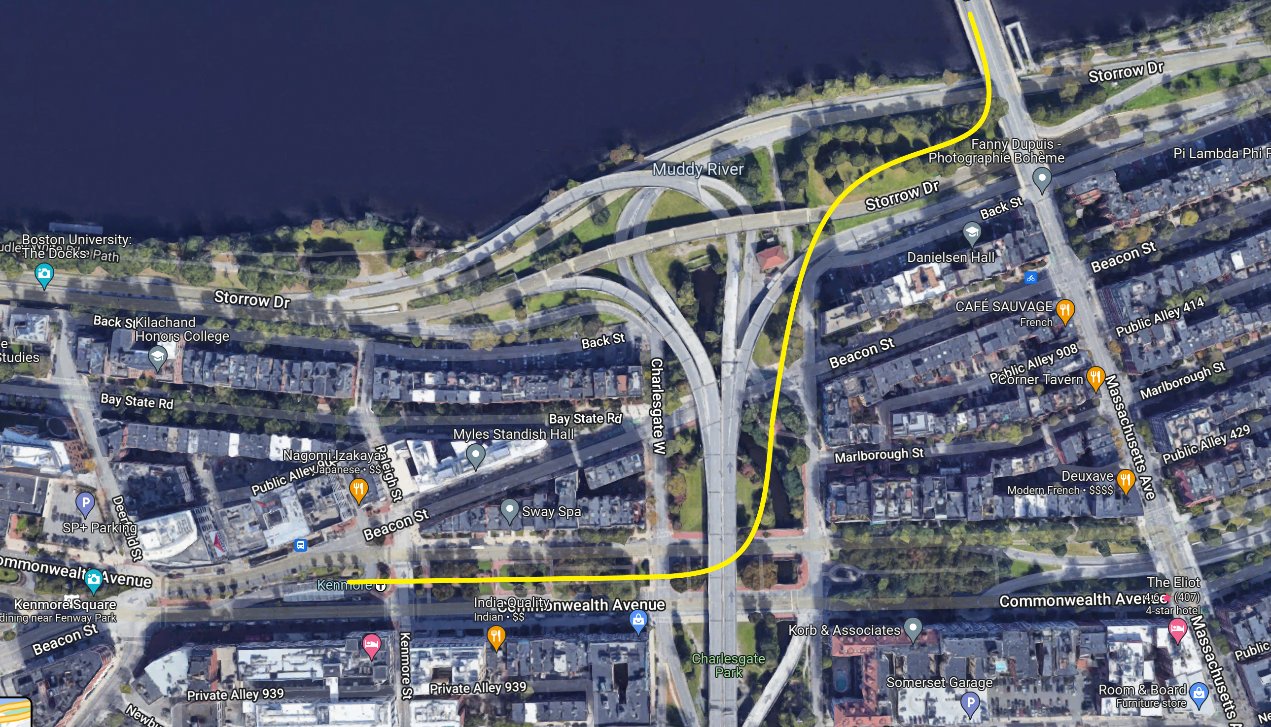

3) The curve from Mass to Beacon is very tight
  1. This is actually my biggest concern
  2. I don’t want to introduce a smaller “ruling curve” into the LRT network than the 50-foot Brattle Loop (which I believe will remain in place for the foreseeable future), and from my rough measurements on Google Maps, a 50-foot radius might be possible, if the widest possible alignment through the intersection is used
  3. This is why I want to segregate the lanes on the bridge by mode rather than direction: I want both tracks to be on the far northeastern edge of the intersection, taking a broad curve into Beacon St, and running along the southern half of Beacon. Using center-running or opposite-side-running tracks on Mass will require even tighter turns
  4. In this mock-up here, the inner track is intended to have a 55-foot radius, which does look doable, albeit tight. Adding a platform on Beacon (only room for a center platform) does complicate things a bit – you want to have the platform as close to the intersection as possible so as to enable transfers to the 1 bus and to a future Blue Line station at Storrow & Mass. It looks like a 50-foot inner track could “land” on Beacon St pretty close to “on target” for placement alongside a center track – but it’s a close call
Not sure if you were already aware of this, but Mass Ave Bridge (Harvard Bridge) was reconfigured last November and reduced to two lanes (one in each direction) in order to widen both bike lanes widened. This was implemented with (temporary?) traffic cones placed in the middle of what were originally the outer travel lanes, so not sure if it will be permanent. But it does show that:
- Reducing travel lanes on Mass Ave Bridge is doable, but
- Any further reconfiguration likely needs to ensure that bike lanes are wide enough.
What you proposed seems good to me if it's feasible, but that I'm not too sure.

Was the "boomerang" about modding Kenmore to allow a B-C or B-D connection?
(but man would I not want to live in those buildings around that intersection, that curve would be loud...though hopefully not as loud as the actual Brattle Loop...and with fewer sparks...)
Oof. Yeah. That was an aspect I hadn't fully considered, and I think it renders the whole topic moot if indeed there is no way to minimize/eliminate squeal. That issue kills this entire proposal dead -- that intersection is extremely residential. The Track Design Handbook for Light Rail Transit, Second Edition has a section on curving noise, including various remedies. Perhaps an automated lubrication system could keep the noise to a manageable level? But I'm not optimistic.

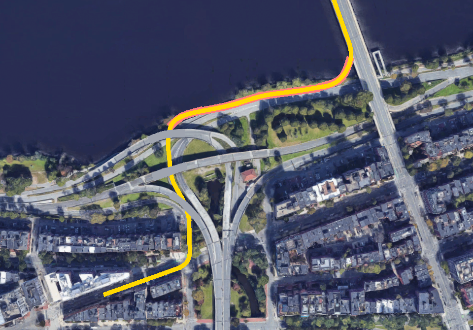

One potential alternative crossed my mind, although it is highly contingent... In a world where Storrow has been put on a diet, it's possible that the spaghetti of interchanges at Charlesgate will be simplified. If that does come to pass, then there might be opportunity to insert a new LRT ROW somewhere in there. Vague sketch:
Here I've drawn it on the western edge of the (former) interchange's footprint, although it may be preferable to utilize an alignment that is closer to the center of the footprint and further away from homes (e.g. the Beacon-to-Storrow-westbound onramp). But this would be completely dependent on whatever the heck is done with Storrow and Charlesgate. If it's all gonna get blown up, then perhaps there is opportunity.
And the only other wild-ass idea I can think of would be to somehow interface with a Blue Line tunnel as it crosses Charlesgate... relocating the curve underground at least?
[EDIT: perhaps that lot between EB and WB Storrow just west of Mass Ave could be useful? On the satellite it look like park, but I believe it doesn't actually have any pedestrian access. Could be for a portal that connects to an expanded Blue Line tunnel? Or maybe could thread an LRT ROW through the existing spaghetti to Beacon?]
Alas.
I did not know about this! That is very encouraging. But yes -- not sure if it's clear in my Streetmix diagrams, but my proposed reconfig of the bridge calls for full width bike lanes in each direction (with physical separation from automobile traffic).
And -- I should call out -- even if we don't put LRT tracks on the Mass Ave Bridge, there should still be bus lanes.
Even if the interchange isn't going away, is it possible to build a viaduct over or near the interchange? A rough sketch:
Start the incline past Kenmore St right after the surface Kenmore station (take the median), and rise to "level 3" (a level above Charlesgate) before reaching Charlesgate W. Decline when reaching the lot between EB and WB of Storrow Dr, before joining Mass Ave at street level.
I haven't checked the curve radius and gradients yet, but doesn't seem to be an issue? This is obviously more expensive than street-running approaches, but with considerably more grade separation.
You can even build an elevated station at Kenmore if you hate street running as much as I do. Even more costly, and I'm not sure if there's space near the B/C/D portals for an incline, but this eliminates any concerns about road traffic especially during the games, and allows better integration with the bus terminal.
(Note: I think any approach using Charlesgate - even the one you originally proposed - can benefit from using Commonwealth rather than the narrow Beacon St.)
I was actually surprised they didn't take this opportunity to create shared bus/bike lanes for the 1 bus. Either that was an oversight, or they couldn't because the lanes wouldn't be wide enough. If it's the latter, that's a bad sign: if the bridge isn't even wide enough to allow 4 lanes (2 travel lanes, 2 bus/bike lanes), it will definitely not be wide enough for 2 travel lanes, 2 bike lanes and 2 transit lanes (LRT/bus).
